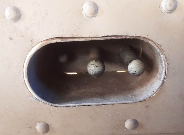

Any recommendations as to how to tie this receptacle into the schematic?
[img]cid:ii_kp2ux4b70[/img]
More specifically the polarity relay that is indicated.
