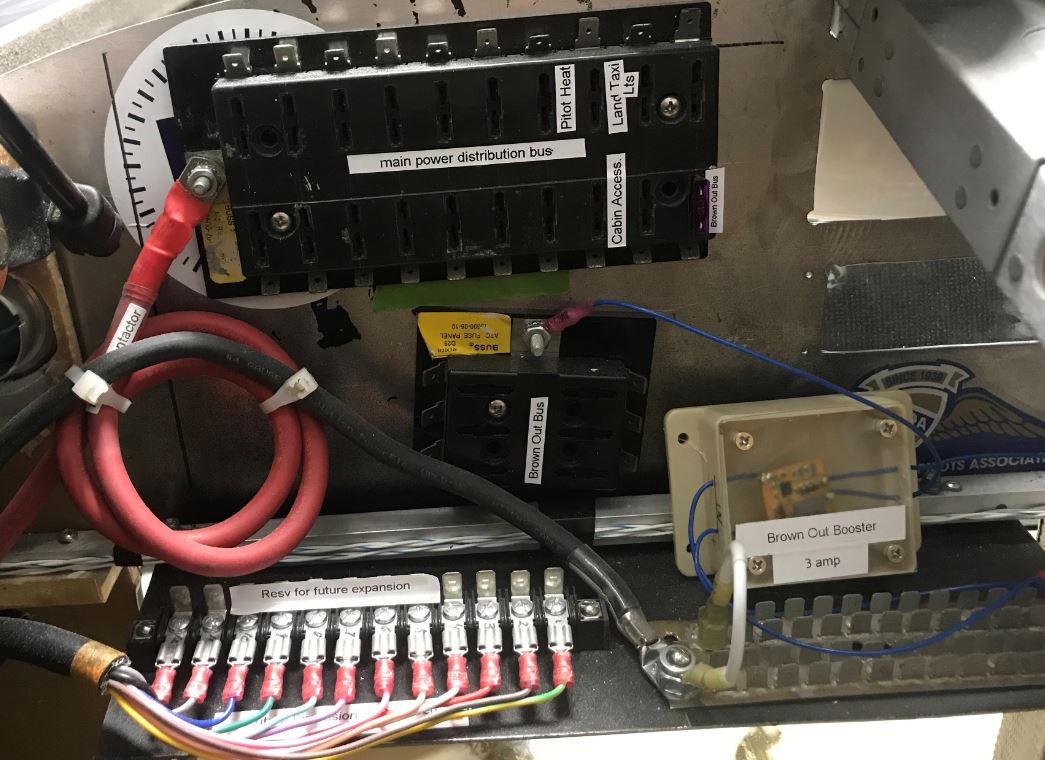

I stumbled into doing what Charlie recommends.
The instrument panel is a single piece with a 90 degree bend, the bend forming a shelf on top of the leg holes. (What's the technical term for "leg holes"?) 4 AWG comes to the back of the passenger side of the instrument panel. The ground, main distribution and a brown out buss are all there, mounted on the back of the panel or top of the leg hole shelf. I also have a 12-conductor expansion bus, currently empty but available for future use.
To get the panel out I detach the several busses and remove a dozen screws holding panel to airplane structure. It takes about 10 minutes, but it's not complex. (The passenger side of the busses is an ipad frame. If I had avionics spilling over to the passenger side I would need a larger leg hole shelf.)
