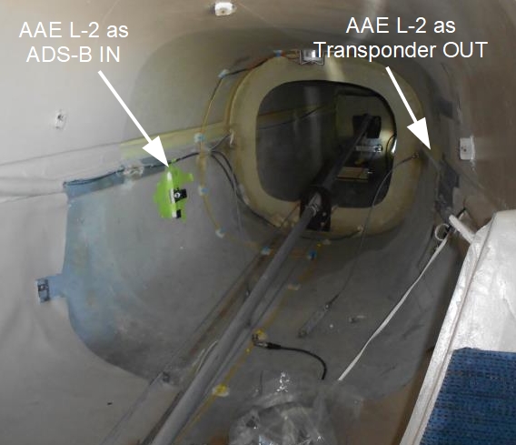

The AAE L-2 antenna is the same one I have in my KIS4 for both transponder OUT and ADS-B IN. It works extremely well in our fiberglass airplanes. The frequencies involved (1090Mhz & 978Mhz) are so close you will not notice any difference in power without using a sensitive spectrum analyser and are in a lab controlled environment.
I have attached a photo of my installation as reference.

FWIW; My ADS-B IN comes from a separate module not from my transponder, hence the two antennas.
