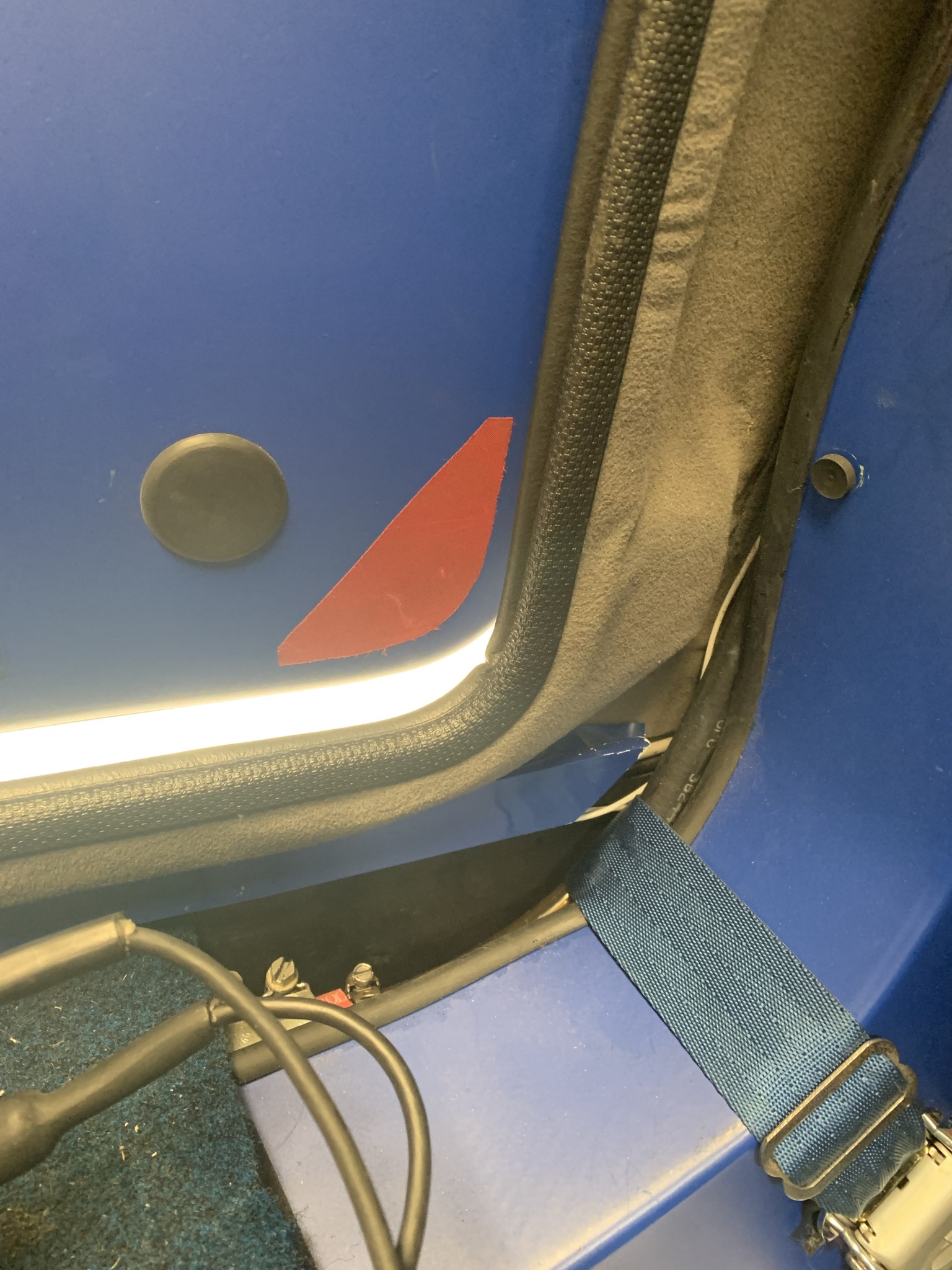

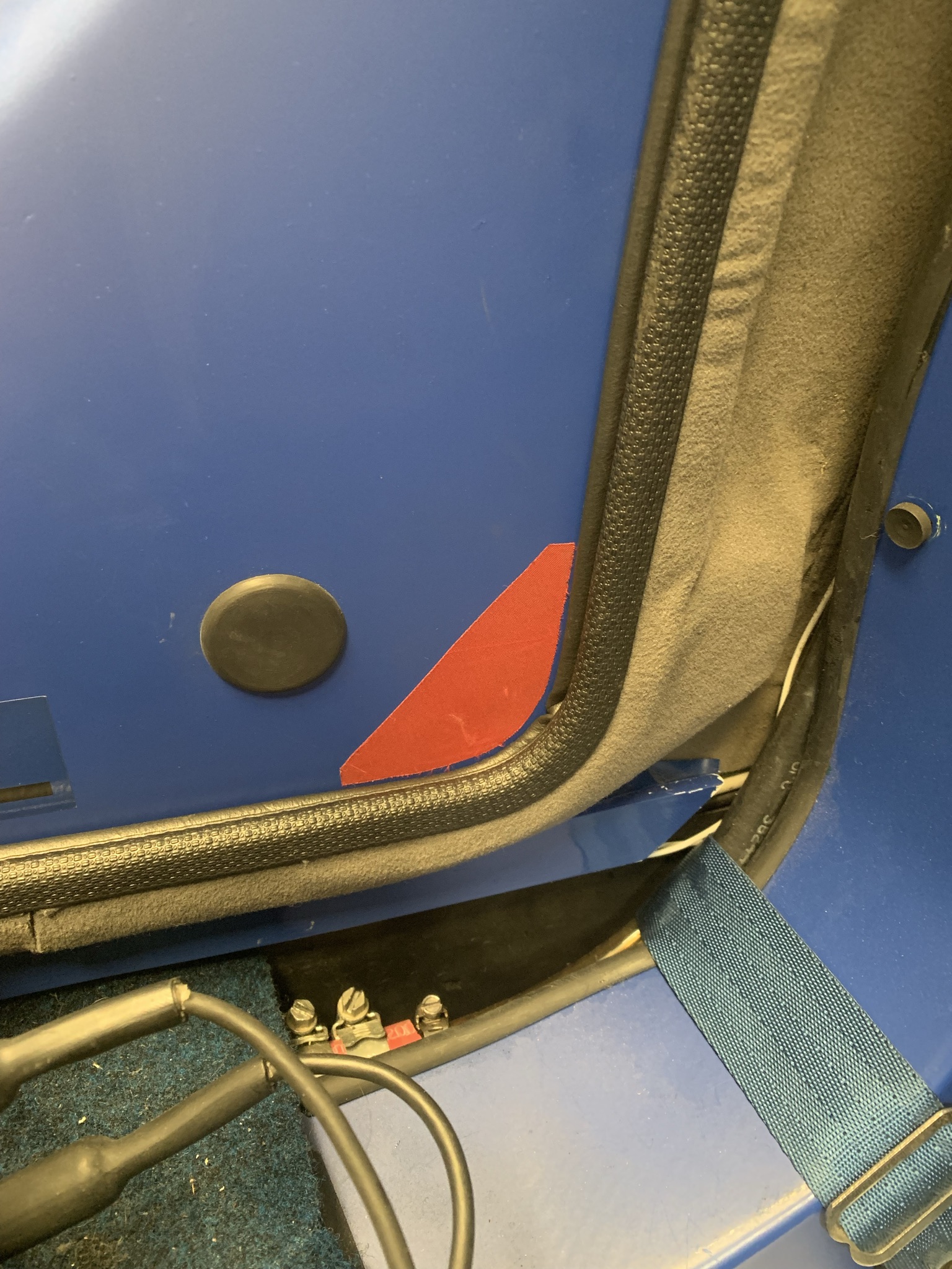

PostPosted: Fri Dec 17, 2021 12:09 pm    Post subject: Mandatory U.K. LAA permit directive. Shoot-Bolt stop Reply with quote
Agree with Duncan and John. My alternative is a visual check of the back bolt engaged with a red placard against the door rim. See photos below. Not mandatory here in NZ due to the modification not being a Europa Aircraft Company mandatory mod.
Cheers,
Tim
[img]cid:99303AC1-F8EE-4B09-B63C-C35F0B2C77BB[/img]
[img]cid:81DC70FE-2FC1-4249-9C71-683BD2179750[/img]
Sent from my iPadTim Ward
