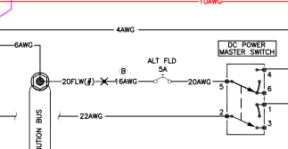

On reviewing Mudfly's Schematics, and the Z101 Rev b, I have a basic question on the implementation of fusible links for the power feed wire from the main power bus to the bus input (pin 6) on the LR-3 (via the Master Switch).
1. Z101 has 20AWG wire for this line, but the fusible link appears to be 20FLW(#) using 16AWG? Shouldn't this be a 24AWG fusible link to protect a 20AWG wire? Is this a typo or, as I am learning with Z101 and Bob's excellent work, is there a good reason for this? Am I mistaken on what fusible link nomenclature 20FLW(#)-16AWG means? Does the Breaker in-line on this wire affect the FLW selection?
2. Mudfly appears to be using 18AWG for the above wire, but the same fusible link setup. Is this correct?
3. One more question: If protection of the Alternator B line is important but for a very rare event, why bother with ANL devices that need space on a firewall, when fusible links are clearly simpler, lighter, cheaper, and most likely more reliable?

I'm not looking at either drawing at the moment, but I'd bet that #1 is
because 24AWG wire is pretty fragile, and relatively uncommon in small
a/c anyway. Not sure why Bob picked 20/16 in that spot instead of 22/18,
unless it was to keep some level of commonality with other wires already
spec'd in the system, or perhaps to minimize voltage drop which might
affect regulation stability in the regulator.

At 09:19 AM 3/6/2023, you wrote:
--> AeroElectric-List message posted by: "jcohen(at)post.com" <jcohen(at)post.com>
Yes, RevB to Z101 corrected an oversight in
depiction of the BUS EXTENSION from the main
bus feeder out to the circuit breaker dictated
by incorporation of a crowbar ov management
system.
The segment from FAT wires out to the breaker
is a distribution feature that COULD be serviced
by a 24FWL driving a 20AWG feeder. Fusible
link wire is not common available in sizes less
than 20 which dictates a feeder of 16AWG or
larger. This is a one-of-a-kind situation so
I wouldn't work too hard to get a hunk of 16AWG
for that segment. 14 or even 12 would be fine
to.
Once past the breaker, the pathway becomes
an appliance feeder with wire sizes suggested
by installation requirements for that appliance.
No, that's 20FWL fusible link wire . . .
https://tinyurl.com/2p9eyv46
spliced onto a 16AWG (or larger) extension
out to the breaker. That dot with an X thru
it is a splice.
Link selection in this case is driven by
product availability. Now, you COULD build
your own 24FWL
http://aeroelectric.com/articles/fuselink/fuselink.html
. . . acquiring he fiberglas/silicone sleeving
is probably more effort than off-the-shelf
fusible link wire.

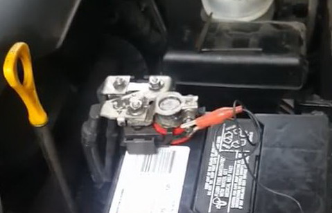

Very perceptive. But of course. The car guys have
been doing this for decades. My KIA has a cluster
of circuit protective devices right at the battery(+)
terminal. They look like mini ANL current limiters.
The wiring diagram calls the 'fusible links'.
The fact that these could not get any closer to
the battery terminal should suggest something
about battery energy hazards in a munch-up.
Back in our EMT days, one of the FIRST things
the jaws-of-life guys did on arrival at the
scene was cut the battery wires . . . assuming
they could be reached.

PostPosted: Mon Mar 06, 2023 9:19 am    Post subject: Z101 Fuseable link question Reply with quote
I'm not looking at either drawing at the moment, but I'd bet that #1 is because 24AWG wire is pretty fragile, and relatively uncommon in small a/c anyway. Not sure why Bob picked 20/16 in that spot instead of 22/18, unless it was to keep some level of commonality with other wires already spec'd in the system, or perhaps to minimize voltage drop which might affect regulation stability in the regulator.
20AWG linkwire is the the smallest off-the-shelf
product I've located thus far. If anyone spots
something smaller, please give the List a
heads-up.
But it's not a really pressing issue. The 20/16
FAT wire extension satisfies crash safety design
goals . . . the fact that it's a bit 'big' for
a 5A feeder is no big deal. If that were a 2 AMP
breaker protecting some device on the airframe,
the 20/16 extension would still be just fine.

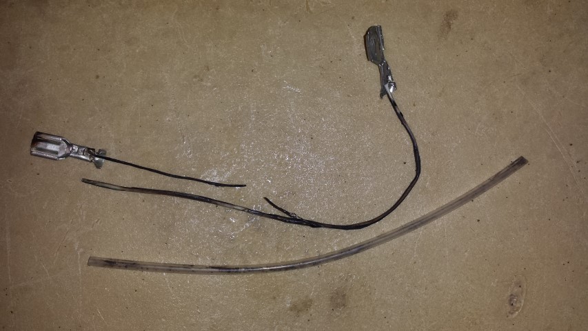

I tried out a 'catastrophic fault test' on some 22AWG milspec wire inside a short piece of silicone tubing, and the wire was vaporized but the silicone tubing completely contained the event. (It did let the wisp of smoke out, of course.)
Wire is going to be on hand, and silicone tubing could probably be sourced locally, or certainly from the usual online suspects. A few dollars and you'd have enough to makesmall gauge link shields for the rest of your flying career. Wink
Charlie

PostPosted: Wed Mar 08, 2023 4:04 pm    Post subject: Z101 Fuseable link question Reply with quote
Charlie
Good show. Got any pictures? I can
append the experiment and your results
on the DIY fusible link comic book.
(o o)
Charlie
Just the post-test, disassembled  one I attached to the message, and one showing the test link, pre and post test. I'm sending all three direct to your email address. The tubing was ordered from probably either Amazon or ebay. As I said, it's *not* clear vinyl; it's silicone. I'd be a little less confident in vinyl. Wink
Charlie

PostPosted: Thu Mar 09, 2023 6:58 am    Post subject: Re: Z101 Fuseable link question Reply with quote
Charlie, great thanks for performing that test! Really helpful for me to understand what to expect.
Jeff
