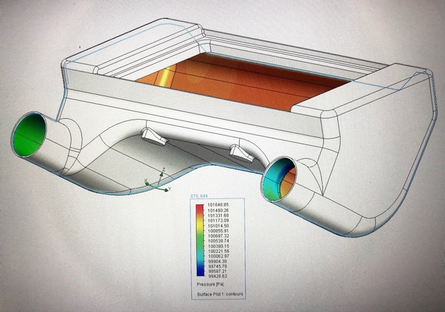

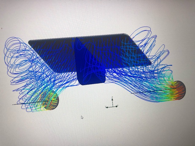

The plenum box has been extracted and Cad'd up to analyse its flow and acoustic aspects; its basically currently acting as a fantastic resonator boosting induction noise straight through the firewall.
Today has been spent looking at Mass Flow and Dynamic Pressure through the assembly at 6000rpm WOT.
The target objective will be implementing passive noise attenuation features to mitigate carburettor induction noise ingress to the cockpit.

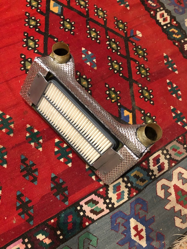

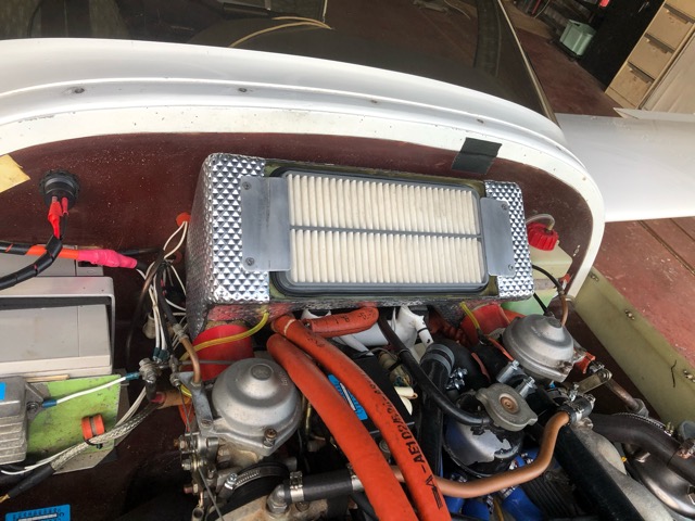

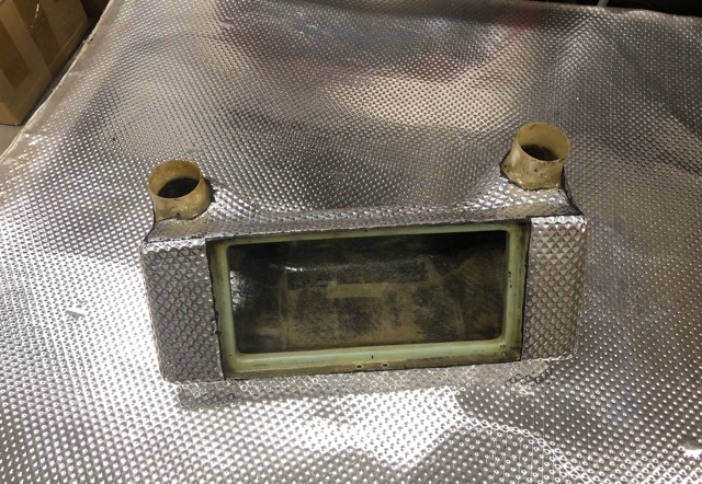

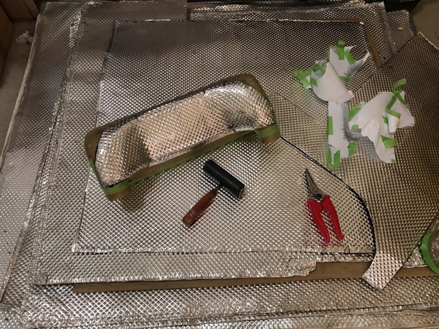

Stage one of "shut that noise up" completed.
Applied a dense OEM sound absorbing material made by Diver Consolidated Industries; also acts as a secondary low temp heat shield... Not for the novice. It uses a magic 3M adhesive back. You get one chance sticking it down, and it cannot be removed to reposition... then give it a good going over with a roller; done... has added 1kg up from 560g to the plenum.
The only way carbi noise is getting out of there now is through the air filter.
Will try it out tomorrow and listen if Stage 2 baffles are still required.

Stage One of "shut that noise up" has been a flying success!!!
Worth every one of the 1000g weight penalty; couldn't recommend it more.
The mod has worked so well that noise canceling is no longer required.. in fact, its worse now flying with noise canceling than without... at WOT engine noise has gone from high pitched screaming hell to a dull drone... at cruise you could have a cockpit conversation without headphones; its just so much more relaxing and enjoyable... over the moon with the result...
Weight & Balance has been affected by moving the CG more forward; with 10L fuel the cg crosses the forward boundary.. so i just have to t/o with 50L on board to balance out closer to center.
Planning on adding a bit more aft weight so not too concerned.
Will still apply Stage 2 internal baffles to shut things up even more...

Experience is now a low frequency drone from exhaust along with slight level of low frequency carburettor noise; so can still hear the engine and gearbox, its just not a high frequency or high volume level.
At cruise the noise volume of engine and air over the canopy is about equal.

Peter, the material functions by absorbing specific high and low frequency waves of the audible spectrum; its material design purpose is for eliminating resonance drumming on automotive panels.
The plenum box on 181 is very thin fibreglass, so its like a drum skin stock untreated.
Everyone's ears will respond somewhat differently to sound waves, so results will be perceived differently.

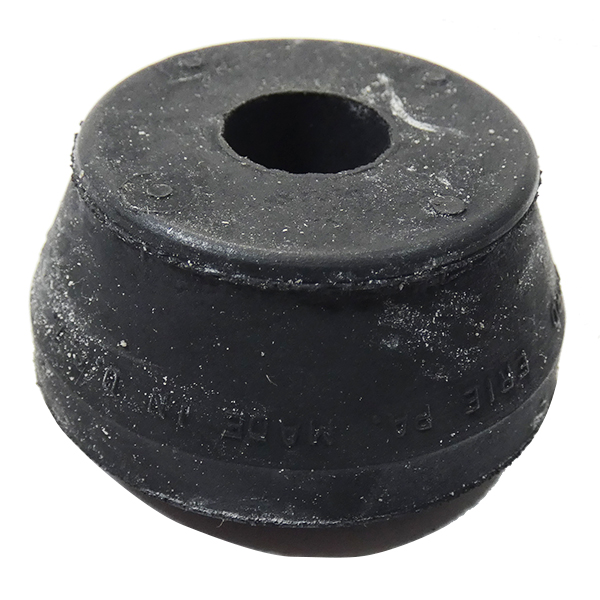

The quality or density of the Lord mounts will also affect transfer of vibration through the airframe; but this will be low frequency noise... Modern fluid filled engine mounts totally eliminate vibrational transference of modal and audial frequencies across mounting frames.
Discounting harmonics the modal frequencies will be equal an array of mechanical torsional oscillations pulses and gear teeth meshing at variable rpm.
I'm unable to comment upon the majority of individuals out there that realise just how much sound comes from an engine's induction system other than i think it is not broad; most may just say "that vehicle is loud"...

Does your CFD show the ideal location for the carb vents in the plenum? Should be as close to a stagnant velocity point as possible I would guess. Does your analysis take into consideration some pressure buildup due to the ram air intake.
In my plenum they are located about as far from the top as in yours but further outboard, more or less in line with the carb intake axis.
Chris

Chris, the product you pictured is the same spec, and its "Diver Consolidate Industries" in victoria australia, google for "DCI Heat Shielding", try emailing Wayne, he will fill you in on how to correctly use this product. For something like a 60's mustang rear quarter you only need a 4x12 inch strip to stop the panel drumming. There are other lighter DCI products for noise attenuation.
Regarding the compensation tube positioning; any position 1.5" toward the center of the plenum box away from the carbi induction port will be in static atmospheric conditions and away from induction affects.
The plenum box rests upon the top of the undercarriage spaceframe posts and backface firewall; it could be 50kg and still not cause any stress upon the bing carbi mounts.
If you are going to use this product practice on a few unimportant things first; when i say "you cannot remove it too reposition" i really mean it! And the external foil will tear easily with sharp objects; use a lino print roller to finish hand applying and smoothing out; wipe down fiberglass with prepsol first. Drill your threaded holes from the inside out last... paper or cardboard stencils are required to lay on the flat sheet to cut out; add a 10mm boundary for trimming off as you go.

On Mar 16, 2023, at 6:34 PM, Area-51 <goldsteinindustrial(at)gmail.com> wrote:
Ok, an update from this morning's second test flight...
Today was magic; perfect conditions and zero wind; was up in the air just after sunrise; and experienced even more brilliant results... Today I got to use my TSO'd Clarity Aloft in ear comms without any bit of challenge from external noise; they are actually better to use now than the Bose Active X; even on WOT the Clarity Aloft volume was set at about 30%.. the aircraft flight experience is now like cruising down the highway in a wonderful 60's british sports car... it takes a lot to impress me, and i am beyond impressed; the aircraft is just such a joy to be in now.
The conditions were so good today i tootled around at 70kt for 75minutes and burnt a whopping 6Lt of fuel... 😂😂😂
As is the mod has sent hell screaming back to where it fricken came from!

😂😂, i had it trimmed out nicely at 65kt at a few stages at 3600rpm but the prop was starting to unload too much.
http://www.dci.com.au/services/thermal_acoustic_shielding
They will have a US and Eu distributor...
Peter, personally, from a material's fatigue perspective i would be concerned about the flexible carbi mounts ability to support the added mass under extended rough air or idling situations. Although lineal movement is small the mass inertia may at times be 6g-10g; multiply this by a factor of xthousand cycles and premature failure might occur; a carbi separation will ruin your day... probably better to support the airbox and use a 50mm id silicone hose as an interconnect and secondary carbi inertia absorbing support
Area-51
Joined: 03 May 2021
Posts: 439
PostPosted: Thu Mar 16, 2023 11:52 pm    Post subject: Re: the Obsidian Files - So Much Noise!!! Reply with quote
For treating firewall areas i would not use the butyl matting product... there is a much lighter "QS-SLIM" product in the DCI line that is a polyester weave with 3M adhesive and foil shielding; it's primarily a medium level heat shield and acoustic isolator for OEM automotive under roof paneling; weighs almost nothing and is perfect for the firewall and upper engine cowl lid... it can be purchased direct in 1000x1000 size sheets.
http://m.dciperformance.com.au/products/view/id:767/title:QS+Slim
http://m.dciperformance.com.au/products/view/id:770/title:QS+Diamond
* The butyl matting is not a fully fire retardant material; it will ignite given the right conditions, so read the spec sheet before implementing .
