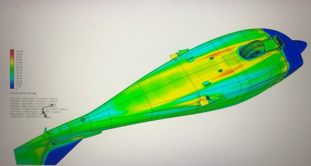

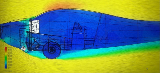

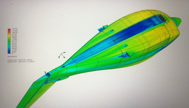

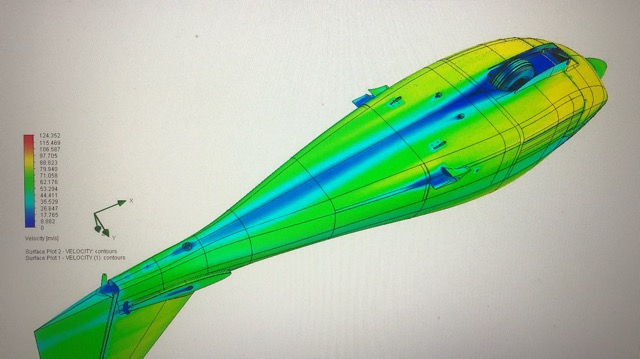

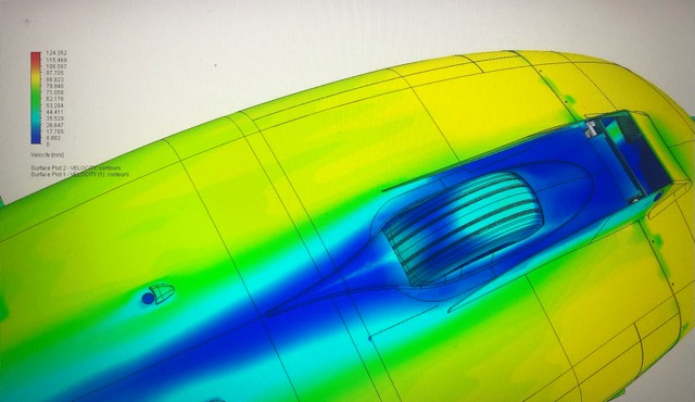

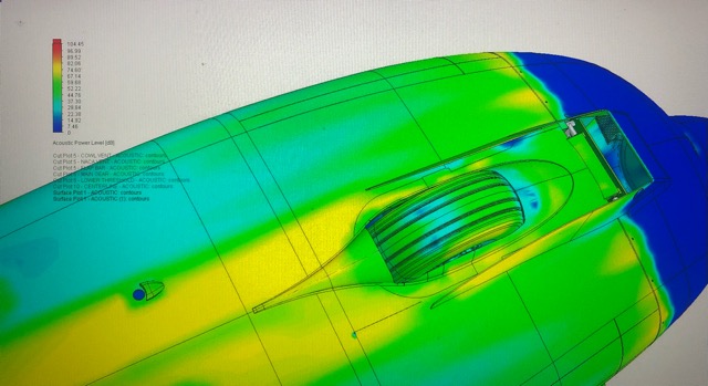

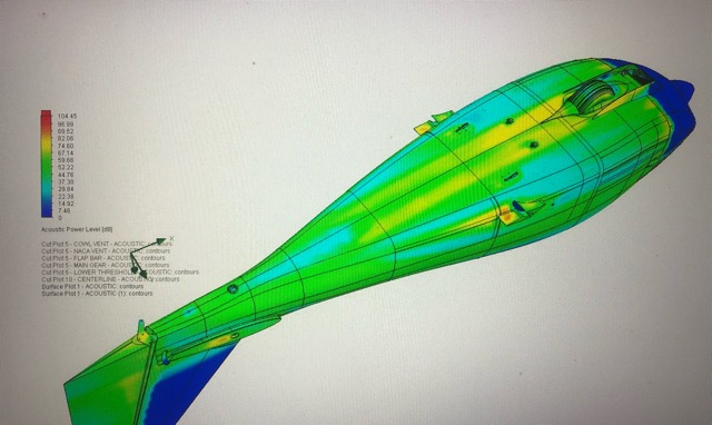

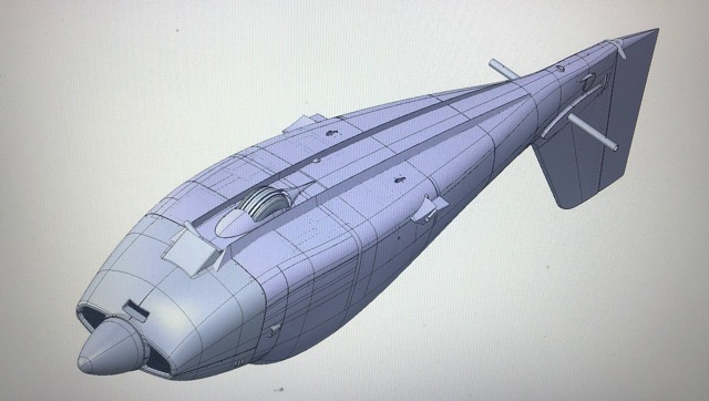

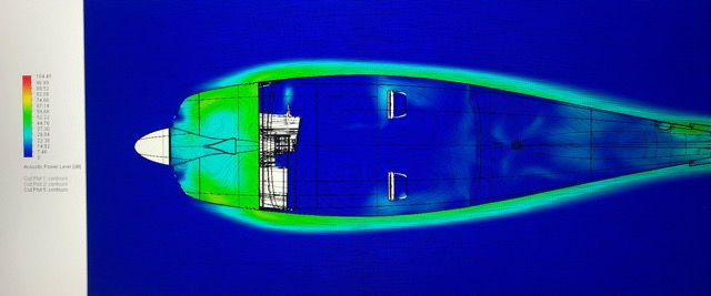

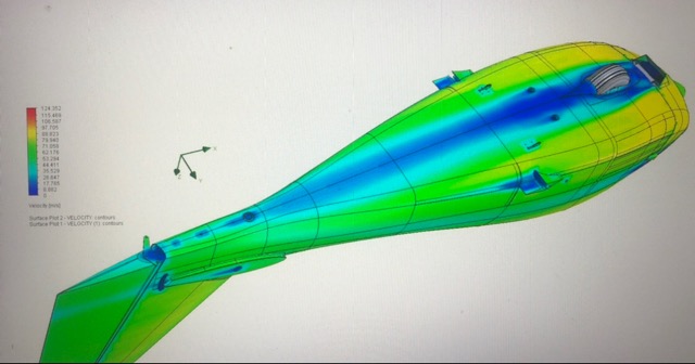

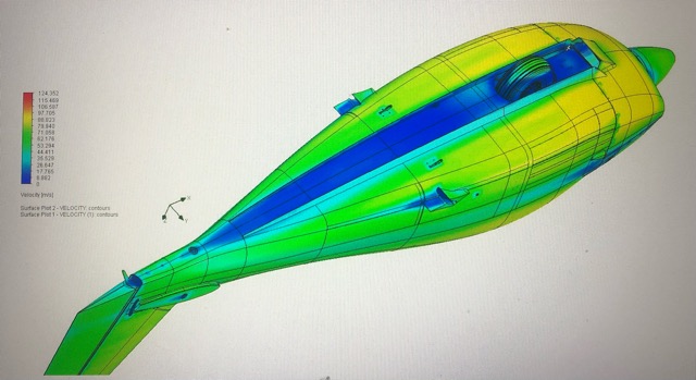

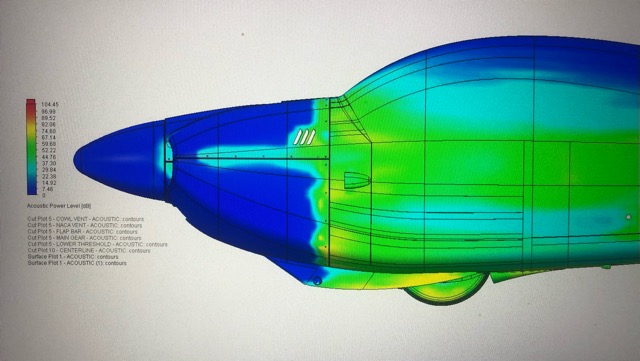

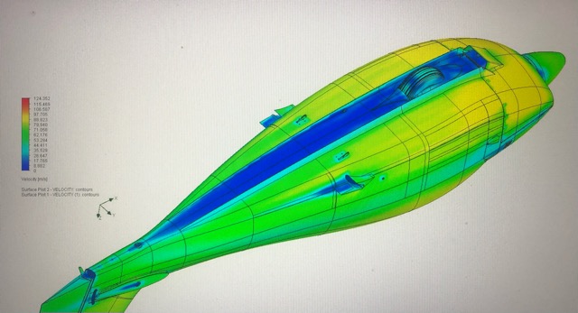

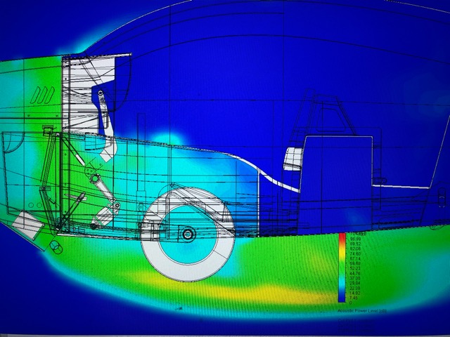

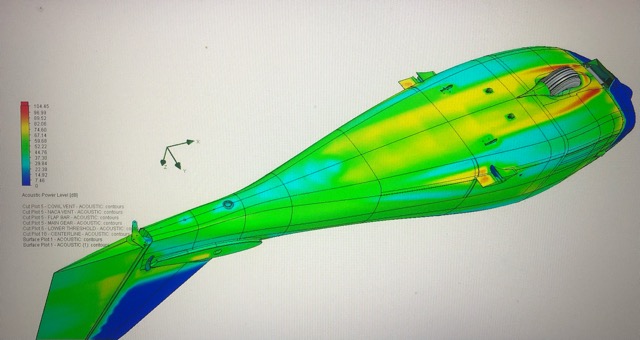

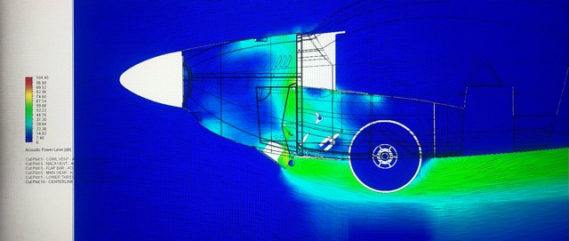

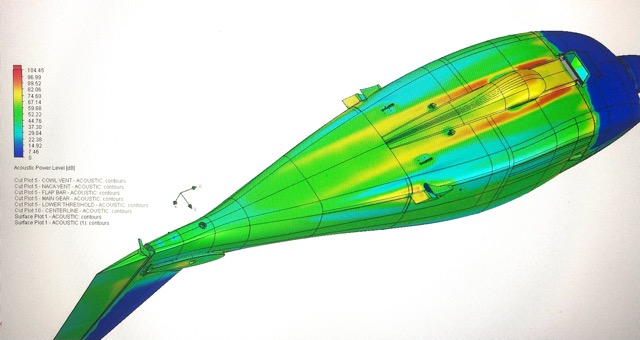

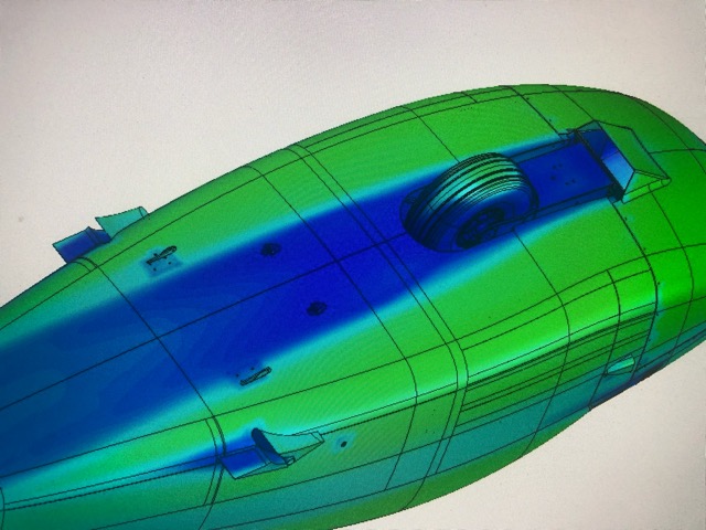

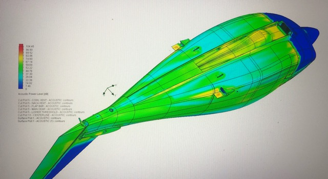

The second black op Obsidian File has been sanctioned for declassification... Techniques rumored used for original data extraction have been dispelled, however some information remains redacted... Some names have been changed to protect operatives still active within current high level field ops.
A quick review of data within this file focuses upon debated myth and legend of the Europa Mono wheel fairing... preliminary assessment of the facts shrouding this vicarious circle of assumptions points towards the successful mitigation of noise and turbulence; however the studies reviewed so far are just loose preliminary tasks used to verify test field integrity.
The attached images show Acoustic Power "noise levels", and the first image Velocity "air movement" at 51m/sec... higher resolution and more solution solving iterations will provide more clarity toward actuals; but what has been revealed so far is useful and indicative toward a standard equipped mono.
Acoustic power under 50db is equivalent to sitting in a open park on a mild day... 70db starts to become noticeable... 80db is audible... 90db is noticeable... 100db is loud... 105db is fricken loud...

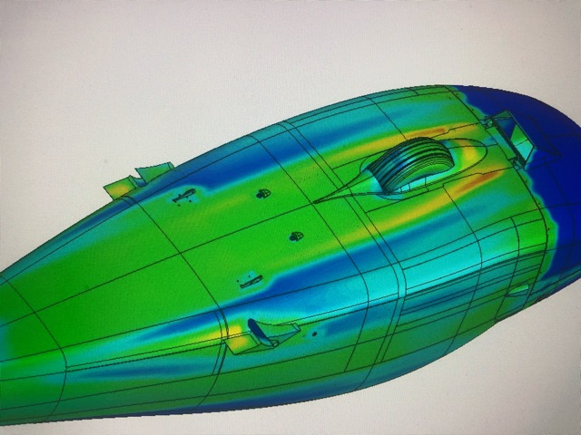

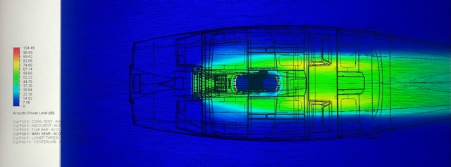

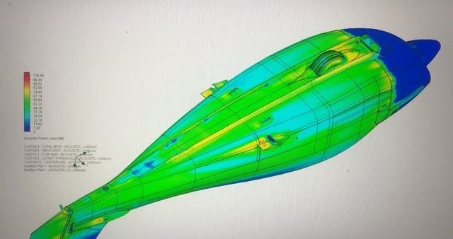

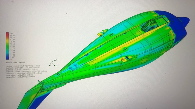

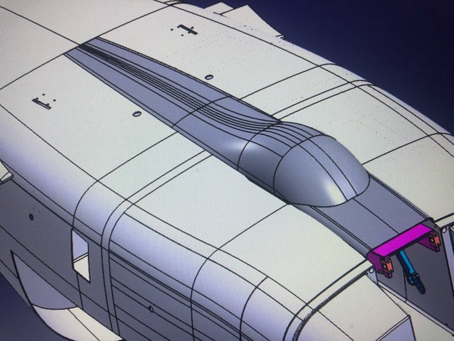

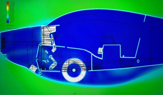

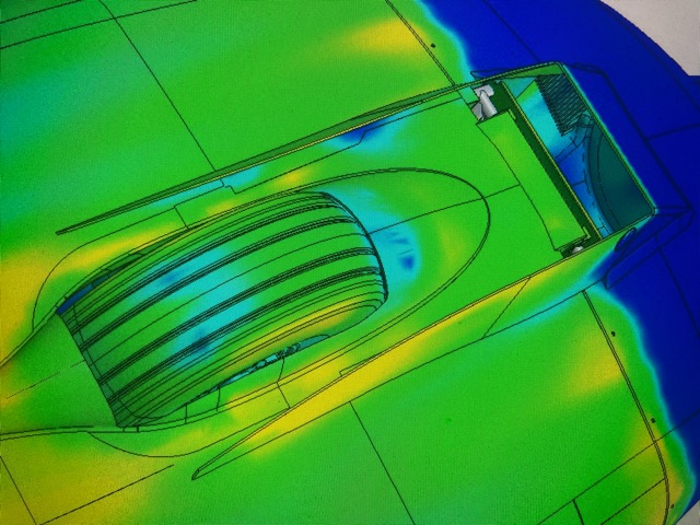

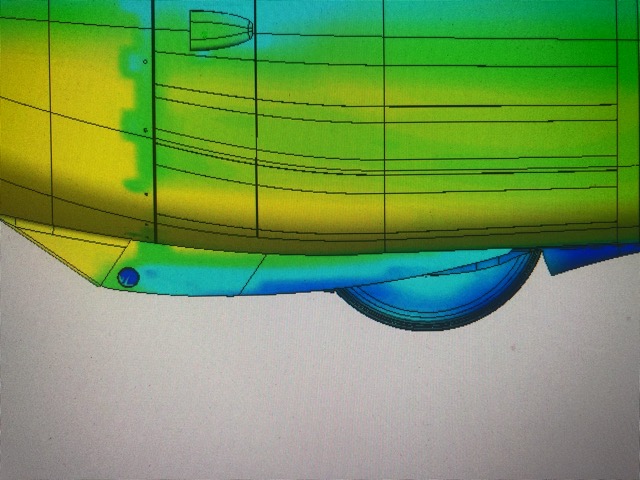

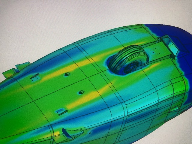

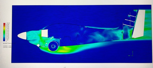

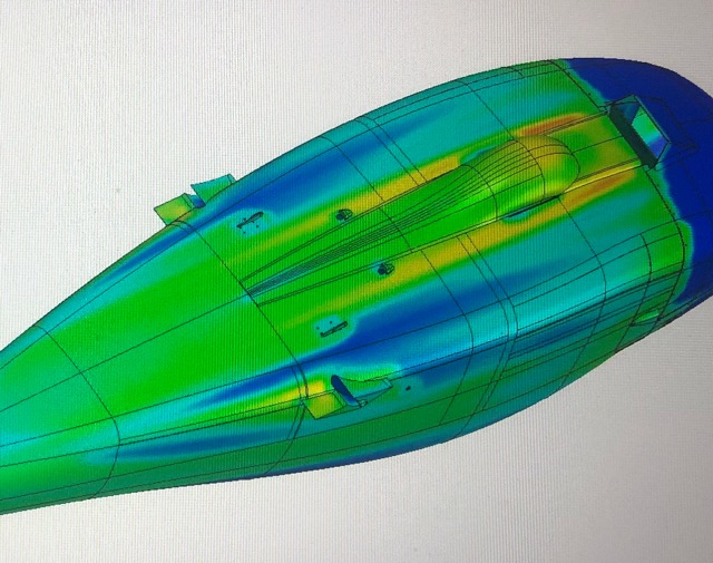

Today was spent raising the resolution of the analysis and re-running the preliminary solution... Some points of interest were glanced over also, being static pressure inside the engine cowl, flow velocity through various airframe vents and openings...
Regarding the main gear area... as the images show, with the gear retracted and set at its operational position, due to the existing lower cowl faring, it remains just on the cusp of free-stream air during flight; however, about 80db of noise is being displayed downstream; whether this is caused by the wheel or the cowl faring is not yet determined... some updated images attached; the first Velocity, the next two Acoustic Noise.
The areas responsible where most noise is generated are the flap tube ports in the fuselage; somewhere in the order of 90db. However this may alter with the wings installed.
Engine cowl interior is experiencing a positive rise in atmospheric pressure; so potential air flow through heat exchangers will be reduced. Some European's have enlarged cowl exit vents to allow more air to exit increasing flow through heat exchanges.
Velocity of air flowing through the cabin is approximately 12-15m/sec at 100kt airspeed. Volume flow has not yet been determined.

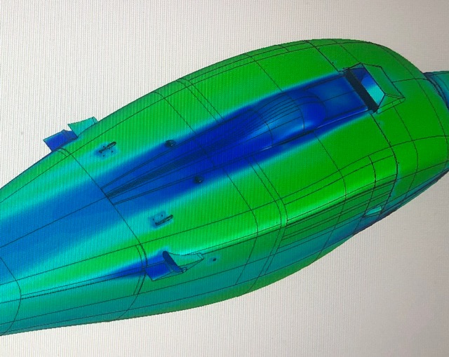

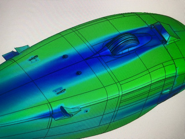

The past weekend has not been good for flying; so more numbers were crunched and more fairings were assessed; it was interesting to try some known shapes, no shapes, different retraction heights, and an initial design developed way back near the beginning of all this.
As usual the control piece was the standard mono in standard flight configuration at 100kt velocity (51m/sec). The airframe was stripped back to fuselage only to reduce computer power and solving time. Several indicators were implemented, Drag, Lift, Surface Velocity, Surface Acoustic Power... Fairings were tried as semi and fully enclosed scenarios.
What the computer said...
The standard mono wheel, when retracted, skips on its tyre upon free stream air; most all the remaining tyre remains within a protected pocket created by the lower cowl deflector covering the muffler... employing a fairing does little to reduce drag, however it does reduce acoustic noise within the undercarriage well... a fully sealed fairing reduces this acoustic noise to near zero... the variance upon drag factor between no fairing and fully enclosed is about 1kg out of 38kg total; Lift variance is 1.8kg less with a fairing out of 7.8kg total and is probably due to the tyre skipping on the free stream air... and there's not a great more to add for the mono wheel faring other than the ball ended enclosed shape providing the best aerodynamic results.
The idea of a fairing around the main gear looks and sounds great and appears to not offer much else for the "you beaut go faster" europa addict.
The best bang for buck might be to simply retract the gear a couple of inches further...
And thats about it on this one; myth busted 🤷��♂�
Attached images relate to velocity and acoustic comparisons.

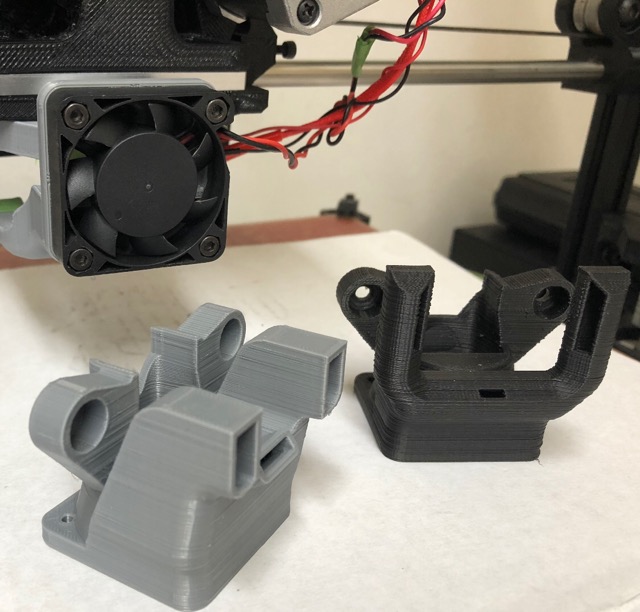

Gaps and edges can be noise generators. The semi enclosed fairing has a large gap at the rear to allow tyre passing. On something like the europa installing bristle brushes at the gaps might offer an affective cheap and light solution here.
Cooling ducts on 3D printers are a real challenge. I did one a few years back as i wasnt happy with the factory side flow versions; so i designed up a really affective single head unit which resulted in a 150g lighter print head; took five assumptions to get the flow balance correct between the print nozzle and heat break; there is an internal splitter used... works great! Let me know if you are interested, can send you the STL file, ready to print.
The black version was a Makerbot styled ripoff and a total fail; the grey one on the left is a winner.
Cooling Duct - 3D Printer

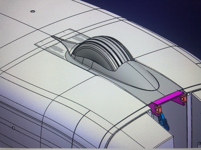

Lunch has now turned into dinner.. there was a brief hiatus in the weather where the sun came out and a bunch of bananas were lopped from the tree and many hands cut off; of bananas, not apes...
So just for entertainment and curiosity the fence concept was extended further to a more aft limit near to the fuel drains... that worked favourably for all three options; so the concept was developed into an undeveloped triangular rib concept extending to around 1m short of the stern. And that appears to also work favourably toward keeping air flowing neatly and quietly downstream to the undercarriage. A secondary affect if shaped with foam and glassed over would be added rigidity of the belly skin and less tendency for panel drumming. The fully enclosed option begins to deteriorate in aerodynamic performance as its shape is no longer optimised for the altered environment.
Peter the fence is just a 3.00mm piece of flat plate running from the lower engine cowl side face rearward; a block of triangular shaped foam glued to the skin would also work for a temporary trial... ending it just forward of the fuel drain vents will function well; the fence height used in tests is 64.0mm and falls off to 15.0mm height at the rear.

A question that you might know some answers to: do you have any drag data that relates to EACH of the individual speed kit fairings, please?
The reason i ask is that i took the view when fitting my Mono speed kit fairings, that the inboard and mid-flap brackets would not benefit from fairings - on the basis that they would increase frontal area whereas the brackets as they stand are just 'blades' in the airflow. I fitted the outrigger bracket fairings though.
But i have no data to substantiate that action - just a gut feel.
I would be most grateful for your view - and if you have the time/interest, it would be useful if we could see the effectiveness of each of the factory fairings for each type as well . . .??
