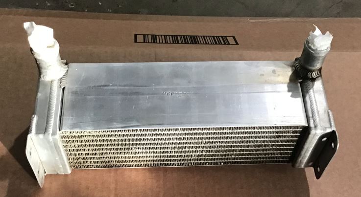

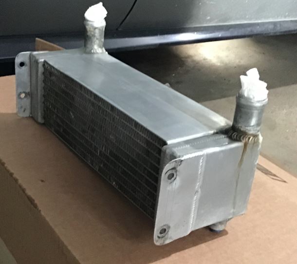

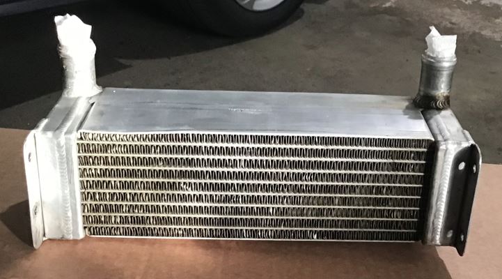

Ours is out of the plane right now so here are dimensions and photos
Actual radiator portion (core) 10 1/8" wide, 3 3/8" deep, 3 1/2" tall. There are 9 rows of fins.
The tanks at each end are the same 4" deep, 3 1/2" tall and 1" wide.
Overall length of complete radiator is 12 3/8" I realize that doesn't add up but there is a little space between the ends of the rad core and the tanks.
