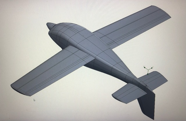

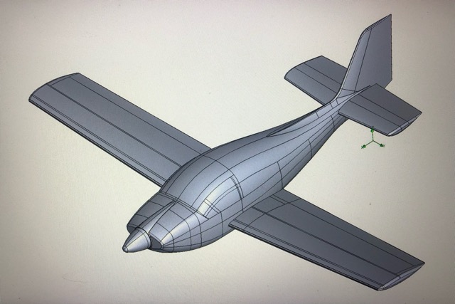

So now that we have dealt with the preamble and have some familiarity with what all the rainbow images and basic terminology used is about it should be a good moment to introduce our science pig, sorry plug… I call it Pig because that is what it is; a happy jovial highly intelligent pig that does not mind being pushed and prodded around the yard.
Pig-01 is used as a Baseline measure that all upstream tests can be referred back to and compared against. It is a Clean Skin 3D model, meaning there are no extra bits added or protruding from the basic aerodynamic shape; it is as slippery as a Europa Classic can possibly be without further modification. And contrary to the mention of two Pigs in the Preamble there can only be space for one Pig in this story of shock and awe.
The model lends itself to set criteria of variance in order to identify our Primary Baseline. This criterion consists of the following:
Wings – 6DOF
Horizontal Stab – 6DOF
Fuselage Fixed
With only three pieces making up our pig the third piece being the fuselage is fixed at 0deg attitude; the lower surface line of the hatches set to the horizontal of the XY plane with the longitudinal axis being in the XZ direction. This allows complete augmentation of both Wing Incidence and Pitch of the Horizontal Stab. Height of both pieces can also be altered relative to the fixed fuselage.
Dihedral of the main wing is set at 4deg.
In order to Zero the model Incidence of the Main Wing is set at 0deg for the primary round of CFD analysis, using the wing’s chord line at the longitudinal centreline of the fuselage as the identifier.
Alpha is also set at 0deg.

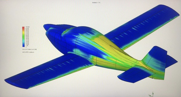

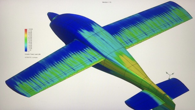

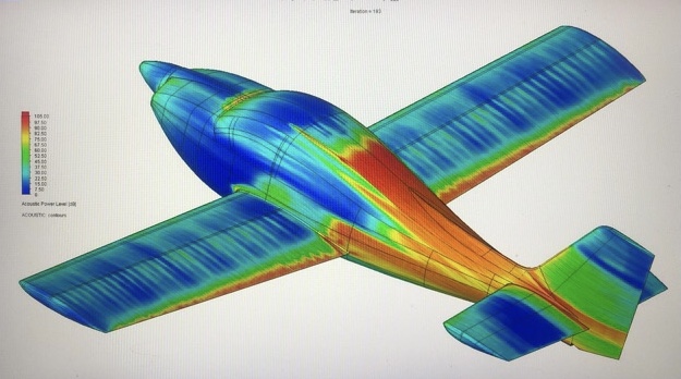

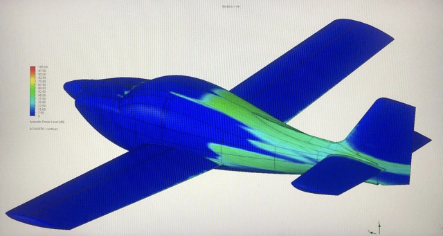

Not too shabby… But what is happening to the air while it skirts over the model’s skin? Is there a lot of turbulence? Is there a lot of noise? Well… Yes and No…
At first Velocity prints were looked at across all the velocity vectors, and it was surprising to observe very little alteration in the velocity pattern over the model. Other than the velocity band increasing in magnitude, at Alpha 0 or 1 or 2 the patterns remained fairly unaltered.

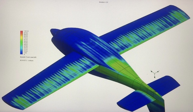

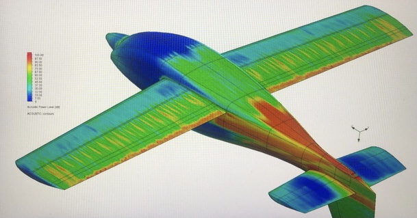

Then Acoustic Power prints were looked at in the same manner as with Velocity, and it revealed a slightly different picture.
At 38.50m/s (75kt) to 51.44m/s (100kt) there is very little audible noise being generated by our Pig; 35db – 55db max respectfully. In other words, this Pig is silent while flying through the sky…
With increases in velocity our pig starts to murmur a bit, and as velocity increases our pig is squealing at the top of its capacity at 110db at 400kt… 747 on T/O equivalent… its Loud…
The other thing that was picked up by the Acoustic prints was Cavitation over the Boundary Layer; as velocity increases so does cavitation. This being the cause of the rise in db power; and more will be written about this later, but for now all we need to know is that cavitation equal’s noise…

The Europa’s form is very slippery, but the CFD studies are revealing areas around the Empennage aft of the cabin where cavitation begins and continues aft; so we are seeing the effects of boundary layer separation that is taking place just above the model’s skin… The Velocity prints are not detecting this as they are focused upon a very shallow layer, where as the Acoustic Power prints reveal the affects more of what is going on around the selected layer band; so this is why we can use them to tell another story other than just noise, and more so read them as an indication of what may be the cause of the noise; which, in this environment, can only be cavitation.
Cavitation also is evident with the wing. At 0deg Incidence the cavitation is minimal and is seen along the last inch of the upper trailing edge and along the last 2 or so inches of the lower trailing edge. Longitudinal cavitation streaks are also evident on the lower surface of the wing at Alpha-0. As Velocity increases these areas of cavitation extend further in from the trailing edge of the wing and increase in amplitude. However this study is not focused upon the wing so we will leave this story for another episode.
As far as actual noise is concerned even at 150kt the Acoustic Power being generated by this above cavitation is only at 70db max… So we are still, from 100m or so away, flying silently. At 200kt things are just starting to become detectible over the murmur of daytime nature.
So what about this cavitation and how might it be mitigated? At this point no definitive idea, however looking at the shape of the empennage, being slightly concave, changing it to a slightly convex shape may return favourable numbers. Looking toward the Liberty XL may provide some direction. Regarding cavitation around areas of the wing, this tends to diminish as Alpha is increased. Again this is another bedtime story to be told another night…
