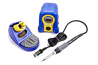

Hi Bob, do you have a recommendation for where I can get copper tips for my Hakko FX888D-23BY?
Thank you,
Sebastien
