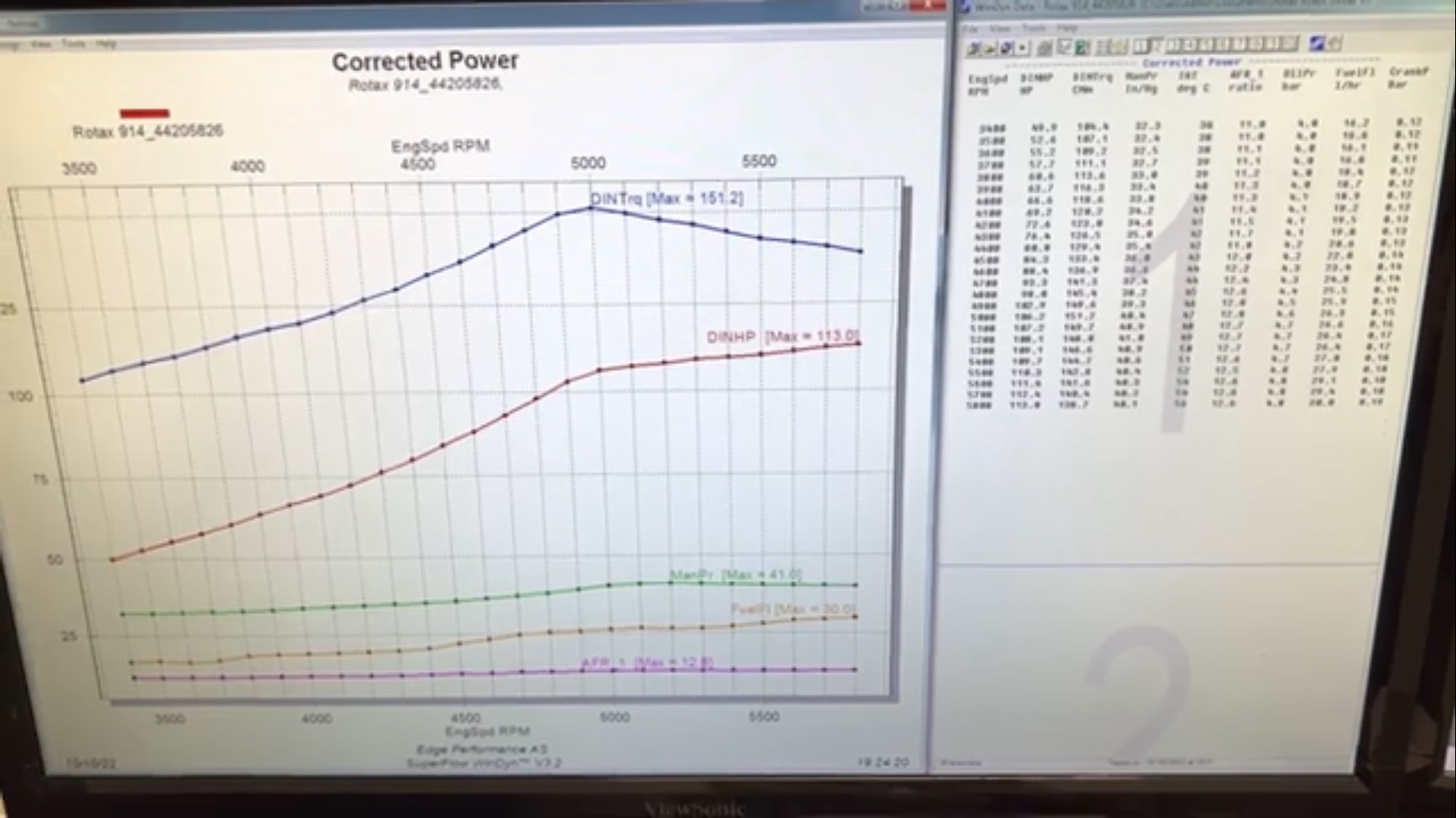

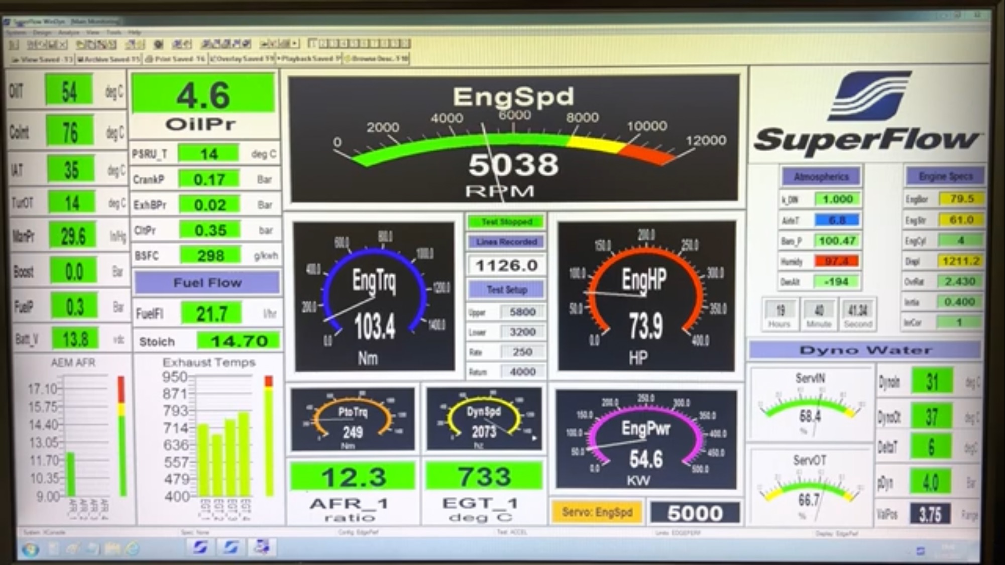

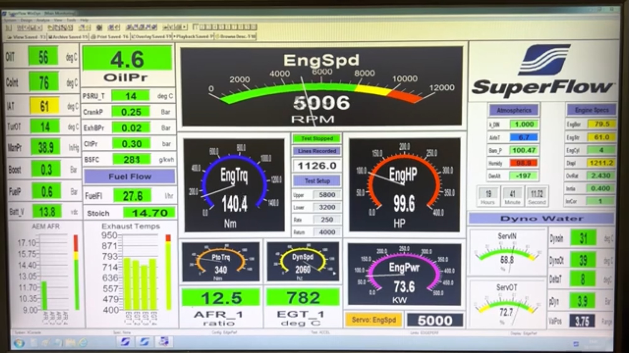

This was a really interesting video to watch.
https://m.youtube.com/watch?v=lE6Y37GPQqY
Edge Performance dyno test of a stock Rotax 914 with results.
It would appear that running the 914 at 5500rpm and 5800rpm produces less HP Economy and Torque than running at 5000rpm due to the ECU opening the wastegate as post turbo IAT increases.
Off-Boost numbers at 5000rpm also are indicative of 912 80hp performance at 5000rpm.
The PTO Torque (orange readout) above AFR is available torque at the propeller shaft, and Dyno Speed (yellow readout) above EGT is the propeller shaft RPM.

Thing's are not always as they first appear, fortunately. As one Youtube reply would suggest. He also had a high IAT of 92C but after isolating his inlet from the exhaust/turbo heat his IAT dropped to 42C...so maybe you don't need that intercooler after all. The devil is often in the details...details we learn about later.

Thought it was interesting re' how the ECU bleeds off boost as IAT increases.
Wondering if this is experienced by end users not running intercooler.
Also provides turbo timing data.

The Torque performance figures in the Rotax Op' manual do not match the Edge Performance results due to differences in wastgate function. The Edge Performance run shows full MAP of 41 from 5000rpm upward while the Rotax figures state MAP of 31 at 5000rpm. Timing the turbo for full boost at 5000rpm extracts the engine's full Torque curve potential. Approx 105hp at 5000rpm v's 74hp. Whether or not the engine can sustain this level of thermal loading while using an intercooler is another matter. EGT and CHT readings would indicate yes or no. Keep in mind these performance figures are under full load WOT and the pitched propeller may or may not actually request this amount of power under real flight conditions.

You were not comparing apples with apples when you said the 914 can only make 74hp at 5,000 rpm. You were probably looking at performance data for CS prop page 5-4. That shows a 75% (that is of 100%) setting of 31" and 5,000 rpm. 31" is not the maximum MF pressure, it just happens to be what is required for 75%.
If you look at Manifold Pressure graph page 5-2 and Performance graph for standard conditions page 5-2, you will see that 100% continuous manifold pressure and 5,000 rpm produces just under 90 horse power. Using 115% manifold pressure and 5,000 rpm, horse power is just under 100hp.
