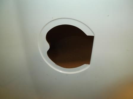

Hi Rowland
My cowl had been trimmed by Nev when I collected it and was as shown in the picture.
I therefore assumed the intention was for the hinge to be riveted to the underside of the cowl and panel, using countersink rivets and filled after.
Much like the rudder, ailerons, etc.

Hi Rowland
I have fitted mine as described by Kelvin, and
The cut out is similar to the photo he posted.

My Neville Eyre cowl hatch hinges have the hinge knuckle upwards. The hinges are the same as used for ailerons and anti servo tabs, so if the hinge flaps are tucked under the cowl, then the knuckles are about flush with the cowl top surface.
I used the smallest pop rivets through the cowl with countersunk heads flush with the cowl top surface. Three such little rivets through each hinge flap results in two neat rows of rivets per hinge and I saw no need to cover or paint the rivet heads.
Of course the cowl hatches only open about 90 degrees, but this is plenty for giving access to the oil and coolant caps.
