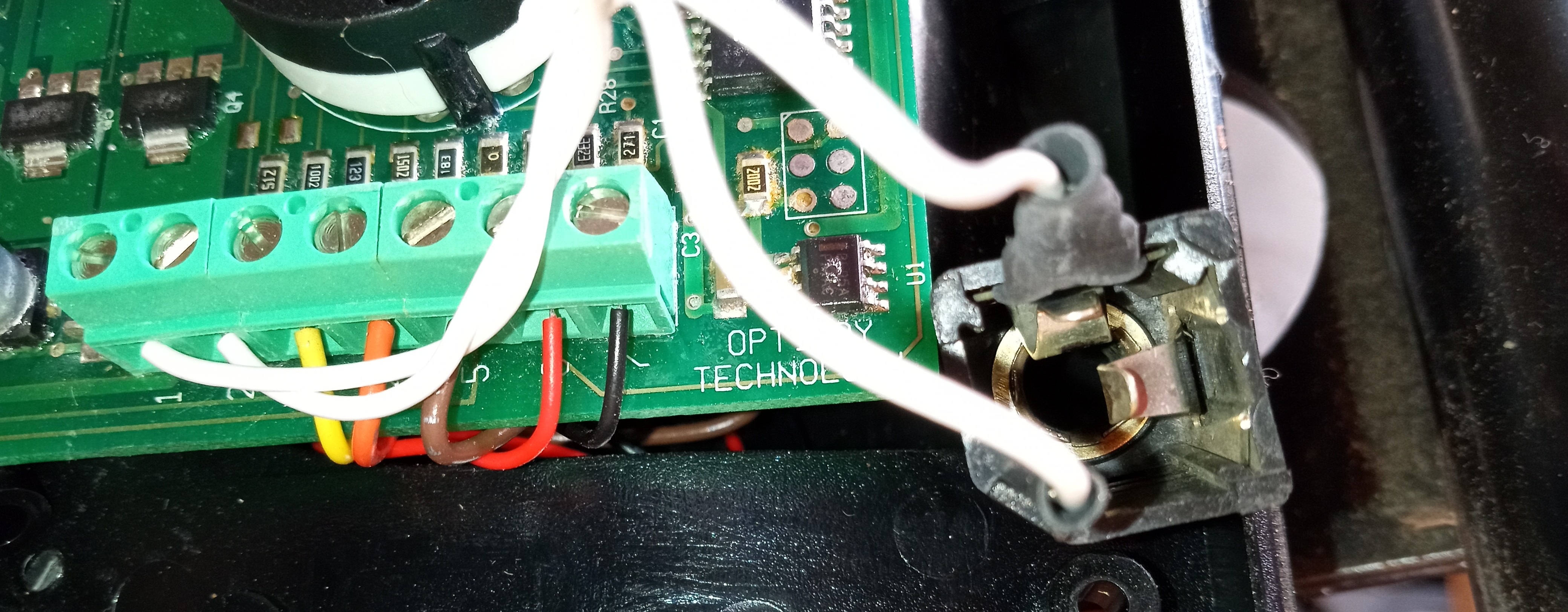

Here is a picture of the back of the jack and where it attaches to the boardWhat I cannot understand is that sometimes you had to jiggle it before itworkedDoes not look like a normally closed switchHad to resend so changed topic

Thanks for all the help and suggestions.
Feel like a complete idiot, problem was a tripped breaker that I did not know about, all well now
Mike
