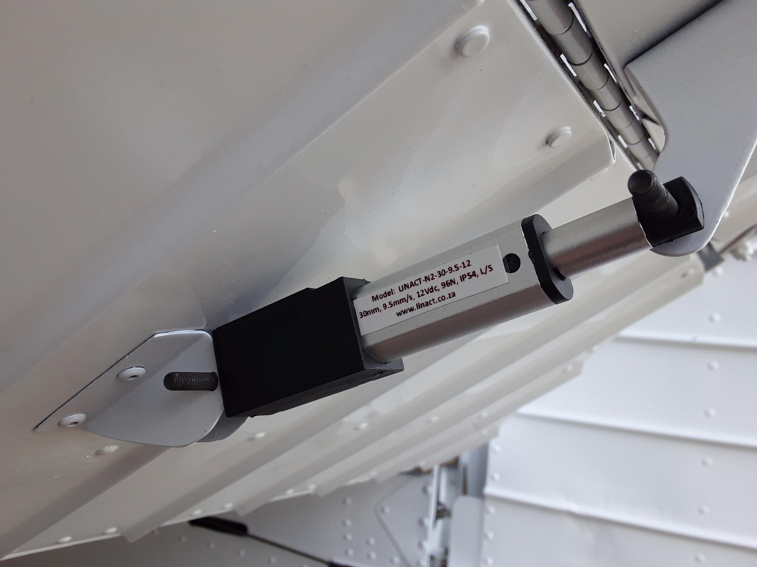

This is a well tested solution on LSA airplanes in our part of the world.
Small trimtab makes it unlikely that a runaway event or mechanical disconnect will lead to catastrophic failure. Furthermore, these airplanes are for day VFR use only.
The unit is a simple 2 wire system and robust, with internal travel limit switches.
[img]cid:ii_ll14yjzy0[/img]

Here is the website for the linear actuator pictured above by Bob Verwey.
https://www.linact.co.za/lite-duty-linear-actuators/#Micro_N2
