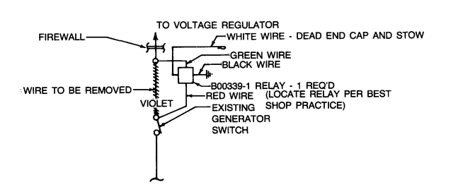

    What is this overvoltage relay and how is it wired.
    Can a Ford regulator VR166 be used in combination with this overvoltage relay? (Lamar regulator B-00267-2 is only available used and is expensive.)

Found this via google search:
https://www.bonanza.org/globalassets/aircraft/service-instructions/si-1062---electrical-power---installation-of-an-overvoltage-relay-for-the-60-amp-alternator-system.pdf
So evidently the relay opens the circuit to the voltage regulator if the electrical system voltage is too high.

Thanks Joe,
It seems to me:
    The OP can use a "Ford" VR166 voltage regulator.
    The overvoltage field interrupter relay is from a former time before overvoltage crowbars.
