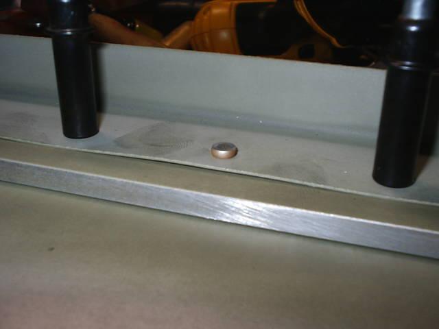

Hi guys,
I'm working on the solid riveting of my wing spars, and am having a strange thing happen while driving the smaller -5 rivets. The plans call for the factory rivet head to rest on the spar web, so the rivet goes through the web, through the spar cap, and through the spar cap angle - that's where you're supposed to drive the shop head.
I've driven all of the -6 rivets and they came out fine, but whenever I drive a shop head on the -5 rivets, the spar cap angle lifts slightly (see attached pic). I'm squeezing the parts together as I drive the rivet so there's no space in between them. I've only driven a couple of these smaller guys, but it seems to be happening with every rivet. In some places it's lifted more than the picture shows. I'm stumped.
Anybody seen this?
Thanks in advance for your help.
Debo Cox
Nags Head, NC
XL/Corvair

PostPosted: Tue Oct 24, 2006 3:20 pm    Post subject: Solid Riveting Problem Reply with quote
Debo,
I assume you did all the regular stuff. Deburr everything. Clamp the pieces together. The rivet is the right size for the whole etc,. I think the only time this happened to me was if there was something between the layers or I didn't clamp the pieces tight enough or close enough to the hole. Not sure though, it's been longer than a couple of days.
Dave in Salem

PostPosted: Tue Oct 24, 2006 5:17 pm    Post subject: Solid Riveting Problem Reply with quote
Hi Debo,
Are you sure that you put the head of the rivet on the thinner material side to rivet ?
Chris

PostPosted: Tue Oct 24, 2006 5:41 pm    Post subject: Re: Solid Riveting Problem Reply with quote
Debo,
How about taking a piece of the leftover spar cap and making a tool that will fit between the clecoes and have a notch or hole around the rivet. Clamp that then rivet and see if it helps. I ran a couple of test pieces the other day and did not see that happen. There are two different lengths of the 5 rivets.
Ron Lendon

PostPosted: Wed Oct 25, 2006 5:06 am    Post subject: Re: Solid Riveting Problem Reply with quote
Debo. Just looking at the one pic you posted I would suggest that the hole distances for those two adjacent clecos are not lined up. I.E. The hole to hole distance in the angle seen in the pic is greater than the hole to hole distance in the spar underneath. OK, so you may clamp close by as you drive the rivet but the vibration may be causing the two surfaces to "bounce against each other and rivet material is able to infiltrate the gap. I would suggest you remove all clecos in the assy except one near the middle. Now start adding clecos one at a time in every 4th hole but look critically at the flatness of the whole thing as you add each one. Any time you add a cleco and see that there is ANY seperation between the two parts (in between the two clecoes you last added) the hole alignment is off and you need to run a reamer through those holes. the difference will be small enough that you will not see it. If you continue as you were without fixind this problem your spar will probably end up wavy instead of flat. Actually it will not be wavy. It will WANT to be wavy but will be prevented from doing so by the strength in the angle. This means you will be setting up some small stresses in the assy. If you took two thin test strips a couple of feet long and had this alignment problem you would see the waviness clearly. The fix is easy and cheap. Buy a Reamer if you don't have one of that hole size and run iy though the culprit holes. This is not an uncommon problem but its hard to explain with a keyboard. Contact me directly by email if any of this is not clear.......Geoff...If you have any electrical problems, call me last.

PostPosted: Wed Oct 25, 2006 9:21 am    Post subject: Re: Solid Riveting Problem Reply with quote
Hi Debo,
Just like Chris said. Look at the NOTE on 6-W-3.
Ron Lendon
