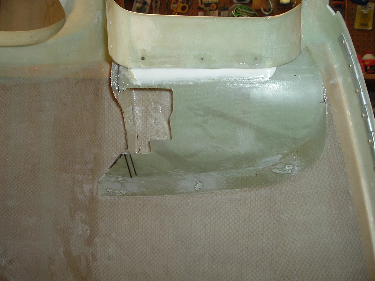

Great suggestions Tim on the cooling. I had already siliconed the baffle seal and aluminum baffling between the rivets but did not consider between the cylinders. We also closed in the top cowl around the prop governor with glass so the baffling can seal up against it vs letting the air escape out. (pic attached) I attached the prop governor cable on the outside of the governor arm and I see others have it attached on the inside between the governor housing and the arm. The governor cable lined up much nicer that way as it came through the air ramp. Is there any reason why I need to attach it the way you did?

That was a great job glassing the area behind the governor. I wish
I would have looked closer at that area when I was doing the cowl,
but I guess the rest of the baffling looked so good I overlooked
that whole area. You should have it licked in that area. I
may still add some RTV to mine so it seals tight against that
governor too.
I don't see any problem why if your arm lines up better on the outside
that you couldn't do it that way. Mine lined up better on the inside.
All I can think is that maybe your ramps were cut or drilled
differently or something, causing the shift, otherwise it would
seem like with these prepunched kits, we'd all be in the same spot.
But, if it works for you, it should be fine.
