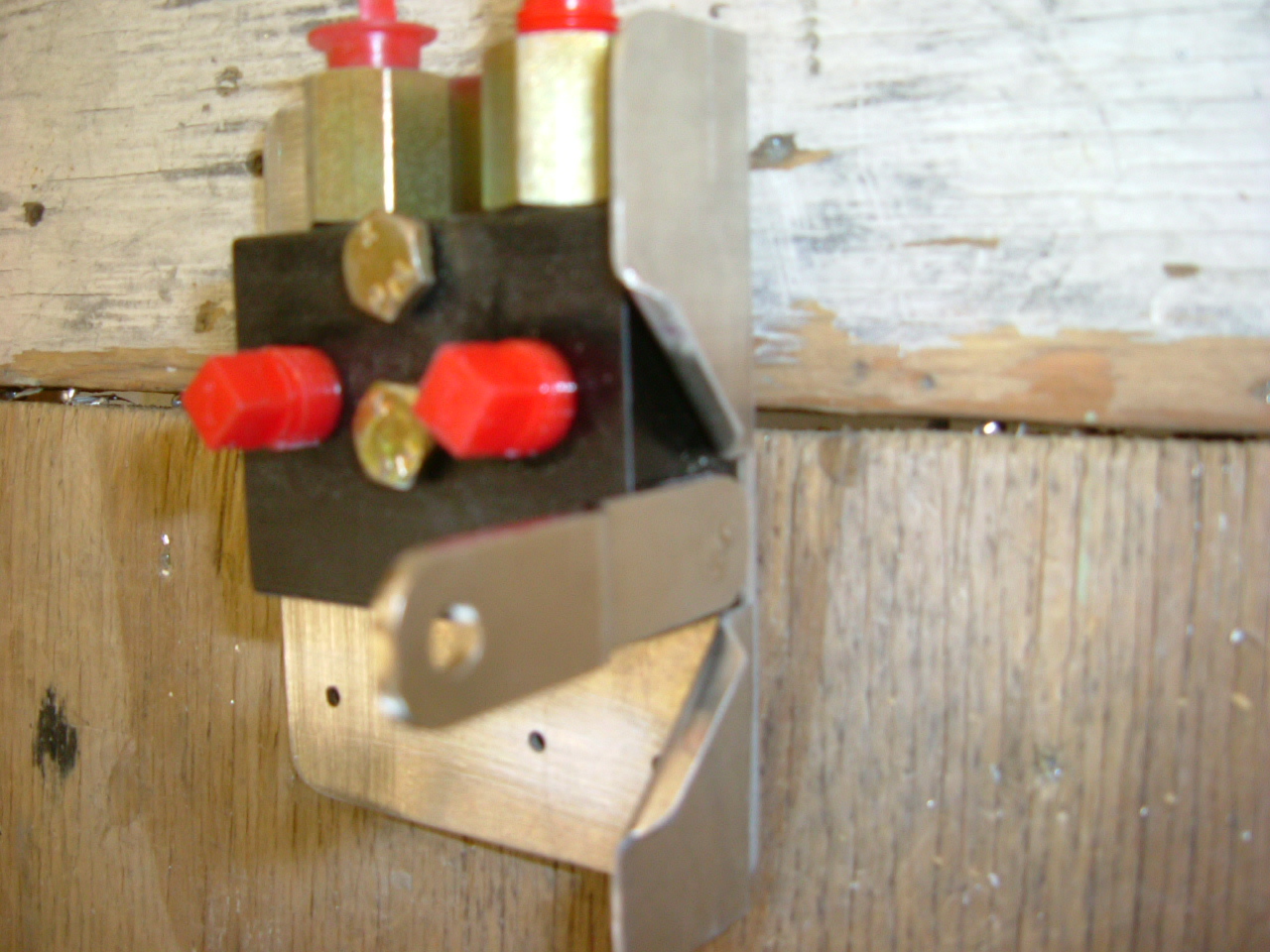

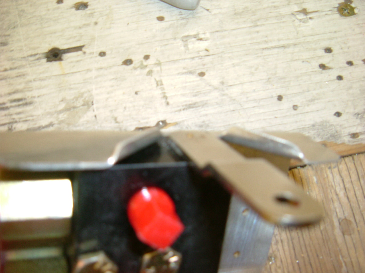

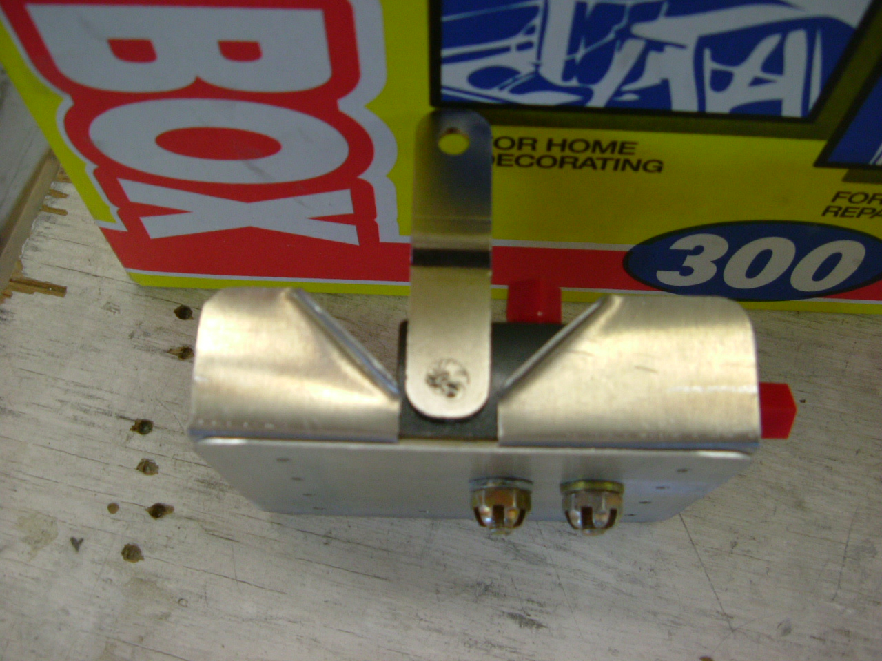

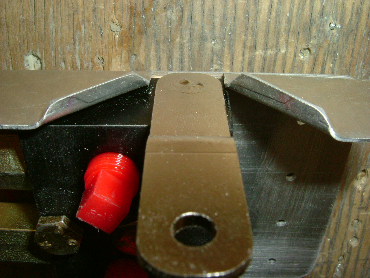

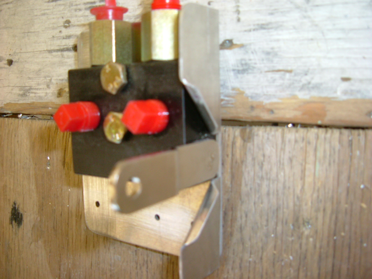

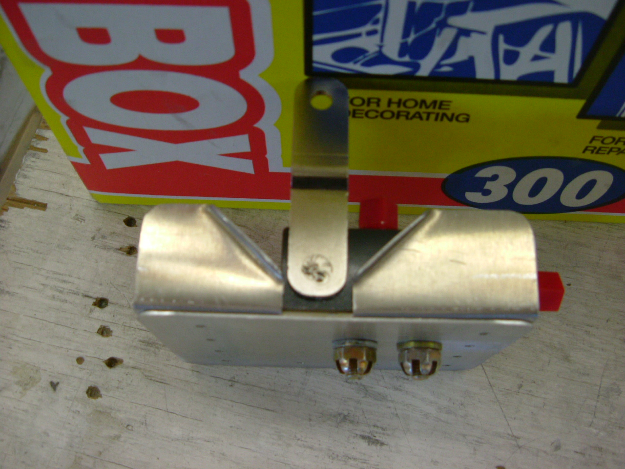

Here is one I built. Needed to be a little longer so the cable sheath would
have something to secure to. Would also make the base and doublers a little
bigger so all the holes in the fire wall would be covered.
Noel

noel(at)blueskyaviation.n
PostPosted: Wed Nov 01, 2006 8:00 am    Post subject: matco parking brake mounting bracket? Reply with quote
Looks really nice! How are you making a positive stop on both ends?
Noel

Adjust the arm so when knob is in all the way, valve is open. When knob is
pulled out, arm will contact the end of the cable sheath. I don't think you
need any more positive than that.
