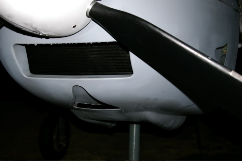

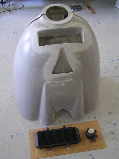

Posted: Wed Nov 29, 2006 2:21 pm Post subject: Re: CZAW cowl question again |

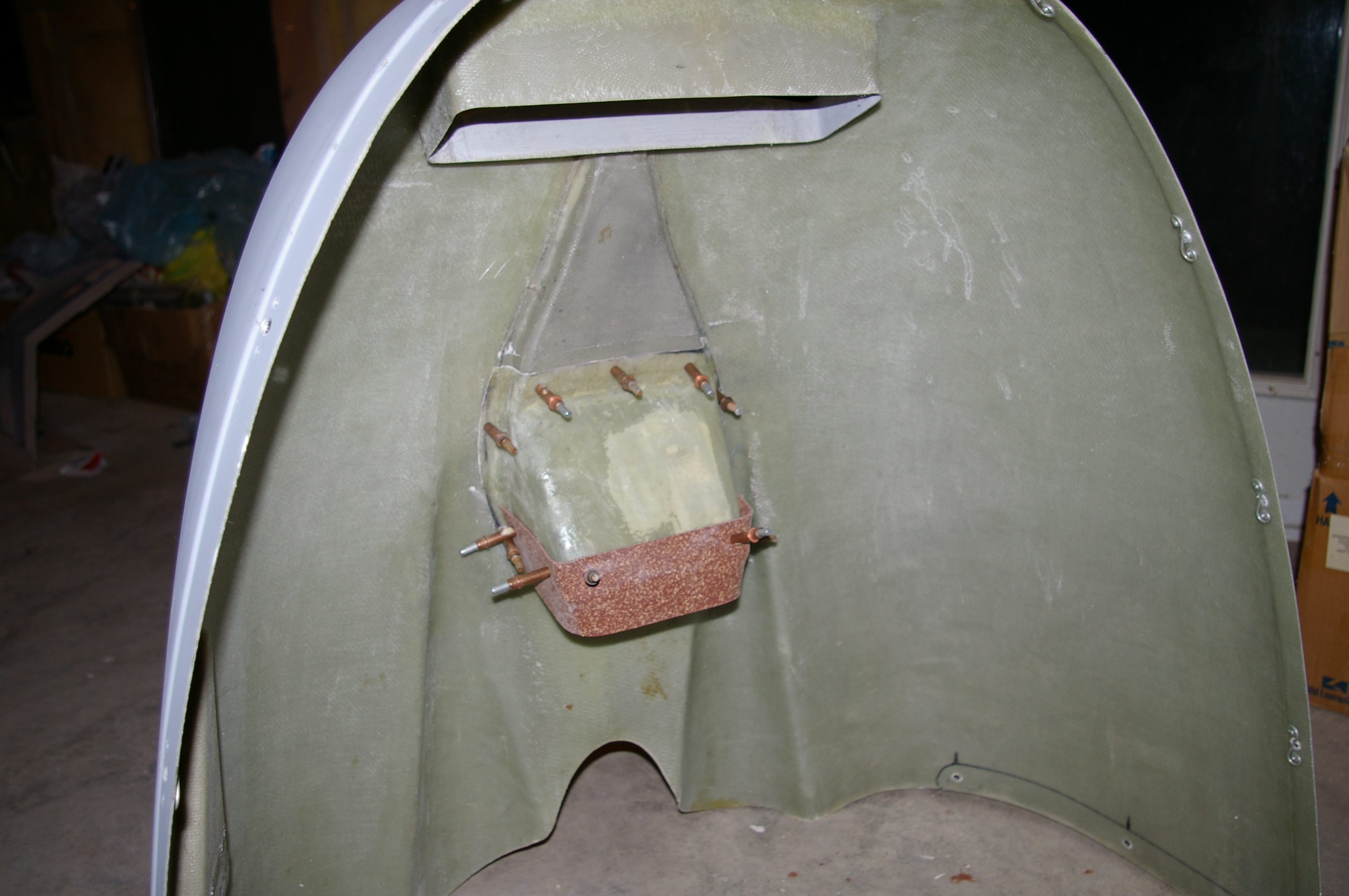

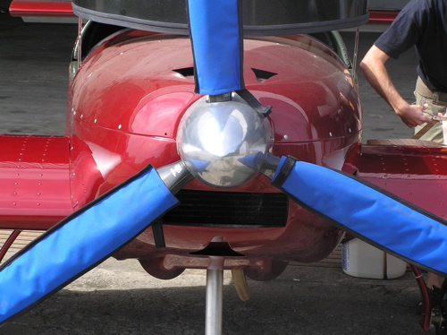

Here's the picture of the CZAW cowl I mentioned. Notice the oil cooler inlet on the bottom. The opening at the back is only 3/4". Since it's on an upwards angle when installed, cutting the "roof" of the inlet will make for a wider opening to allow more air in.
I've also attached another picture of a red 601 with the same cowl and the lower inlet seems to be missing much of the so-called "roof". You can clearly see the oil cooler in there.
Any thoughts?

zodieman
Joined: 29 Nov 2006 Posts: 17
Posted: Wed Nov 29, 2006 2:31 pm Post subject: CZAW cowl question again |
Remember, the 260F reading is taken from a location where the oil is HOT after gone through the engine. Newer 912's take the reading at the oil pump after it's gone through the cooler. Bound to be colder but I don't know how much...
Yes, I suppose I can cut the roof of the inlet a bit to make the opening larger by virtue of it being more "forward" because the inlet is on an upwards angle. I have posted pictures on the forum so everyone can see what I'm talking about.
Trev Page
C-IDUS 601HD R912

Posted: Thu Nov 30, 2006 2:35 am Post subject: CZAW cowl question again |
Ben I understand where you're coming from. Keep in mind however that I'm using a Rotax 912 engine where they specify the oil temp range based on a manual for a new engine. The oil temp reading on 912 engines since at least the mid 90s are taken at the oil pump housing after they have gone through the oil cooler. They state a max temp reading of 280F in that location.My engine dates back to at least 1990 according to the serial number and I've been dealing with quite a number of differences in my engine compared to newer ones of which the oil temps are one of them. The location of my probe is not in the newer location on the oil pump housing but on the front oil return line fitting where normally there is plug (or a banjo bolt for pusher configurations).
I've reported that I get a highest reading of 260F which is till within the 280F max temp according to a newer manual. I'm assuming at this point of course that the oil is bound to be hotter here but I don't know by how much...
This is why I don't know if I should try and mod the cowl to get them lower when they actually might be well below what I'm getting or just accept them since they are bound to be hotter.
I have a new VDO probe designed for current engine location but I can't use it on mine because the threads and hole size are different in my oil pump housing! Rotax changes the 912 constantly is this is just one of the little things that I've had to deal with...
I have a friend with an engine of the same vintage and I'll check with him to see where his oil temp probe is and perhaps try and correlate my readings with his.
Trev Page
C-IDUS 601HD R912

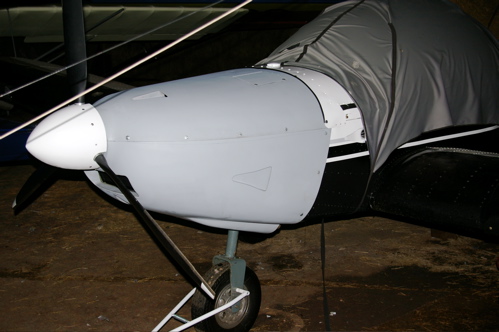

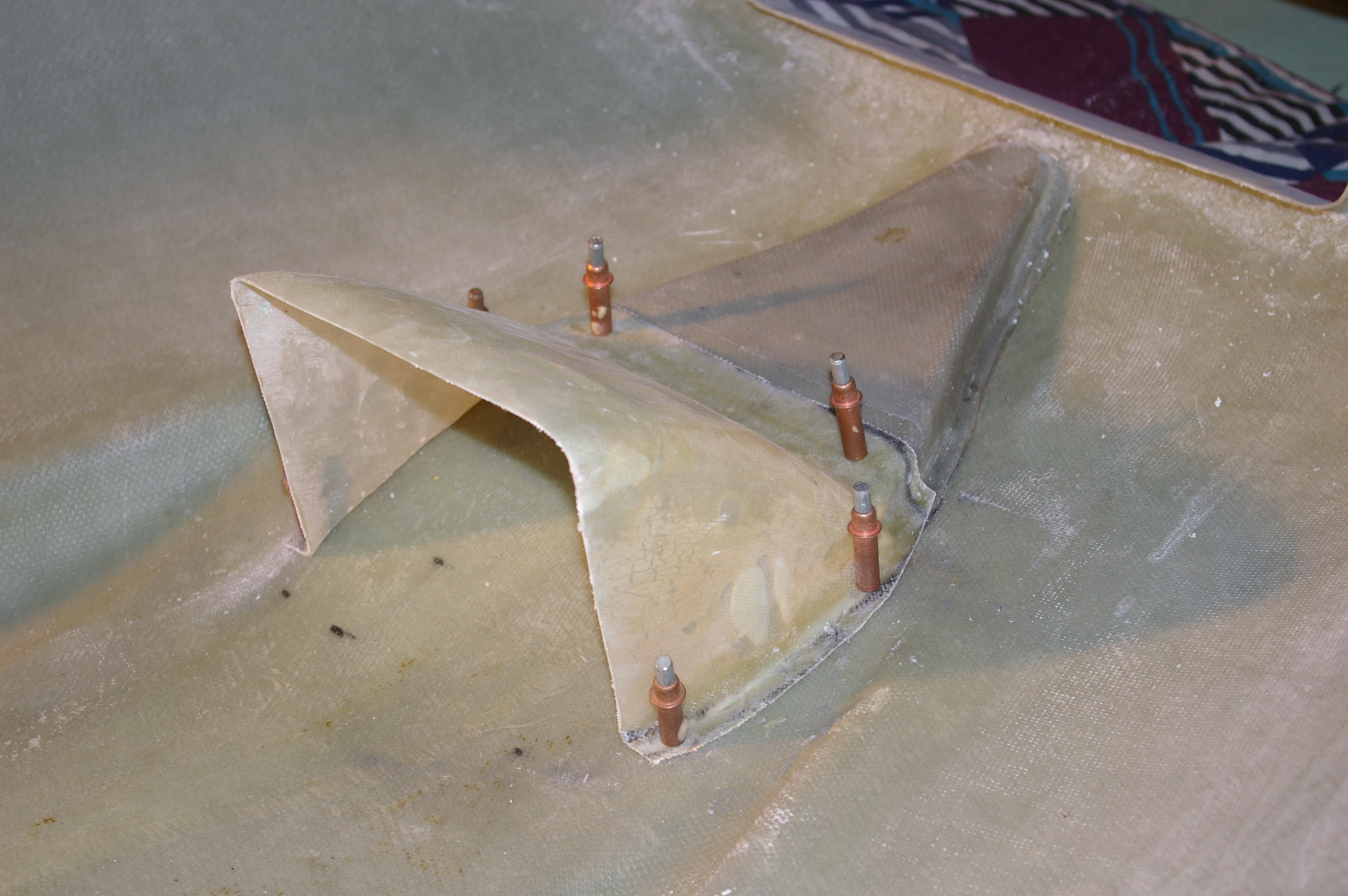

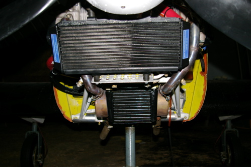

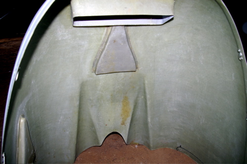

Posted: Thu Nov 30, 2006 12:25 pm Post subject: Re: CZAW cowl question again |

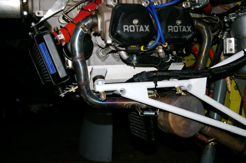

Finally, some pictures of my installed cowl for anyone who wants to have a look and comment:

Here are some pictures of the oil cooler plenum. Basically it's an extension to the air inlet on the bottom of the cowl. I'll be doing the final fitting and sealer trimming tomorrow at the air strip.
