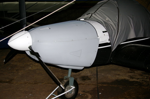

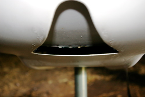

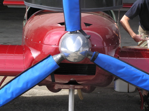

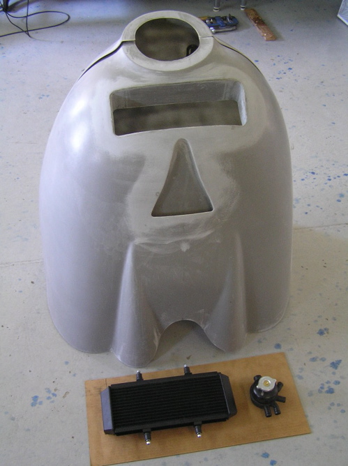

PostPosted: Wed Nov 29, 2006 2:21 pm    Post subject: Re: CZAW cowl question again Reply with quote
Here's the picture of the CZAW cowl I mentioned. Notice the oil cooler inlet on the bottom. The opening at the back is only 3/4". Since it's on an upwards angle when installed, cutting the "roof" of the inlet will make for a wider opening to allow more air in.
I've also attached another picture of a red 601 with the same cowl and the lower inlet seems to be missing much of the so-called "roof". You can clearly see the oil cooler in there.
Any thoughts?

PostPosted: Wed Nov 29, 2006 2:31 pm    Post subject: CZAW cowl question again Reply with quote
Remember, the 260F reading is taken from a location where the oil is HOT after gone through the engine. Newer 912's take the reading at the oil pump after it's gone through the cooler. Bound to be colder but I don't know how much...
Yes, I suppose I can cut the roof of the inlet a bit to make the opening larger by virtue of it being more "forward" because the inlet is on an upwards angle. I have posted pictures on the forum so everyone can see what I'm talking about.

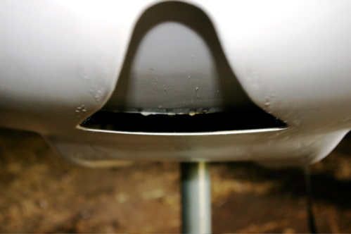

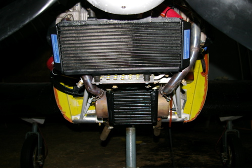

PostPosted: Thu Nov 30, 2006 12:25 pm    Post subject: Re: CZAW cowl question again Reply with quote

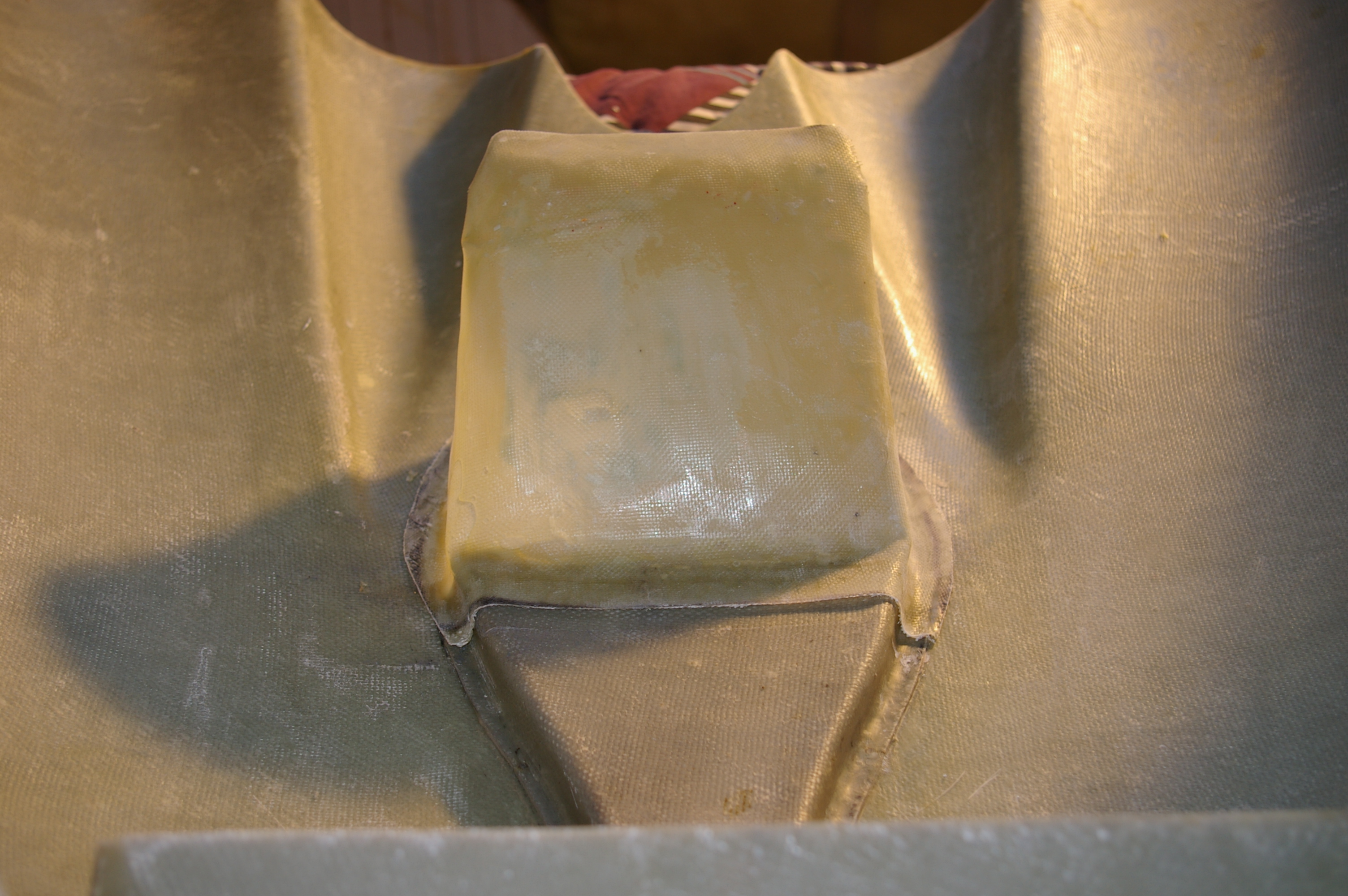

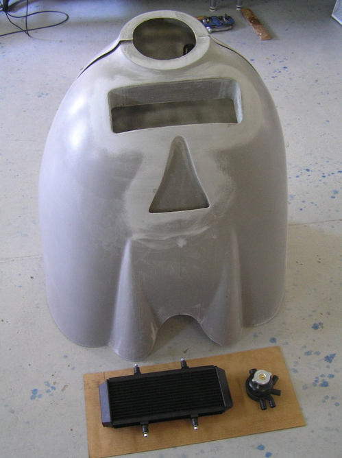

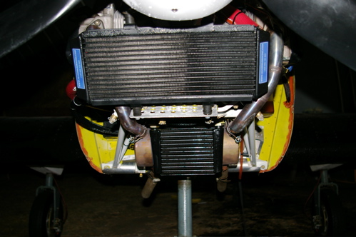

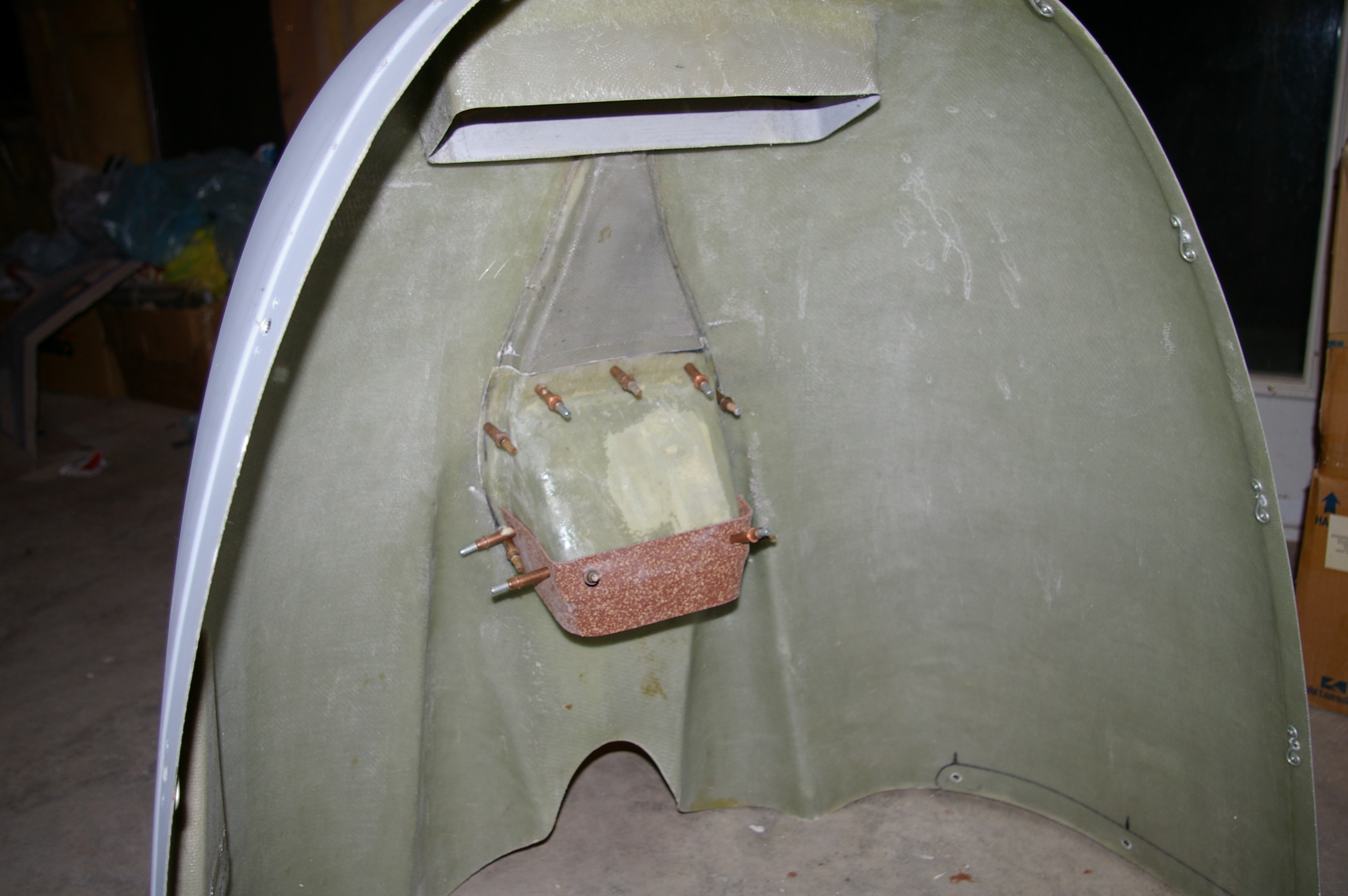

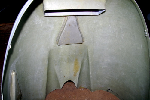

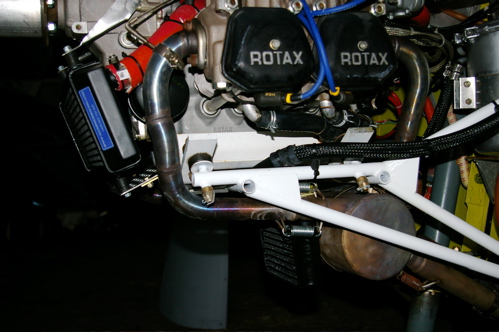

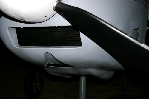

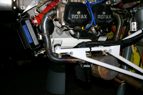

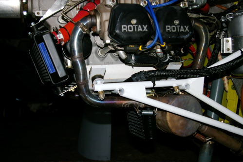

Finally, some pictures of my installed cowl for anyone who wants to have a look and comment:
Side view of the engine showing the oil cooler mounted in front of the muffler
 Filesize:  89.31 KB
 Viewed:  572 Time(s)
Shot of the main rad on top and oil cooler on the bottom
 Filesize:  82.11 KB
 Viewed:  530 Time(s)

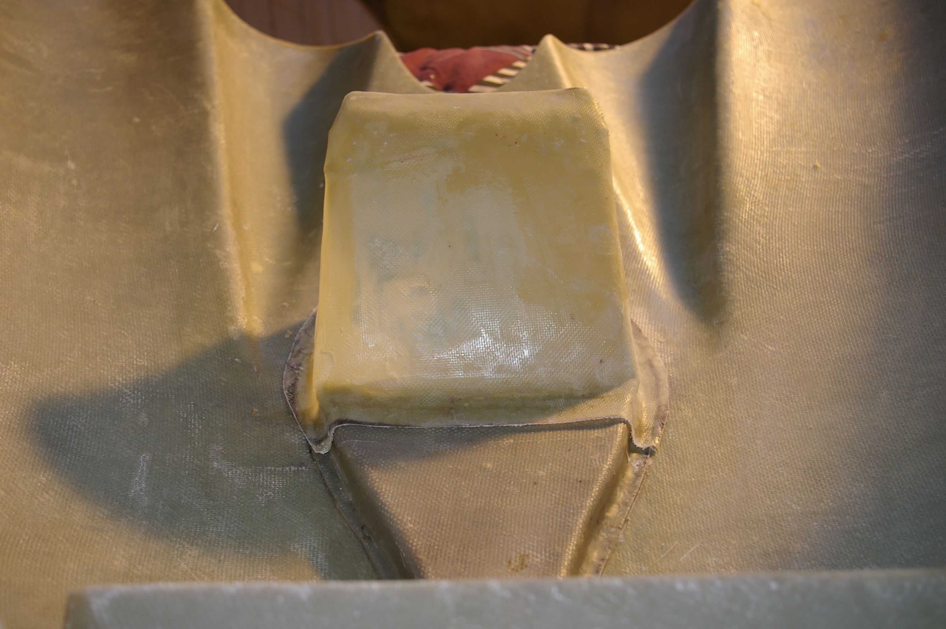

Backside of the cowl showing the oil cooler duct. The oil cooler sits a good 5.5 inches behind the end of the duct
 Filesize:  68.94 KB
 Viewed:  545 Time(s)

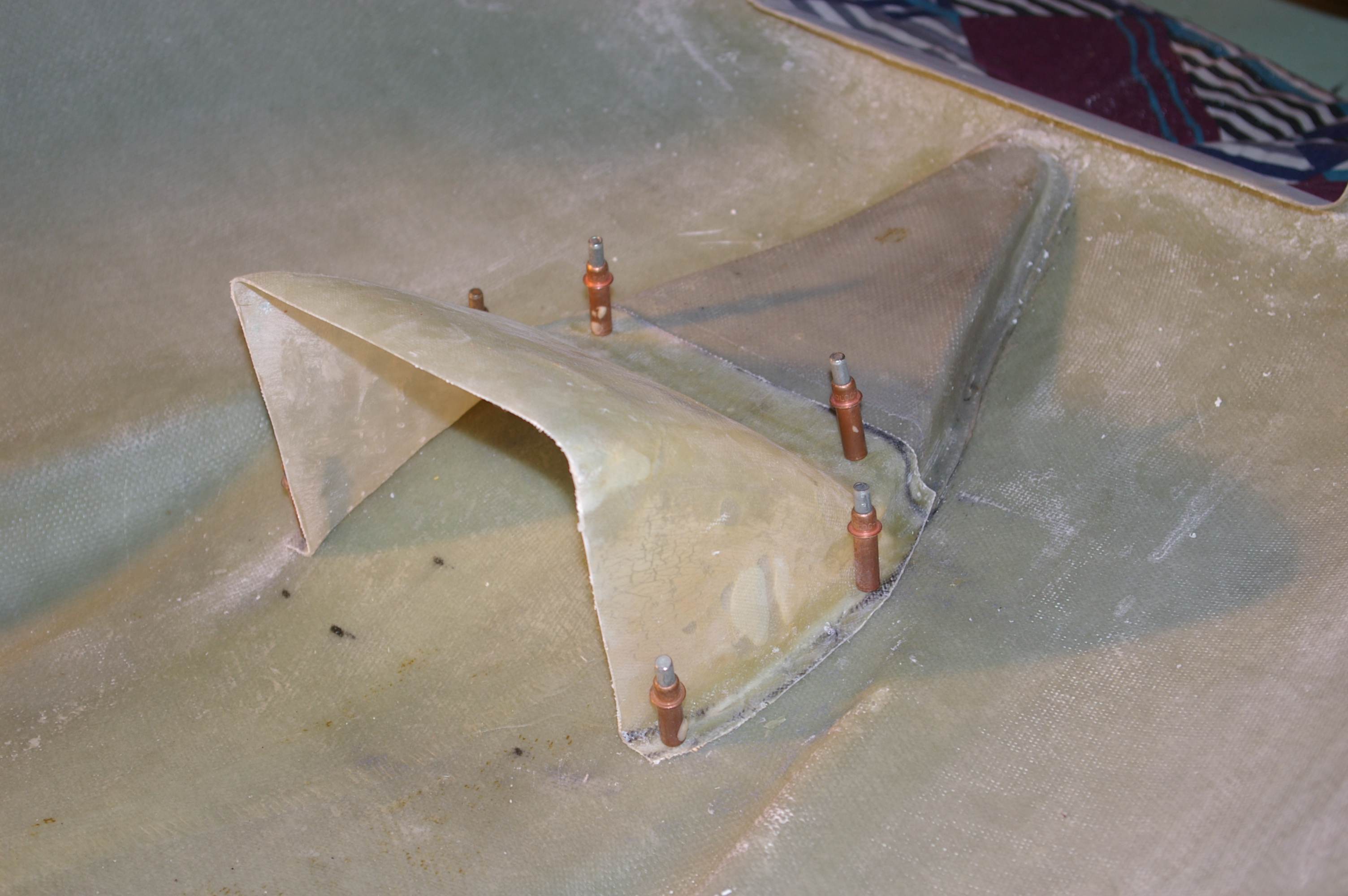

close up of the inlet. Notice how thin it is
 Filesize:  45.53 KB
 Viewed:  540 Time(s)

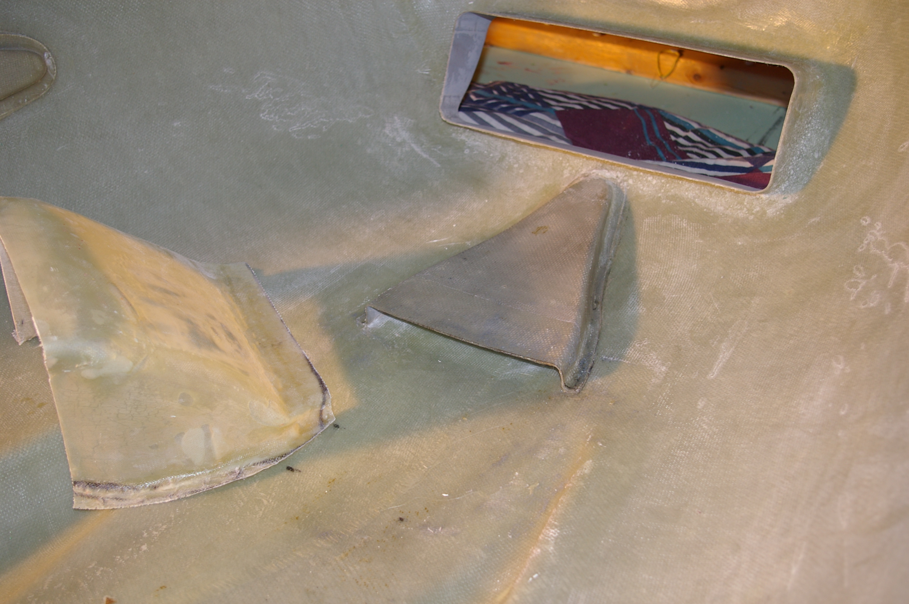

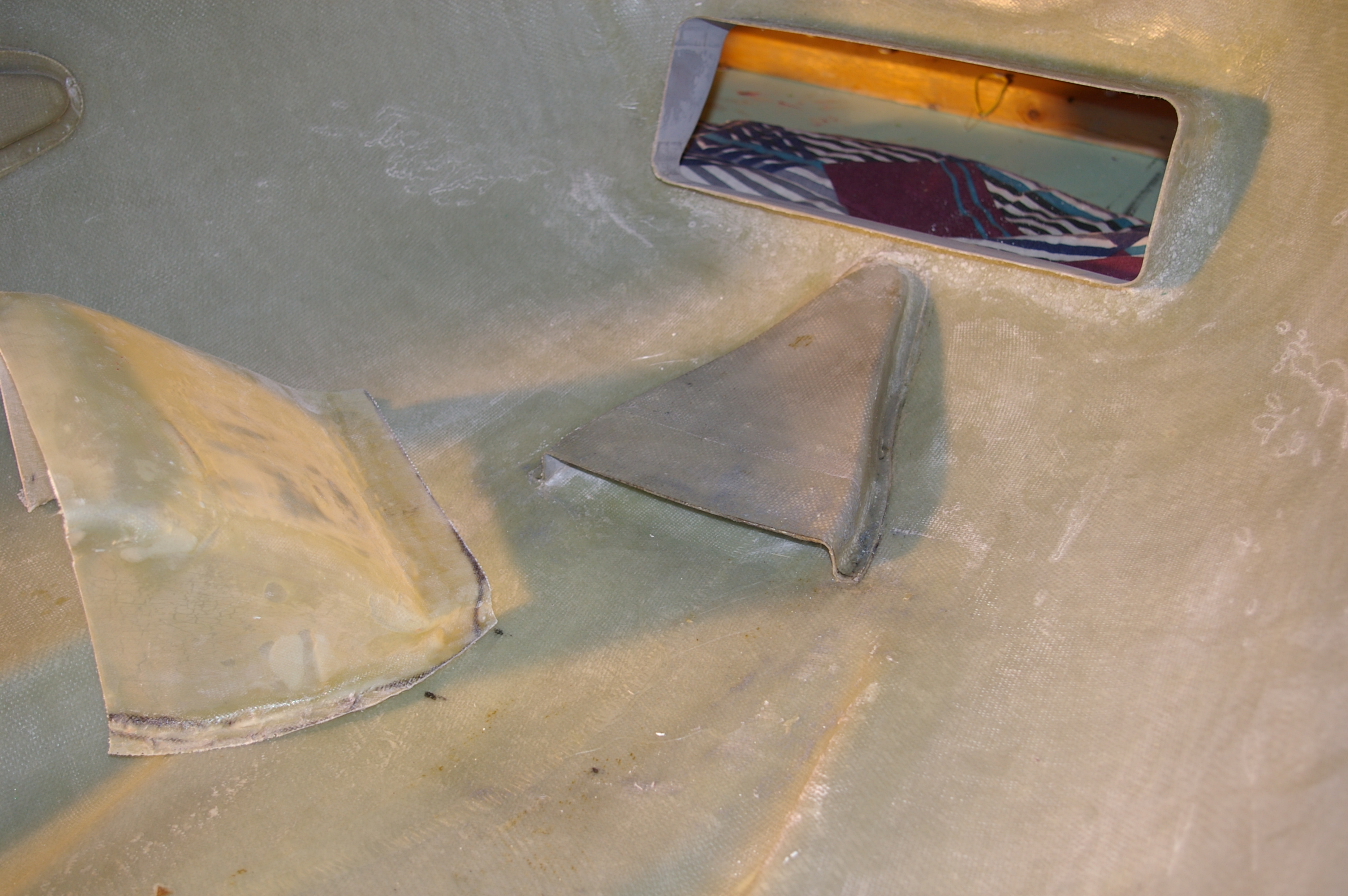

Oil cooler inlet
 Filesize:  45.35 KB
 Viewed:  525 Time(s)
cowl installed

I spoke to CZAW about the availability and so far they're still more than happy to supply kits and parts for 601s considering the firewall-forward system of their SportCruiser is identical to the 601 system they developed.
On another note, I took some detailed measurements of my oil cooler and placement and wouldn't you know it.. they are all perfect according to this article I found:
http://www.ch601.org/resources/cooling_systems2.htm
Looks like maybe the folks in the Czech republic we're doing their homework! Even though the placement, inlet size and distances are right I still have to make up a plenum of sort to funnel the air into the oil cooler but It's worth a try. I reckon I can whip that up in a few hours of glass work.
It seems this cowl has gone through a number of changes over the last few years and mine is the latest iteration.

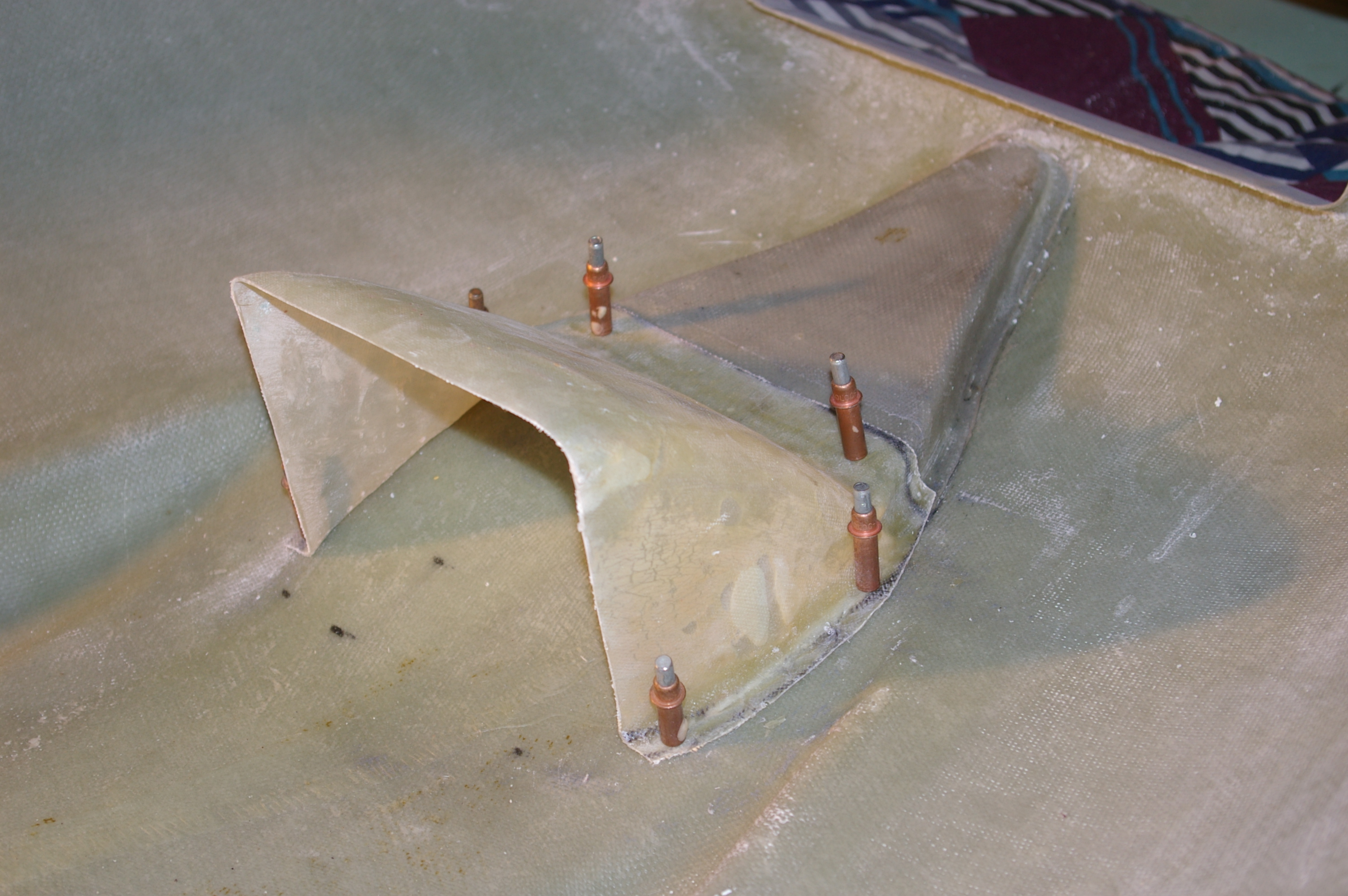

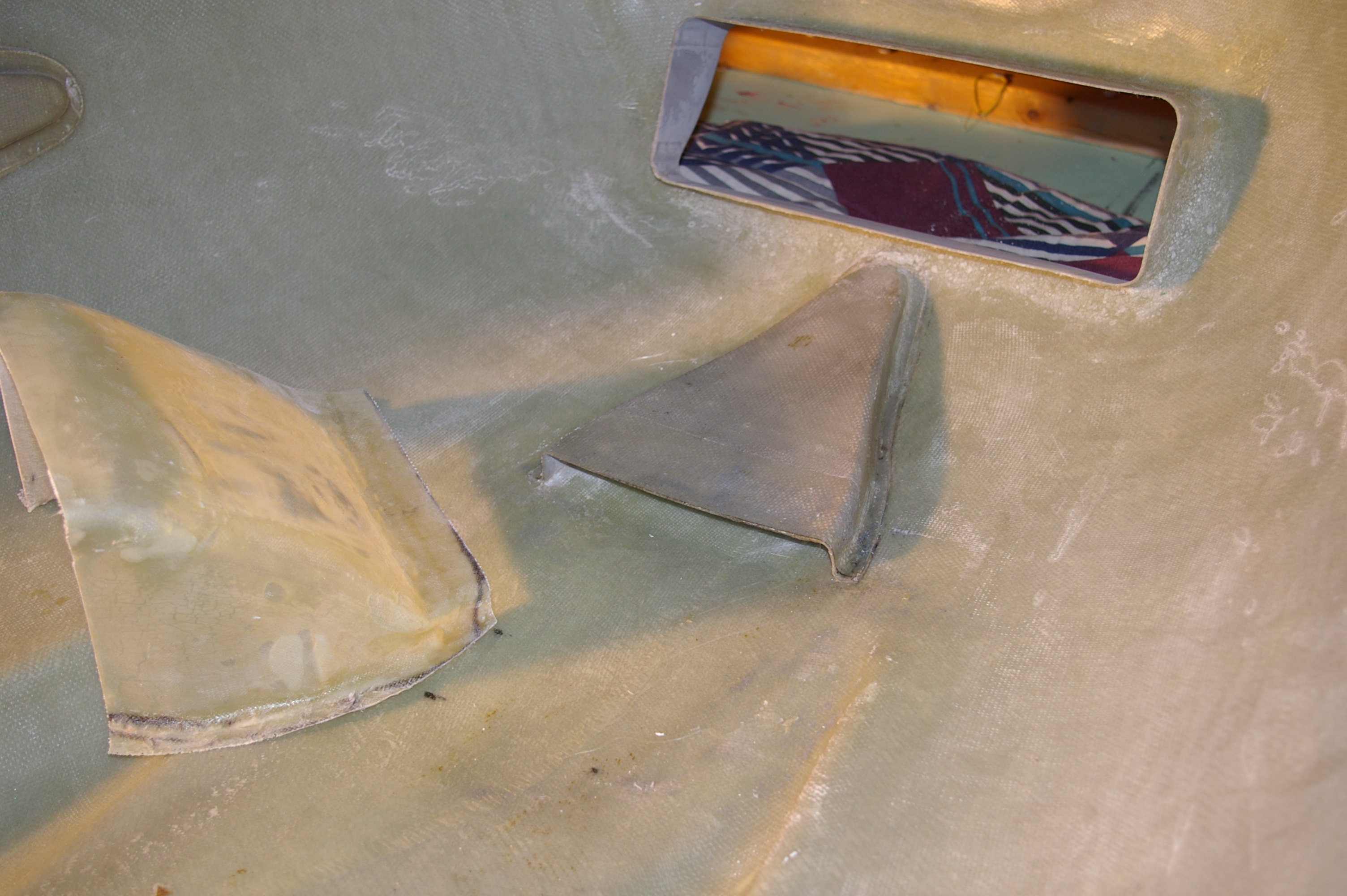

PostPosted: Fri Dec 01, 2006 6:53 pm    Post subject: Re: CZAW cowl question again Reply with quote
Here are some pictures of the oil cooler plenum. Basically it's an extension to the air inlet on the bottom of the cowl. I'll be doing the final fitting and sealer trimming tomorrow at the air strip.
 Filesize:  1.67 MB
