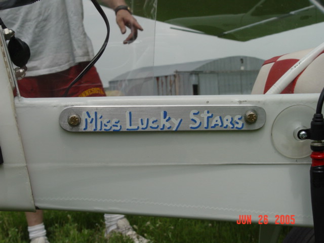

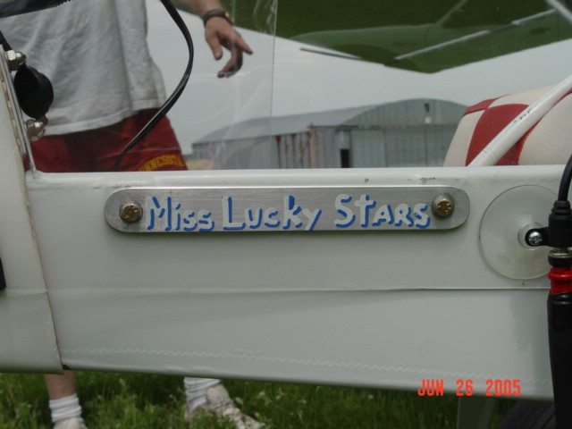

I'm tellin ya, part of the problem is you call your plane a "HE" instead of "Miss"..........
Gotta Fly...
N381PM ( Miss Lucky Stars )
When I'm flying....I'm thanking my "lucky Stars"

Yah, I know, Mike, but remember me waffling about it a year or 3 ago ??
There's certainly nothing feminine about this contraption, so I figured I'd
follow the Russian custom. Smile
