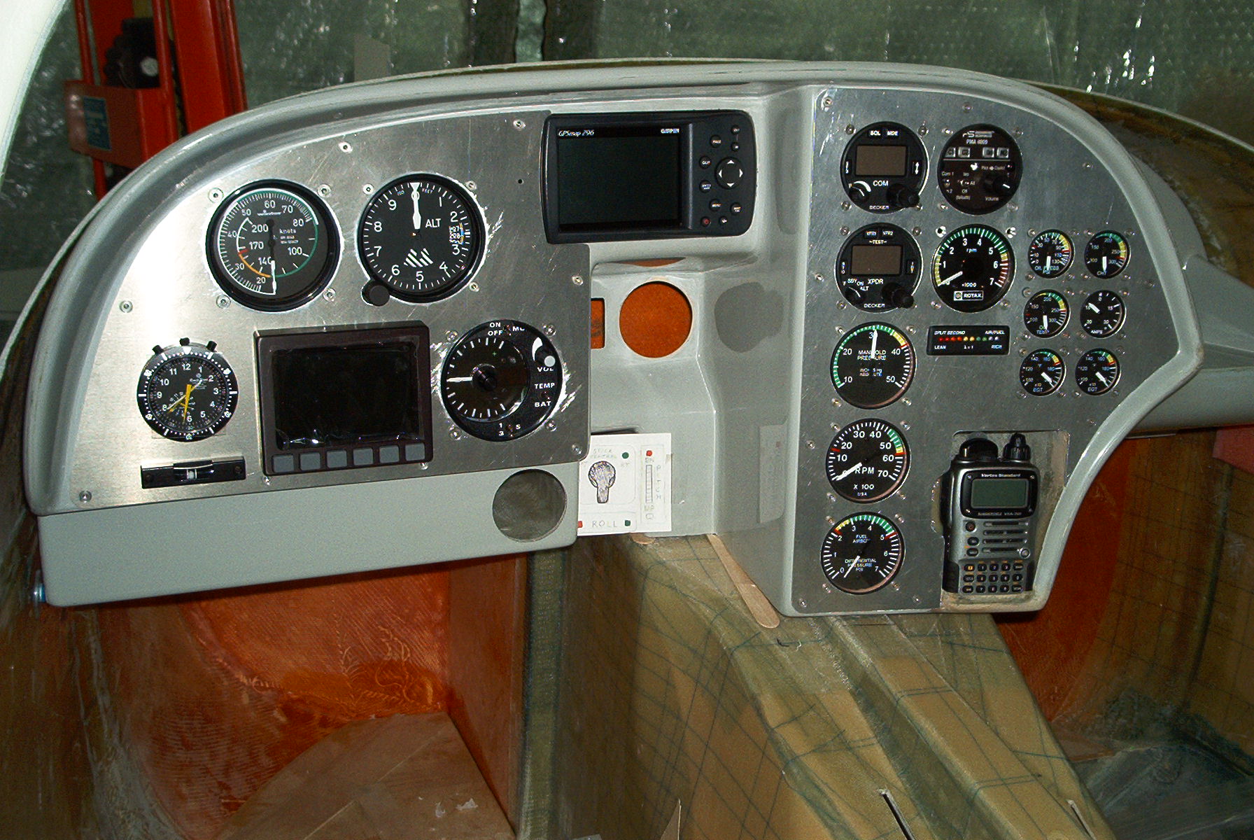

PostPosted: Mon Dec 11, 2006 10:19 am    Post subject: avionics cut outs Reply with quote
Hello Ian
I agree that traditional machining of panel is a viable means of
accomplishment. Once laid out, a flycutter works great. I takes just a bit
of diddling to get size correct, but once it is, do all those hole sizes.
If you are not doing all at once, flycutters are fair cheap, just buy 1
for each size and don't bother adjusting.
We got our panel cut first try on both, I tried to attach a pic.
We laid out entire panel with full sized copies of instruments to make
sure all fits as a first pass, then machined the trouble spots first which
dictated where the remainder will be placed.

Ron,
Good photograph of your panel. I see you have the Becker xpndr and radio.
That is what I put in my plane and have been nothing but happy with them.
I'm surprised more people aren't using them. they're compact and I am told
have a good reputation.
Steve Hagar
