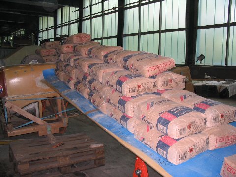

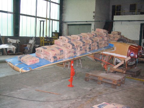

Wing Load Tests are a part of the German Builders Regulations.
Each Side in steps of 350 kg, 700 kg and at least 1350 kg.
The load spread is definated. Please see pictures.
I wish all of you a Merry Christmas, a good jump into the next year and a lot of great flights.
Bruno Reith

Just a couple of quick question.....why the jack stands under the center of the wings? When in real use is the load that the wing is subjected to in...let's say a pull out from a steep dive at MTOW, just as unevenly distributed along the wing?
Mike,
My guess is they are there to prop the airplane while loading the cement
bags, lest the airplane topple. And they are then cautiously lowered.
Gilles

PostPosted: Sun Dec 17, 2006 5:54 am    Post subject: Vne Speed / Wing Load Test Reply with quote
Wing Load Test
We use the jacks with a wooden bar and something soft on top to spread the load, when putting the cement bags (25 kg each) on the wings. Than we lower the jacks, so that the wings are free and measure the movement of the wing tips.
Lift up the jacks again for supporting, put more load on the wings, lower the jacks again and so on.

How do you support the fuselage in the middle?
