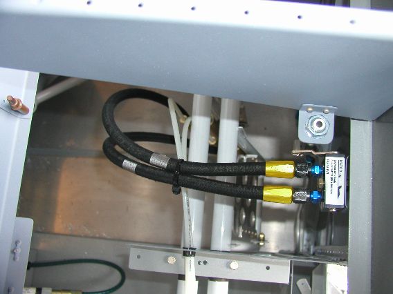

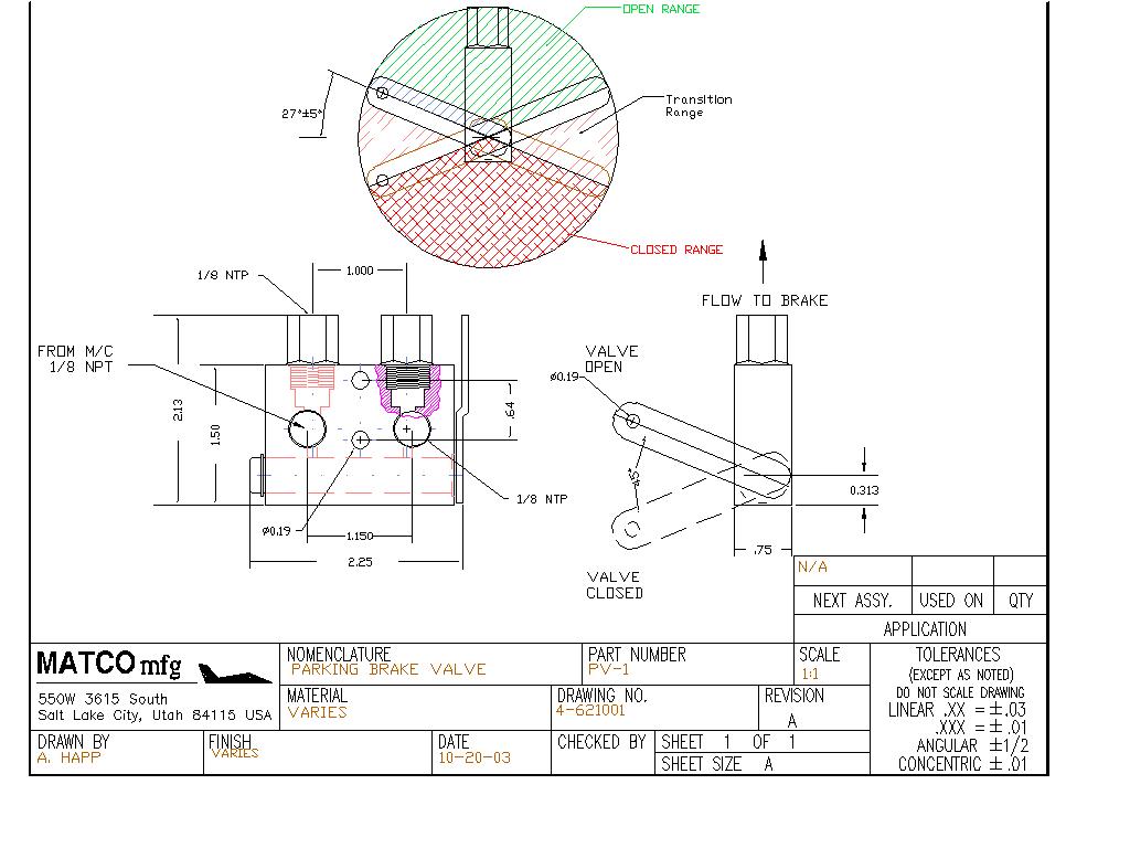

jim-bean(at)att.net wrote:
All,
I installed the catalog parking brake valve on my RV-8 but never figured
out how to use it. At first I thought that I could use the little handle
by itself. Unfortunately this dream resulted in an almost serious
accident when the tiny mass of the tiny handle caused it to jiggle into
the closed position. When this happens the next brake application locks
the brake. Surprise! At the moment the handle is tie-wrapped into the
open position.
My post is to ask how others have fabricated a linkage to operate it
properly. Simply putting a control cable on it results in reversed
operation, IE pulled out would be off. Any ideas?
Jim Bean
43 hours now on N99JA

The valve operates by trapping the fluid after you apply the brakes. Apply
brakes, close valve and fluid and pressure stay put assuming no leaks.
Position the cable so pulling it closes the valve. Use a ratcheting or
locking cable so it will stay in either the open or closed position.
Greg Young - Houston (DWH)

PostPosted: Tue Dec 19, 2006 12:19 pm    Post subject: Parking Brake Reply with quote
You can also set the valve to the closed position and then apply the
brakes. It is basically a check valve with a small cam to push the ball
off of the seat for normal operation. This is why it just rotates
around in a circle.
I fly to West Texas quite a bit and it's sure nice to have that parking
brake when you're trying to fuel up in a 35 knot wind. It's a good
thing it was blowing right down the runway. I got home fast though. Smile
I also installed a spring in case the cable were to "come from
together," as a Cajun friend of mine once said. Smile
Here is a picture of my installation. The position of the arm is open
and it now has a spring holding it in that position and a cable that
pulls it toward the camera about 90 deg. Like Greg suggested I used one
of those small cables with the locking push button in the middle.
http://www.myrv7.com/viewimage.php?pictureid=328
Godspeed,
Phil Birkelbach - Houston Texas
RV-7 N727WB
