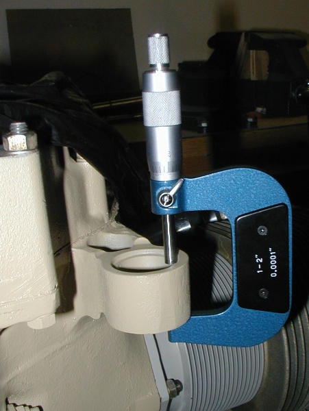

Among other airplane projects I am involved in. I'm 1/3 owner of a
first issue (1959) C-150. We are rebuilding it's O-200 which is on a stand
out in the garage, is that "easy access" or what? Attached is a pic. Is
this the measurement you are seeking? If not, please clarify and I can step
out and try again. With my finest "Chinese" micrometer, I think you can see
in the pic the measurement is 1.021". This is measuring a coat of paint on
each side as well. If you need more, just ask. What Franklin do you have?

mtherr(at)yahoo.com Guest
Posted: Mon Dec 25, 2006 4:49 pm Post subject: Continental O-200 Engine mount point |
Ah! You make my day...
It appears you have measured the thickness of the
inner portion... what about the outside dimension? (I
think this is where the seat sits).

n4546v(at)mindspring.com Guest
Posted: Mon Dec 25, 2006 8:28 pm Post subject: Continental O-200 Engine mount point |
what about the outside dimension? = 1.225"
