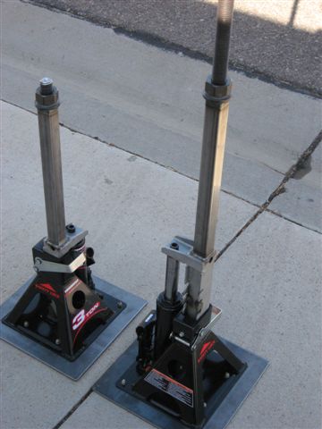

picture of the jacks for the RV10. Note that although they think of the jackpads of having a .5" diameter it is actually .7". we will need to enlarge the cup in the end of the threaded rod. a 12" threaded rod allows these jacks to range from 27" low to 42" high. lift from starting position is 8+". Note that they have a mechanical lock to protect against hydraulic failure. do not archive.

Nice engineering. Thanks for the pictures, those are really cool.
