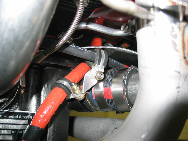

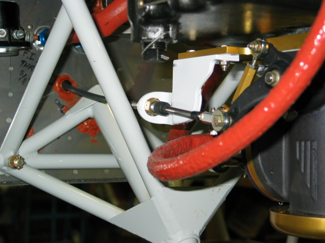

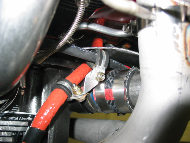

PostPosted: Thu Dec 28, 2006 7:13 pm    Post subject: Fuel Injection Line Run Reply with quote
Hi Marty,
I have the AFP fuel injection vertical system. I ran my line
from the spider down thru the baffle and then back above the inlet pipes
and then around the sump and down to the controller. I had to provide a
support where it turns from the rearward direction to the center and
downward direction. I can do some pix if you want. I'll attach some
that I already have. I found that the AFP lines were too long. I had
them provide a 45 deg. fitting and then I cut the line from the fuel pump
to the controller so it had a smooth run to the controller. The 45 deg.
fitting allowed the line to clear the tri gear mount and go nicely to the
controller.
The "battery and fuel line cable support" pix shows how I
attached the line as it came down from the spider and ran it rearward.
The "throttle cable bracket---" pix shows the hose coming from
the spider that was repositioned via a adel clamp at the back end of the
throttle support bracket. The line now runs along the gold / white
interface of the two brackets thru the adel clamp where it then turns
toward the center and then down to the fuel controller.
Maybe this will help. Lengths of hose partly determine where the
lines will run. I tried to keep them away from the exhaust system as
much as possible. I'll probably put heat reflective aluminized tape
around the critical areas where it comes close ....
Jim Nelson
