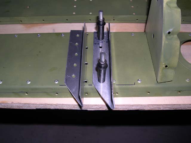

Is it a bad idea to leave a hole that was drilled for a rivet. I did the layout but managed to pre drill a hole where I am unable to put the rivet because the 7H2-6 bracket will be sitting partially on it.
If it isn't is it possible to move the 7H2-6 Bracket at all to accommodate?

Countersink the hole and put a rivet in with a flat head. Re-install the
bracket over the top. Life is good.

Do not move the location of the 7H2-6 bracket. It's position is critical to mount the stabilizer. As a side note, I am not sure what revision you are working on, the newer plans use .063 instead of .040 for the 7H2-6 brackets. If you have the .040 this would be a good time to upgrade them.

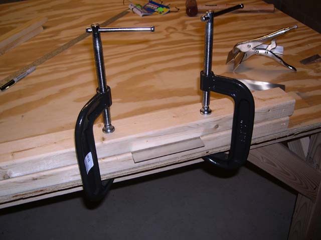

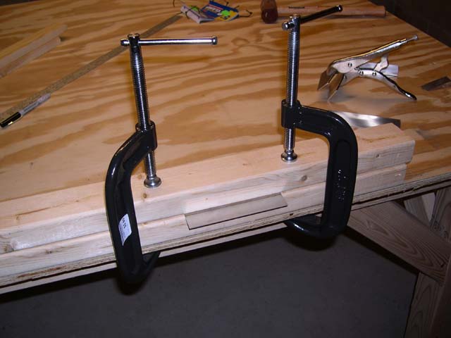

This is a good tiume to purchase some .063 material and make your own brackets. It is relatively simple if you have a small brake. The new brackets are $14.95 each plus shipping. A 2' x 4' sheet of T6 cost about the same and then you have some left over. I learne d this from this great forum! Thanks!

I agree; change them now to .063. I made my own, and I didn't even need to use a break. I sandwiched the piece between two short 2x4's, and bent it over with a rubber mallet. The radius on the 2x4 was perfect, and I only needed to bend it slightly more after taking it out.  Very fast learning curve also; I only made one bad one.
