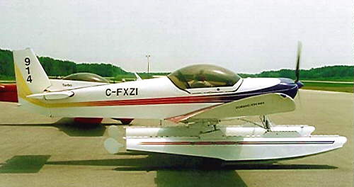

Posted: Tue Jan 09, 2007 4:54 am Post subject: 601 HD with Rotax 914 |
She works like a charm
Mark Townsend Alma, Ontario
