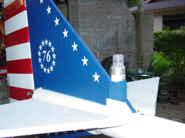

Here's where I stuck mine....I only have one.
Gotta Fly...
Mike in MN

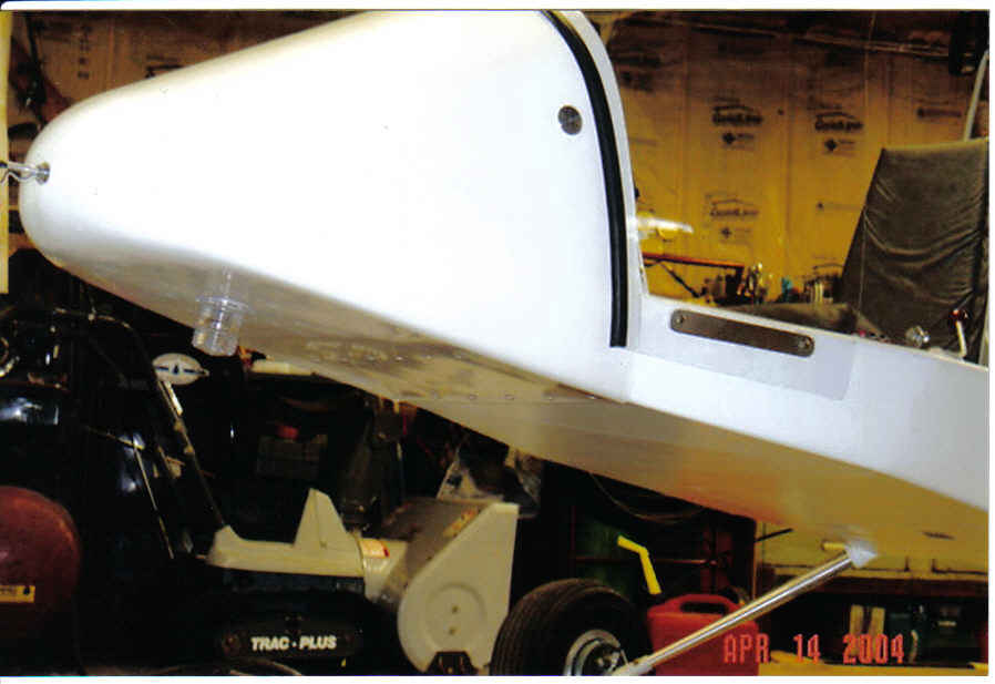

Here's another mounting possibility...This is a Kuntzleman SC-103.
Quiet Beauford
FF #076

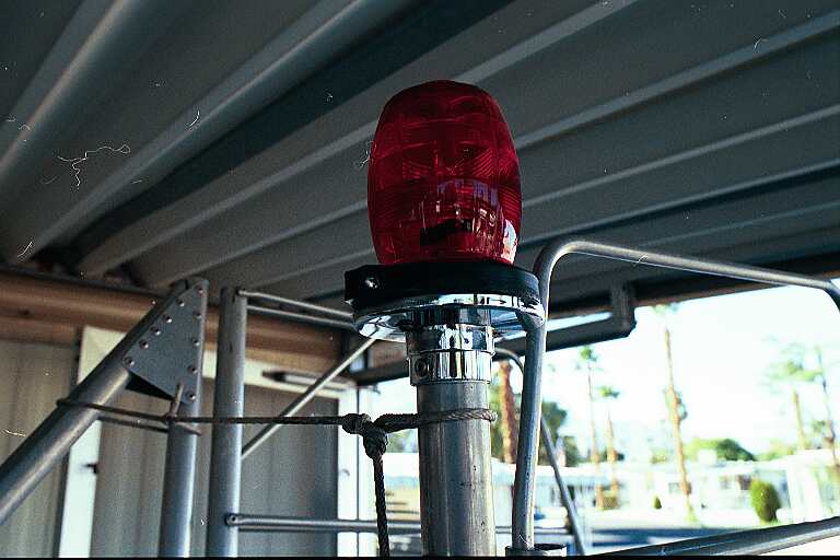

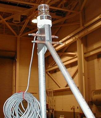

Here's another idea - this one on a Mk III. The red strobe is from Aircraft
Spruce, the chrome mount is a shower pipe cover from Ace Hardware.
Lar.

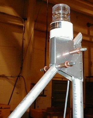

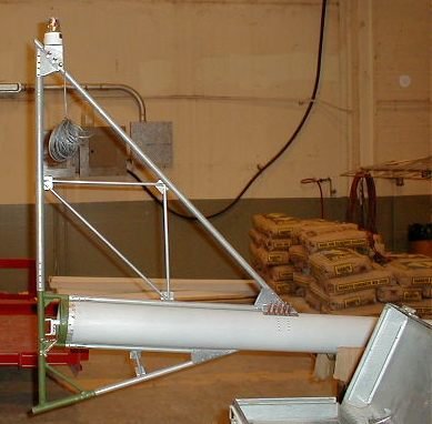

WillUribe(at)aol.com Guest
Posted: Tue Jan 09, 2007 9:51 am Post subject: Where to mount a strobe |

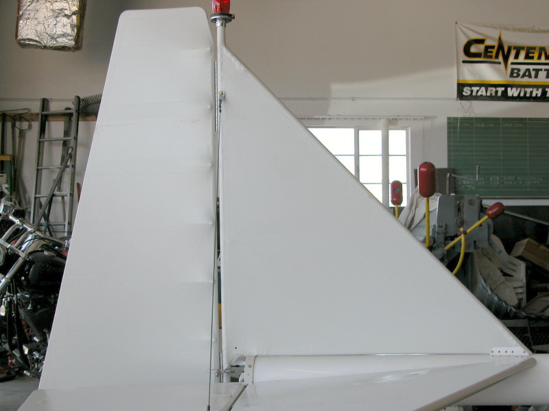

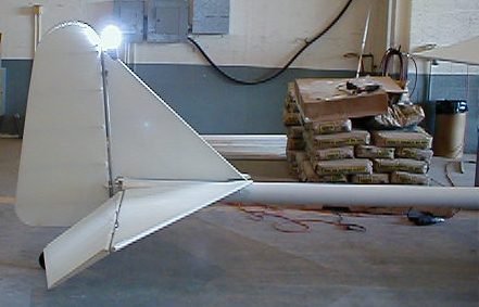

Here is how I mounted my Kuntzleman strobe.
