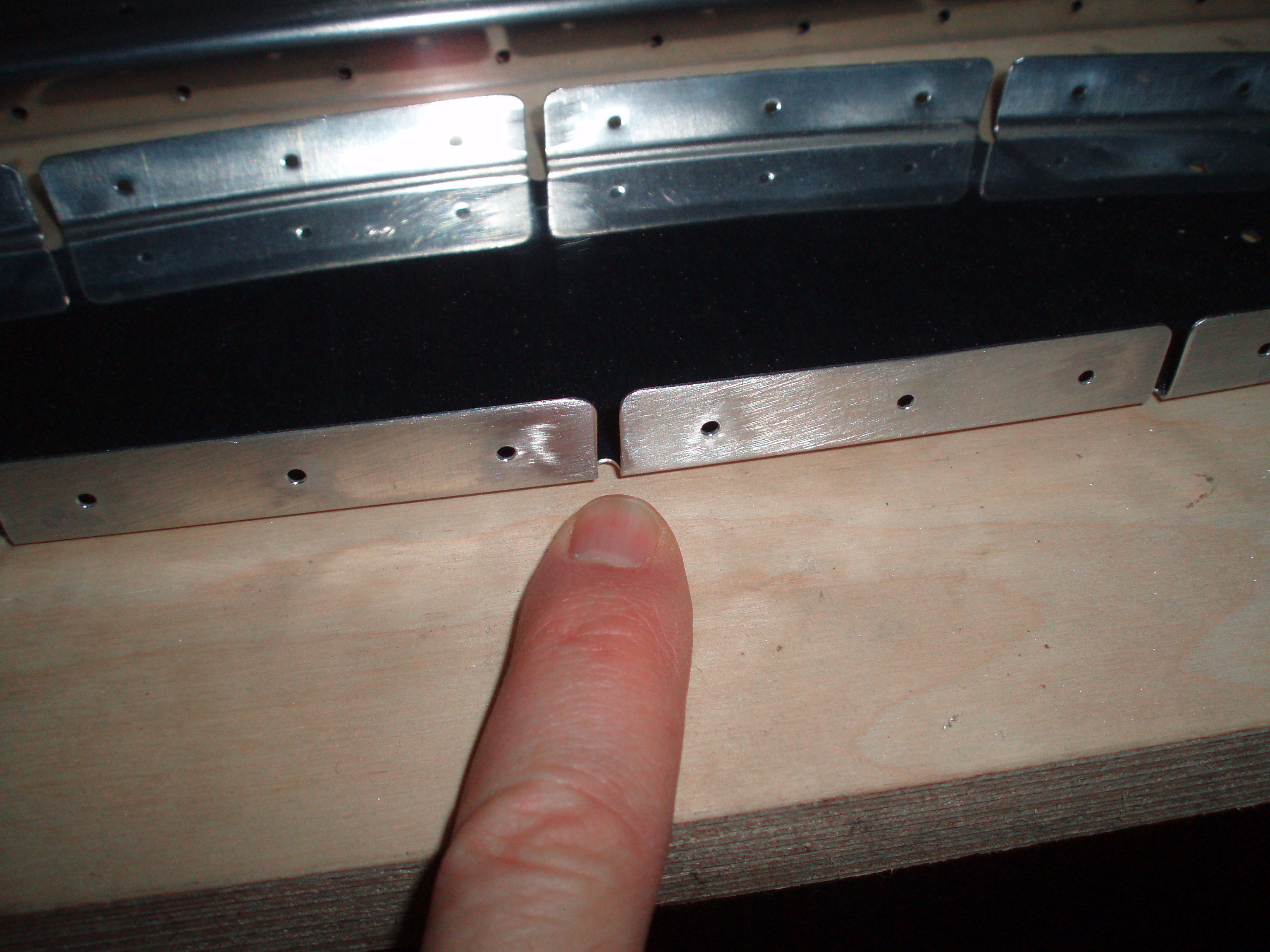

Looked at the ribs for the VS last night.
Alot of head scratching... how on earth am I supposed
to deburr those flange slots?
How have you done it?
Can anyone point me towards that magic tool?
Arthur

I drag scotch brite through folded in half

I learned from the folks at the Alexander Tech Center to do it with the
scotchbrite wheels. Not pretty but fast and effective. Don't know how
I would explain it though. I'm curious what others do too.

I do that to the outside... you get the inside?

Get one of those black emery boards with the cushioned backing at the
pharmacy. They work great. Each side has a different coarseness. The round
part of the flange can be down done with the deburring blade tool.

I am getting some emery cloth strip (p400) to try, but will have to work out
a good way to hold the parts because you need 2 hands for the strip.....

Lowes sells these mini scotchbrite wheels for Dremel tools and Sears has some cone shaped deburring bits made of similar material. They make quick work of doing the flanges..Hehe....glad I'm done with that task

Try 600 silicon carbide sandpaper on a tongue depressor.

I was able to use a scotchbrite wheel from the outside of the slot to get
most of it, then I used the pads to finish it off.

I think we only hit the outside and touched up the inside with the pad -
it's been awhile.
Since then, I tried the various powered mini-wheels and pad holders but
it looks like John G's nail file pads are the ticket. You definitely
want a couple of those in the tool box.

I think I may have found that magic tool...
3M (of course) do a 3mm thick unitized cut & polish wheel.
Available in 3 diameters 38, 50 & 75mm.
Tried one tonight in a right angle die grinder... seemed to work very well
and quite quick.
Arthur

--> RV10-List message posted by: "arthurww" < arthur(at)cftech.co.uk (arthur(at)cftech.co.uk)>
Ok Mike but they are cheap aren't they?
Especially if you live in the UK. [Wink]

I Used the Cogsdill quite a bit and they were generally ok if you set the tension correctly. They were always a bit fragile though and changing the blade was a female dog. I don’t know if the single step version of the ezburr would be useful because you still need to take the pieces apart in order to get both sides but their standard deburr tool looks greatly improved and much beefier than the Cogsdill.

Checking into it. Stock they start at 3/8". These cutters were designed to use in a milling machine or a very rigid application. I know that builders have had mixed results, some swear by them, some swear at them. I am willing to try it to see if there is a better solution out there. For those that use them, do you still deburr the two sides that are between the parts (inside of the skin, outside of the substructure)?
Mike

If you guys want them, I can supply them. I found that both those and the bristle disks will wear very quickly, thus I didn't think they were a good value. But I am happy to stock anything that is in demand Smile If you would like them email me directly.
Mike
and quite quick.
Arthur

I use the Cogsdill and other than a couple broken blades, really like them. However, I'd sure like some definitive yea or nea on the use of scotch brite deburring-by-rubbing technique discussed awhile back, especially for those using reamers. For those using the Cogsdill, I set my air at 20 pounds and it seems to produce a just right rotation for the drill. I'm using a Sioux. If anyone has an opinion on the correct rotational speed, I'd like to know.
John Jessen (he who is about to head back home and a weekend of building)
