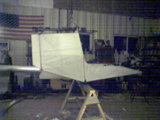

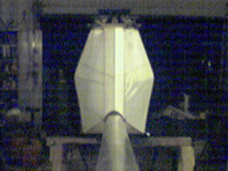

Visualize this then, but I am not the only one that has done something like this to reduce drag
Ellery

PostPosted: Fri Jan 19, 2007 7:03 am    Post subject: Reducing drag Reply with quote
something like
| this to reduce drag
| Ellery
Hi Ellery:
Built the mkIII in 1991 with fabric V tail on fuselage. Lasted less
than 100 hours before prop pulses beat it to pieces. Showed the
problem to Ray Stitts at Sun and Fun 1993. He said the only solution
would be to put fiberglass insulation in the V to soak up pulses and
prevent drumming of the fabric. Other option was replace with sheet
metal, which I did. Used .020 alum. Works great.
We had a V tail on the Firestar, but the 40 hourse 447 did not cause
any damage.

PostPosted: Fri Jan 19, 2007 2:00 pm    Post subject: Reducing drag Reply with quote
Thanks for the pictures. That is a neat solution and looks good. I left
my fuselage open in that area on my Mark III Classic. My thinking was
to get the cockpit air to the prop. I am probably only getting drag.
Vic in Sacramento

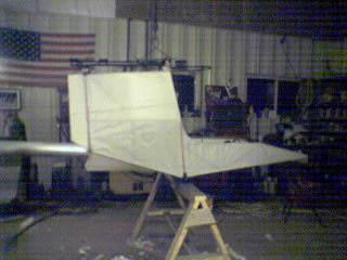

PostPosted: Fri Jan 19, 2007 2:19 pm    Post subject: Reducing drag Reply with quote
This is how we did the Firestar in 1988.
We also placed a belly fabric brace on it same as on my MKIII. It
looks better and helps direct and clean up the air a bit to the prop.
