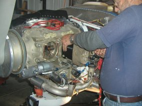

This weekend I swaped out my Superior cylinders and pistons. There was a recall on the cylinders because of soft barrels (the barrels were not hardened properly). You can read all about it on their web site: http://www.superiorairparts.com/index.asp
[img]cid:part1.09070205.04070502(at)charter.net[/img] [img]cid:part2.01080204.05000704(at)charter.net[/img]
