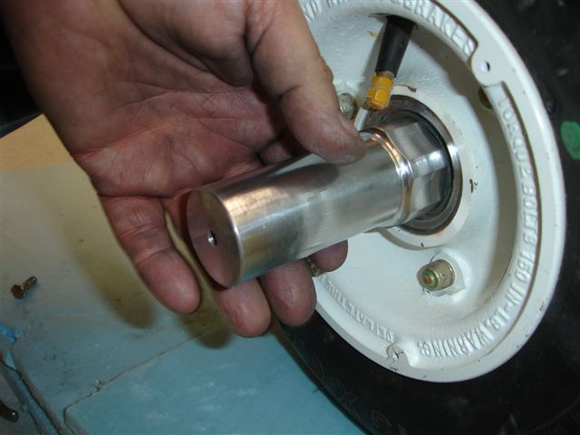

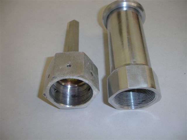

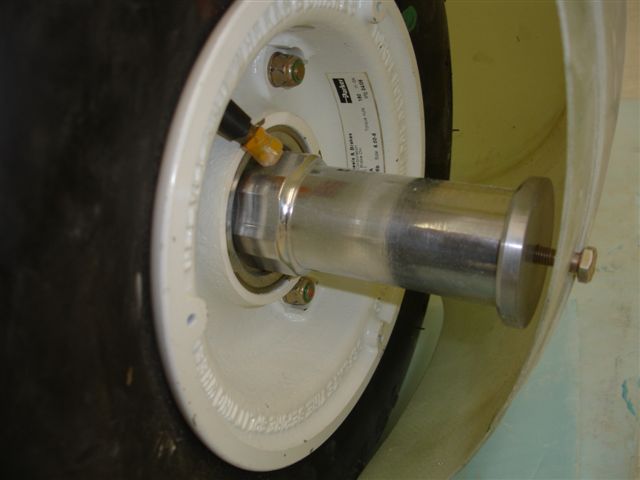

Here is another solution to the Axle Extenders for the wheelpants on the RV10. Since the Vans supplied extenders are having problems in the field, my brother Jim (who is an engineer) came up with a solution.

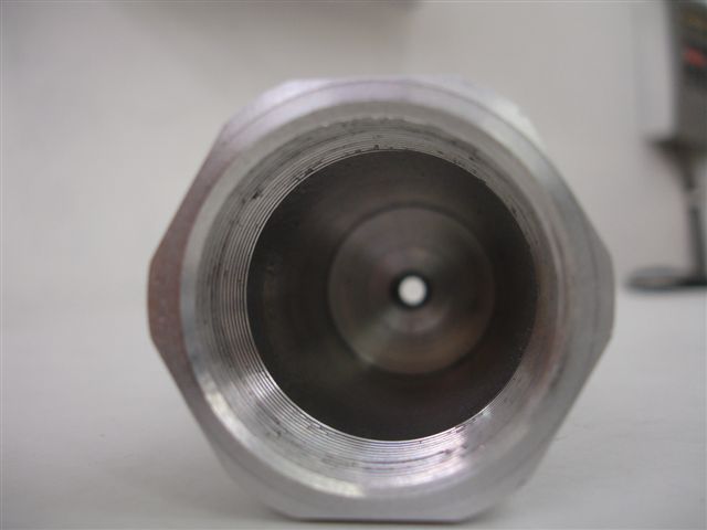

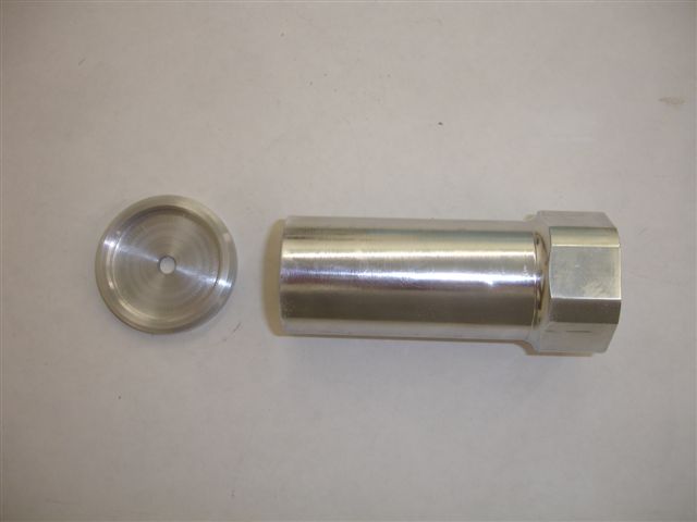

The pics below show his design. The axle extender rod is hollow in the center. This setup is lighter, thats right, lighter in weight than Van's nut and bolt on extender. It doesn't look like it in the pics, but it is! And it's stronger too!
The one piece billet axle rod screws onto the axle. The Capture washer was machine to fit exactly on the axle rod extender and is bonded onto the wheel pant just as Vans has you do with his. The capture washer distributes the loads on the wheelpant with this plug and socket design.

For those of us that have already DRILLED the hub for the cotter pin what would we do? It does not appear your solution has a cotter pin hole drilled into it.

The holes will be drilled in at the same dimensions as Van's cap. These pics were taken literally 1 hour before I posted them. The axle extender was still warm from the CNC. Jim will drill the holes in the production models. They will fit right on!
