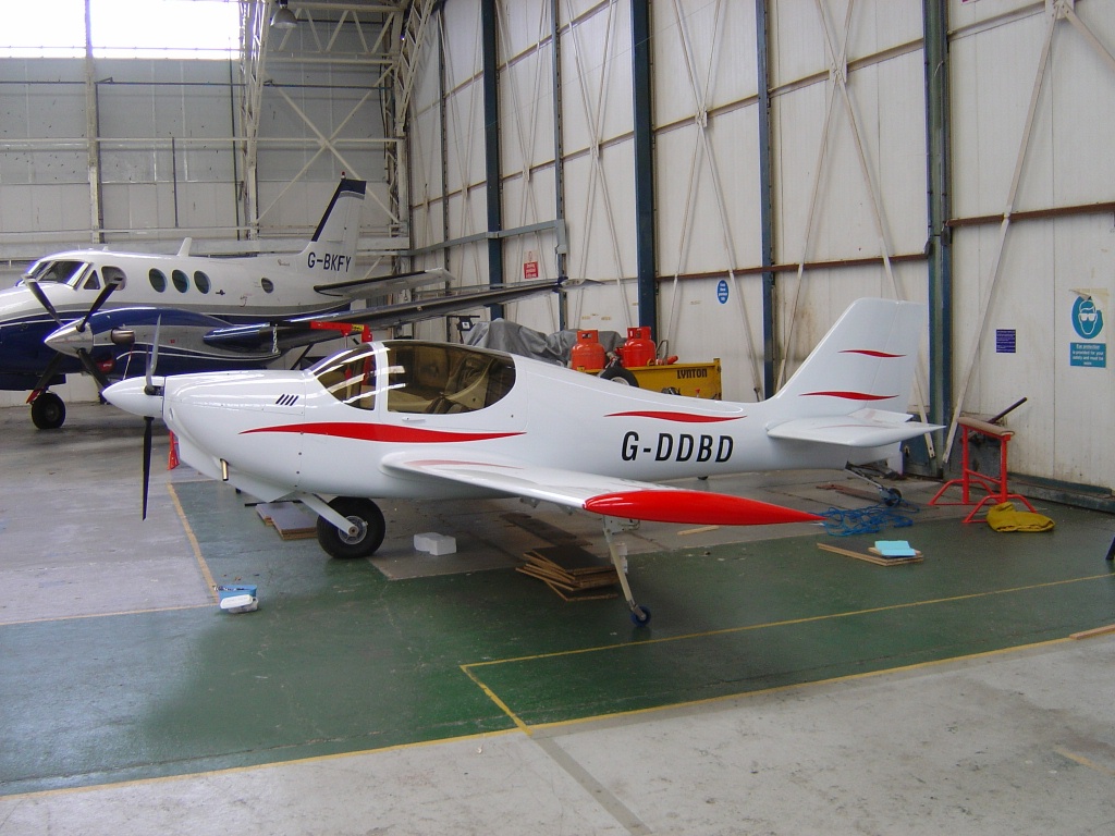

I used the factory registration letters and there has been no problem with
the size. There is a paragraph somewhere in the regulations that gives some
relief on size if it is not practical to fit the full size. The CAA don’t
like the registration on the fin but there are a few aerobatic aircraft
flying around with this location.
Vehicle graphics supply is a very crowded market so you should not have too
much trouble finding a local supplier. I used a small company in Horsham,
my nearest town, who worked off a rough draft that I produced and they came
to my house and fitted the decals for me. My design was simple and just one
colour. There is no doubt this kept the costs down. There were 8
individual decals and the total cost was only UKP 170. I have attached a
picture so that you can see what I got for the money.
I was very satisfied with the result.
