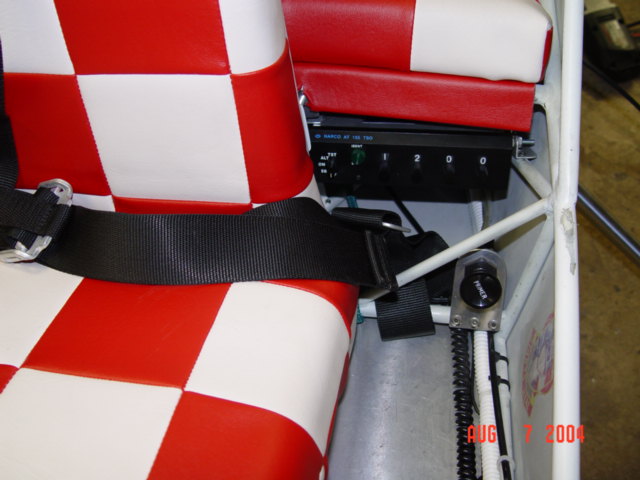

The CHEAPEST I could get mine for ( new ) was around $1,500 for the Transponder & Alt encoder....
http://www.geocities.com/planecrazzzy/LSXXIX.html
I have to have one if I don't want to drive 30 miles away to fly my plane
I'm right on top of class "B" airspace....But with Elec Start....You need a Transponder to Fly within the "Mode C" ring....( beyond "B" )
Gotta Fly...
 Filesize:  58.72 KB
 Viewed:  437 Time(s)
