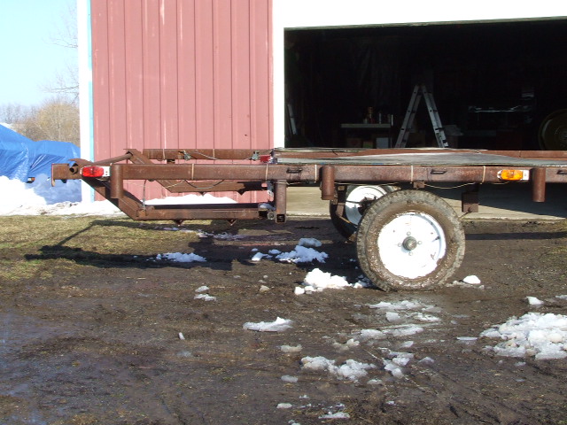

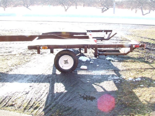

Amid the mud, you are now viewing the right rear section showing the ramps in the up position. This shows the pivot point for the ramps and the pipe locking mechanism. The short vertical pieces of 1 1/2 inch pipe, hold plastic pipe guides for loading on floats when at a boat ramp. I'll put one in place and photograph it later. The left rear view details are identical to the right.

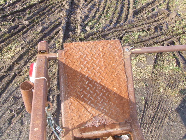

Next is the ramp roll off plate. Just a piece of diamond plate with the end bent down to meet the ground. NOTE that this plate is mounted ON TOP of the support tubing.
At the top you can see where the pipe lock slides thru the end tube and locks into a "U" cut in the side tube. Also, just to your right ,observe the locking pin to hold the lock pipe in place. This is VERY IMPORTANT!
On the lower left is the cable pulley attached to the lift ring. Don't forget to thread the pully mount hole over the mount ring BEFORE you weld the ring in place.
Just to the left of the pully attachment is another view of one of the float tube holders.
More to come. Any questions yet? Regards, Floyd
