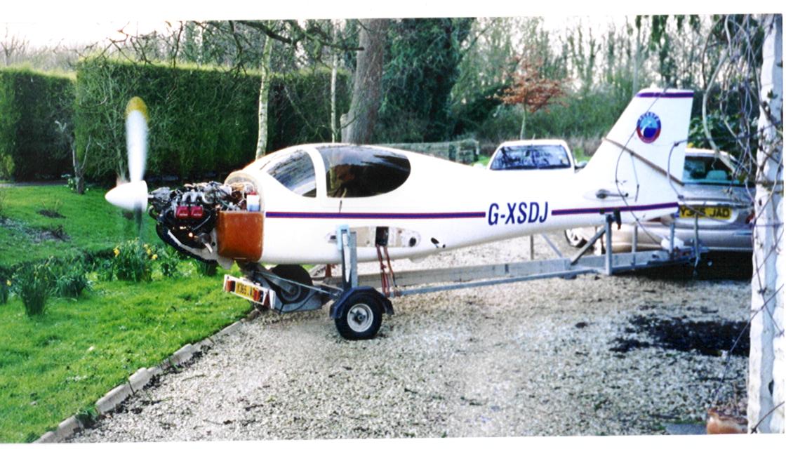

Raimo, I did my engine runs that way including full power tests. No
problems. Picture attached. David Joyce

PostPosted: Sat Feb 24, 2007 2:29 am    Post subject: run up on the trailer Reply with quote
Thanks David,
that looks clear. Europa towed
by Jaguar is a stylish combination!
Did you use some traps through a
spar tunnel to make extra support?
Raimo

PostPosted: Sat Feb 24, 2007 2:40 am    Post subject: run up on the trailer Reply with quote
Raimo, Yes but in retrospect I don't think it was necessary. David
