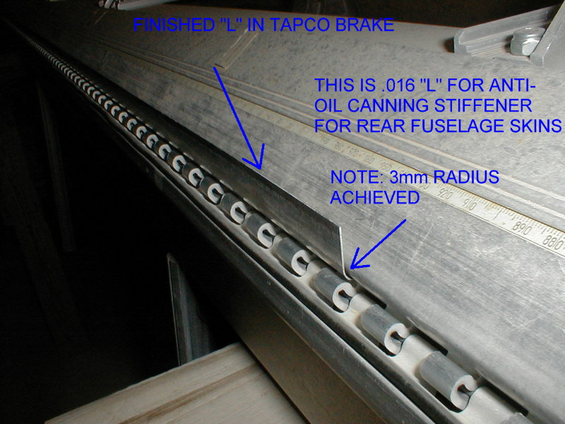

Here is a pic of bending standard "L" on the Tapco house siding brake,
although the "L" in the picture is .016, bending .025" works out the same.
When "scrapbuilding", "L" is nearly free!

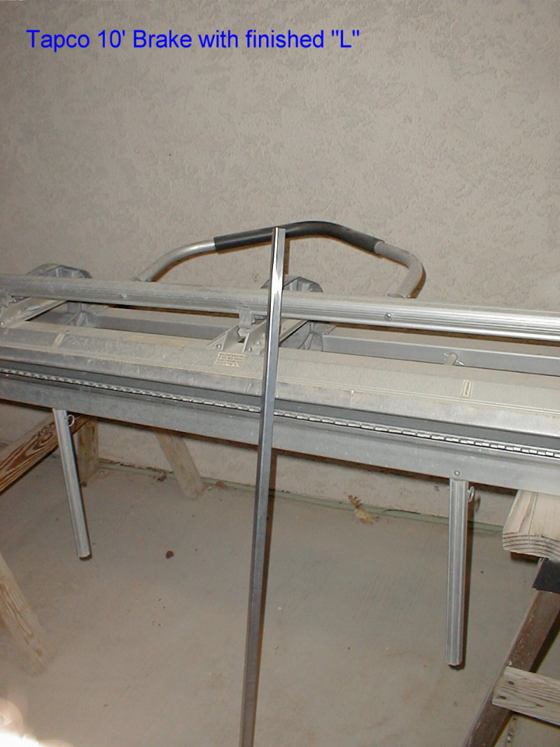

I used the term "house siding brake" because it will also bend "skinny"
steel flashing etc. Attached is a pic of most of the brake with a piece of
"L" leaning against it. I paid $500.00 for the brake used so I could bend
"Free" "L" after I cut the blanks on the $500.00 stomp shear I bought.used.
The Tapco will not bend .040, so I also bought a 8' x .062 (steel)
RoperWhitney used for $1500.00 and had to pay $150.00 for a crane truck to
move it. But the "L" angle I bend is "nearly" free!
Randy L. Thwing Do not archive
