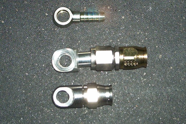

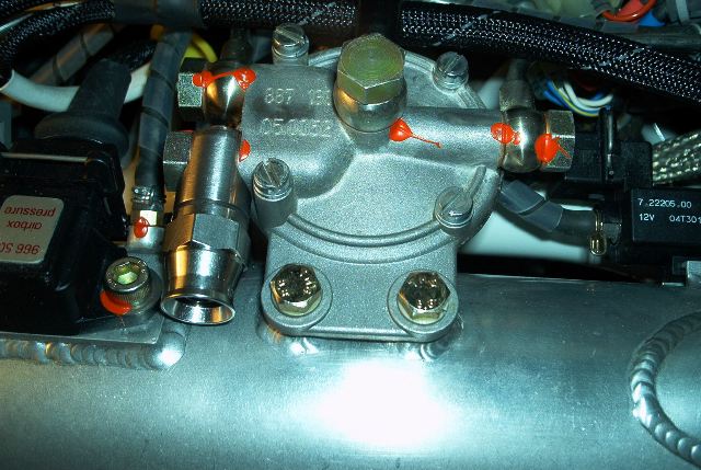

On Tue, Mar 13, 2007, rparigor(at)suffolk.lib.ny.us said:
| Quote: | Completed Home grown 10mm to -6 Banjo for Aeroquip 666 Teflon hose with
conductive lining.
The 666 is smaller OD than other -6 hoses and allows me to plumb 914 from
201B Flowscan senders under Airbrake horn, through firewall between
footwell and UCMF.
Made it out of 416 Stainless, replicating Aeroquips reusable fitting
design.
I used Aeroquip Olive and Nut.
Ron Parigoris

n100rh(at)sbcglobal.net Guest
Posted: Tue Mar 13, 2007 8:20 pm Post subject: 914 Home grown 10MM Banjo 2 of 2 |
Looks like really nice work,
Ralph

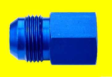

europa(at)pstewart.f2s.co Guest
Posted: Wed Mar 14, 2007 9:42 am Post subject: 914 Home grown 10MM Banjo 2 of 2 |
Ron
Very neat solution. The only other way I can find to get round it is
Speed flow (www.speedflow.co.uk) do 10mm banjo /AN fittings but the
largest is a AN-04 see attached pics. You would need to put a -o6
to 04 reducer in as well - not ideal. At present I'm planning to
stick with the standard banjo and a hose clamp.
Paul
G-GIDY

rparigor(at)suffolk.lib.n Guest
Posted: Wed Mar 14, 2007 10:11 am Post subject: 914 Home grown 10MM Banjo 2 of 2 |
Hello Paul
I searched extensive, could not find anything suitable.
My first thought was to make a 10MM Banjo to -6 adapter. You can see the
middle mock up I hacked out of aluminium. A bit long but would have
worked.
Shorter and lighter is better IMHO.
Ron Parigoris

fklein(at)orcasonline.com Guest
Posted: Wed Mar 14, 2007 7:04 pm Post subject: 914 Home grown 10MM Banjo 2 of 2 |
Ron...you're quite a "hacker"!
Fred
