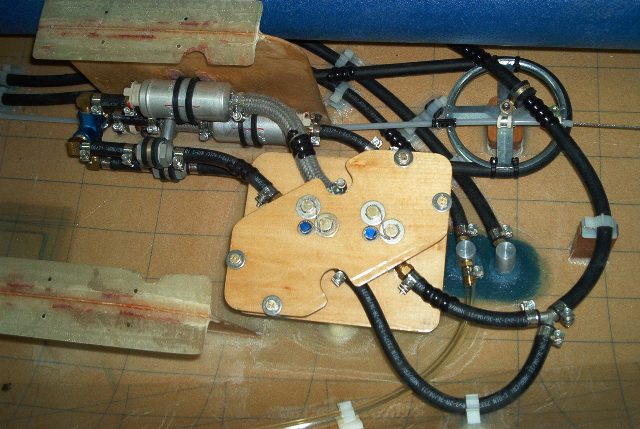

914 Modular Fuel System completed.
Sealed box contains 2 Andiar 375 Gasculators accessible outside aft of
port wing. Pleated filters on 375s have a lot more filter area compared to
Andair Mini.
Design is series with bypass, pump#1 can only draw through Gasculator #1.
Pump#2 will draw through Gasculator #2 only if pump #1 is off, or
Gasculator#1 is clogged.
2 fittings aft of Gasculator box are home grown tank water drains made
from 6020 aluminium, the forward one has a restricted nipple that feeds my
ground use only sight gauge.
I used a lightweight sheet-metal "Franklin" clothesline pulley to make a
smooth 180 degree bend.
4 bolts remove Modular Gasculator top, and 2 screws removes Modular Pumps,
1 Ways and Manifold.
Ron Parigoris
