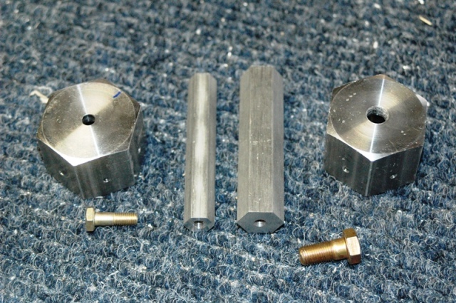

When we had the axle extension group buy I had opted out as the group got very large and I was thinking that we could put another group buy at a later date. These things have a way of sneaking up on you and I ended up working on this part earlier than I had anticipated. Being a bit early for another group buy I brute forced it and got another solution.
I replaced the original 1/2 inch diameter extension and AN4 bolt with a 3/4 inch diameter hex extension and AN6 bolt. I have attached a few pictures for those interested in trying the same modification.
I found the 3/4 inch hex extension at McMasterCarr in 12 inch lengths.
Niko

I am not sure why you are saying this John. An AN6 bolt, has a tensile strength of 10100lb where as an AN4 bolt has a tensile strength of 4000lb. Additionally the larger hex extension reduces the load on the bolt. I haven't done any analysis on this particular design so I can't tell you for sure if the original design was grossly undersized, however, being that not everyone is having problems I would think that Vans design is not that far off. And this design would have less than a third of the stress in the bolt that Vans design has. I guess time will tell.
One item that might be coming into play is the torque values. If one under torques a bolt its fatigue life may be reduced drastically. Thats because the bolt typically sees only a fraction of the applied load as the rest is going to relieve some of the preload in the joint. If the applied load is higher than the preload due to torque the joint will open up and drastically reduce the life of the bolt. Yes, this does mean the higher the torque the better up to the point where significant deformation of the threads occurs. Although this is just a guess it could very well be that the people having problems with Vans design at this location have not applied enough torque. I do realize that the bolt is being threaded into aluminum and one has to be more carefull
Thousands of cycles by themselves are not a problem. In fact even aluminum (2024) can take more than 100 million cycles if you keep the peak stress below 10 ksi.
Niko
40188

First let me state I am not trying to be a know it all or a smart ass. Nor
am I clairvoyant.
Think about how those rocks were moved to build the pyramids. Think about
how after a tornado or hurricane they find a plastic straw embedded in a
telephone pole. How about how a 110 pound Japanese Aikido practitioner can
bring down a 350 pound muscle man with the greatest of ease.
What the hell am I talking about?
Brute force, or as you state, the thickest of metal, not designed well, will
shatter. The problem is that you need to think of the hex extension as a
lever. The fulcrum point is the edge of the hex where it touches the flat
face of the axle adapter. The other lever arm is the distance between the
bolt and the outside edge of the hex extension(in other wards, the distance
between the fulcrum point back to the bolt.) Think of this also in 360
degrees(this is realy bad)
Now you will true your fairing as best you can so it flies cleanly through
the air, but these reciprocating engines, even the Eggenfellner, will cause
a vibration. Translate that vibration on to the wheel fairing and you will
get a harmonic cycle acting on that long lever arm(The hex extension). The
longer the hex extension the worse the problem. The more mass at the end of
that extension, the worse the problem. The more vibration, worse yet.
Millions of cycles possibly over a single flight. In my opinion, that bolt
doesn't stand a chance. No matter how you torque it.
Here is a little better way. Tim's design for one. After that, where the hex
extension meets the axle adapter, you need a female receptor lathed into the
axle adapter. It needs to have a Morse Taper. The Hex extension needs to
have a corresponding Male, Morse taper. The bolt, properly torqued will
transfer the load to the two tapers and relieve the lateral forces which the
bolt's shaft is subjected to. The bolt will now only serve to hold the two
pieces together. The machining needs to be really clean with no internal
blips or hangups, otherwise these will act as fulcrum points.
Niko
40188

Personally, I think that what Niko did is going to work great. The
old one had it's weaknesses, and any enlargement or improvement
will help a great deal and likely make it a non-issue. He's going
with a huge bolt, but not quite as much base on the stem, but
relative to what was kit-supplied, he's quite a bit better. The
hex bar may make it easier to rock in one specific direction,
whereas a rounded piece would be like having that width
throughout an infinite number of corners like on the hex. (hard
to explain that one...but I'm basically saying that he's only got
that huge OD on the corners, and it's lesser on the flats)
So, in the end, I don't see that it'll be a big problem if the
originals worked OK for some people for a while. It may
not be quite as strong, or maybe with the larger bolt he may
be as strong. Either way, he's well over what it originally
was so I sure wouldn't lose any sleep over it at this point.
I do agree with you though John, that the fulcrum point is not only
closer to the bolt, but with the flats it can be even more
close than at the hex corners. Is it a big deal? as long a
the piece has some huge-ness, it will help. On those that we
had made, I just went for the widest base, with a thin enough tip
so that it would easily retrofit and work for anyone....and taper
to save weight.

owl40188(at)yahoo.com
PostPosted: Thu Mar 15, 2007 2:26 pm    Post subject: Axle Extension - Brute Force Method Reply with quote
Well John, I don't think you are being a smart ass and you have not offended me in any way. I am just writing this for an informational point of view as I have gotten a lot of usefull information from this group and I am trying to give back a little.
There is a big difference between a "poor" design and margin of safety. A poor structural design simply means its inefficient in carrying loads it does not mean that it will fail. The RV10s, small Cessnas, and small Pipers are filled with design details which are considered "poor" because they are structurally inefficient but they have adequate margins of safety and they work. They are just heavy but they are simple cheap methods of doing a task and frankly I believe in most cases appropriate for the aircraft they are being used in.
The current axle extension design that Van's has is not a bad design its simply a bit undersized. It works in heel-toe action what you are calling a fulcrum. This is not a mystical design. The load on the bolt for a given configuration can be easily calculated and sized appropriately. By the way this same concept is being used to carry the horizontal stabilizer vertical load at the front spar location in the RV10. If you look at the joint closely you will notice that the two angle fittings will have heel toe action at the base. This by the way identical to design Piper uses on some of its aircraft and it works. I can only surmise that its one of the many details Vans has copied from someone else. Its not the lightest or most elegant solution but it gets the job done, its simple and its cheap. Another example is the use of 6061 aluminum which is considered very weak not typically not used in more advanced aircraft. the AN3 bolts we use are also not used in more advanced designs as they are at the low end of steels capability and there are much stronger bolts for the same weight.
In the design change I made I increased the diameter of the hex extension by 50% which inturn lowered the heel toe load by the same amount as the moment arm has increased. This results in about a 30% decrease in stress in the bolt. Increasing the diameter of the bolt increased the bolt area by 2.25 times and resulted in a corresponding decrease in the bolt stress. If you take these two changes together the operating stress in the new bolt is about 30% of Van's design (70% reduction in stress.) This is not a guess or heresay, this is the rough number using a simplistic analysis method. Since in general a 10% decrease in stess will double the fatigue life this should result in approximately 2000 fold increase in fatigue life. You can see this from a typical steel fatigue curve. See attached figure for 4130 steel which indicates much more than 3 orders of magnitude improvement in life for a 70% reduction in stress (red vs blue line.) In fact it appears that for 4130 we would be operating below its endurance limit so we would be approaching infinite life. What I haven't considered here is the preload in the bolt which also tilts the scale on the side of the larger bolt.
Lets conservatively say that these bolts fail in 50 hrs of flying, then a 2000 fold increase will give me a life of 100,000hrs using a scatter factor of 3 which is typicall for aircraft I would expect at least a 33000hr life which I believe is adequate. And there are aircraft flying with the original design with hundereds of hours with no failures. Truth of the matter is that this design is probably adequate with a 3/4" hex extension and only an AN5 bolt.
My conclusion is that the revised design is adequate. If someone doesn't think so that's okay too.
Niko

indigoonlatigo(at)msn.com
PostPosted: Fri Mar 16, 2007 6:02 am    Post subject: Axle Extension - Brute Force Method Reply with quote
Excellent and well thought out response. I agree with you on all the
mathmatical analysis, not that I did it or checked it. I still think it is
not a good design, regardless of how much beef you put into it.
I do not agree however that the fastening of the HS is the same meathod. The
design for the wheel faring is a single axis, like a flag pole.
The HS angle brackets, two total, each has two bolts for a total of four. In
addition, the forks that anchor the rear spar, if I recal correctly, has
another two bolts per fork for a total of four. So all said, there are eight
bolts, four working in both shear and tension on the main spar and four
working more in shear on the rear spar. I like to think of it like a four
legged stool with all the legs anchored to the ground. It is very stable
with little change that lateral loads will be able to impart any damage to
anyone of the eight bolts.
The wheel faring, I see it as a one legged stool anchored into the ground.
In this case, Rick, size matters, because that guy that kept agreeing to
Supersized orders at MCDonalds(Drives a Hummer and leaves his light on all
day long when no one is home) is gonna find himself on that ground with no
one to help him get up. Like a rollie polli bug that's stuck on its back.
If the faring attachment mechanis breaks and if the faring only drags on the
ground, no problem.
But is it tears off, gets sucked up under the tire and then thrown, damaging
the bottom of the plane, wing or break line than it is a problem. We worked
way too hard to make these planes look great and function well to suffer
that fate.
Get the name of Tim's contact and run another order. I would make you one if
I had the lathe.
Thanks for listening.
Niko
40188
