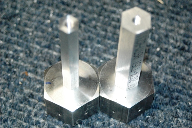

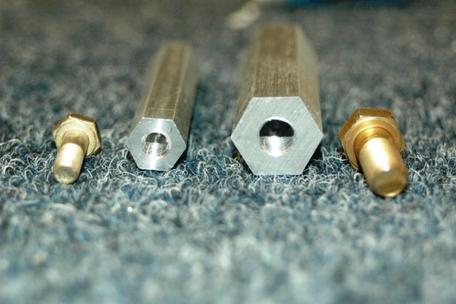

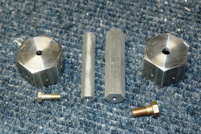

When we had the axle extension group buy I had opted out as the group got very large and I was thinking that we could put another group buy at a later date. These things have a way of sneaking up on you and I ended up working on this part earlier than I had anticipated. Being a bit early for another group buy I brute forced it and got another solution.
I replaced the original 1/2 inch diameter extension and AN4 bolt with a 3/4 inch diameter hex extension and AN6 bolt. I have attached a few pictures for those interested in trying the same modification.
I found the 3/4 inch hex extension at McMasterCarr in 12 inch lengths.
Niko
40188
Niko

Looks like a good option also. Thanks for the pics.

deformation of the threads occurs. Although this is just a guess it
could very well be that the people having problems with Vans design at
this location have not applied enough torque. I do realize that the
bolt is being threaded into aluminum and one has to be more carefull
Thousands of cycles by themselves are not a problem. In fact even
aluminum (2024) can take more than 100 million cycles if you keep the
peak stress below 10 ksi.
Niko
40188

Well John, I don't think you are being a smart ass and you have not offended me in any way. I am just writing this for an informational point of view as I have gotten a lot of usefull information from this group and I am trying to give back a little.
There is a big difference between a "poor" design and margin of safety. A poor structural design simply means its inefficient in carrying loads it does not mean that it will fail. The RV10s, small Cessnas, and small Pipers are filled with design details which are considered "poor" because they are structurally inefficient but they have adequate margins of safety and they work. They are just heavy but they are simple cheap methods of doing a task and frankly I believe in most cases appropriate for the aircraft they are being used in.
The current axle extension design that Van's has is not a bad design its simply a bit undersized. It works in heel-toe action what you are calling a fulcrum. This is not a mystical design. The load on the bolt for a given configuration can be easily calculated and sized appropriately. By the way this same concept is being used to carry the horizontal stabilizer vertical load at the front spar location in the RV10. If you look at the joint closely you will notice that the two angle fittings will have heel toe action at the base. This by the way identical to design Piper uses on some of its aircraft and it works. I can only surmise that its one of the many details Vans has copied from someone else. Its not the lightest or most elegant solution but it gets the job done, its simple and its cheap. Another example is the use of 6061 aluminum which is considered very weak not typically not used in more advanced aircraft. the AN3 bolts we use are also not used in more advanced designs as they are at the low end of steels capability and there are much stronger bolts for the same weight.
In the design change I made I increased the diameter of the hex extension by 50% which inturn lowered the heel toe load by the same amount as the moment arm has increased. This results in about a 30% decrease in stress in the bolt. Increasing the diameter of the bolt increased the bolt area by 2.25 times and resulted in a corresponding decrease in the bolt stress. If you take these two changes together the operating stress in the new bolt is about 30% of Van's design (70% reduction in stress.) This is not a guess or heresay, this is the rough number using a simplistic analysis method. Since in general a 10% decrease in stess will double the fatigue life this should result in approximately 2000 fold increase in fatigue life. You can see this from a typical steel fatigue curve. See attached figure for 4130 steel which indicates much more than 3 orders of magnitude improvement in life for a 70% reduction in stress (red vs blue line.) In fact it appears that for 4130 we would be operating below its endurance limit so we would be approaching infinite life. What I haven't considered here is the preload in the bolt which also tilts the scale on the side of the larger bolt.
Lets conservatively say that these bolts fail in 50 hrs of flying, then a 2000 fold increase will give me a life of 100,000hrs using a scatter factor of 3 which is typicall for aircraft I would expect at least a 33000hr life which I believe is adequate. And there are aircraft flying with the original design with hundereds of hours with no failures. Truth of the matter is that this design is probably adequate with a 3/4" hex extension and only an AN5 bolt.
My conclusion is that the revised design is adequate. If someone doesn't think so that's okay too.
Niko

[quote]From: Niko <owl40188(at)yahoo.com>
Reply-To: rv10-list(at)matronics.com
Subject: Re: Fw: Axle Extension - Brute Force Method
Date: Thu, 15 Mar 2007 15:26:25 -0700 (PDT)
Niko
40188
