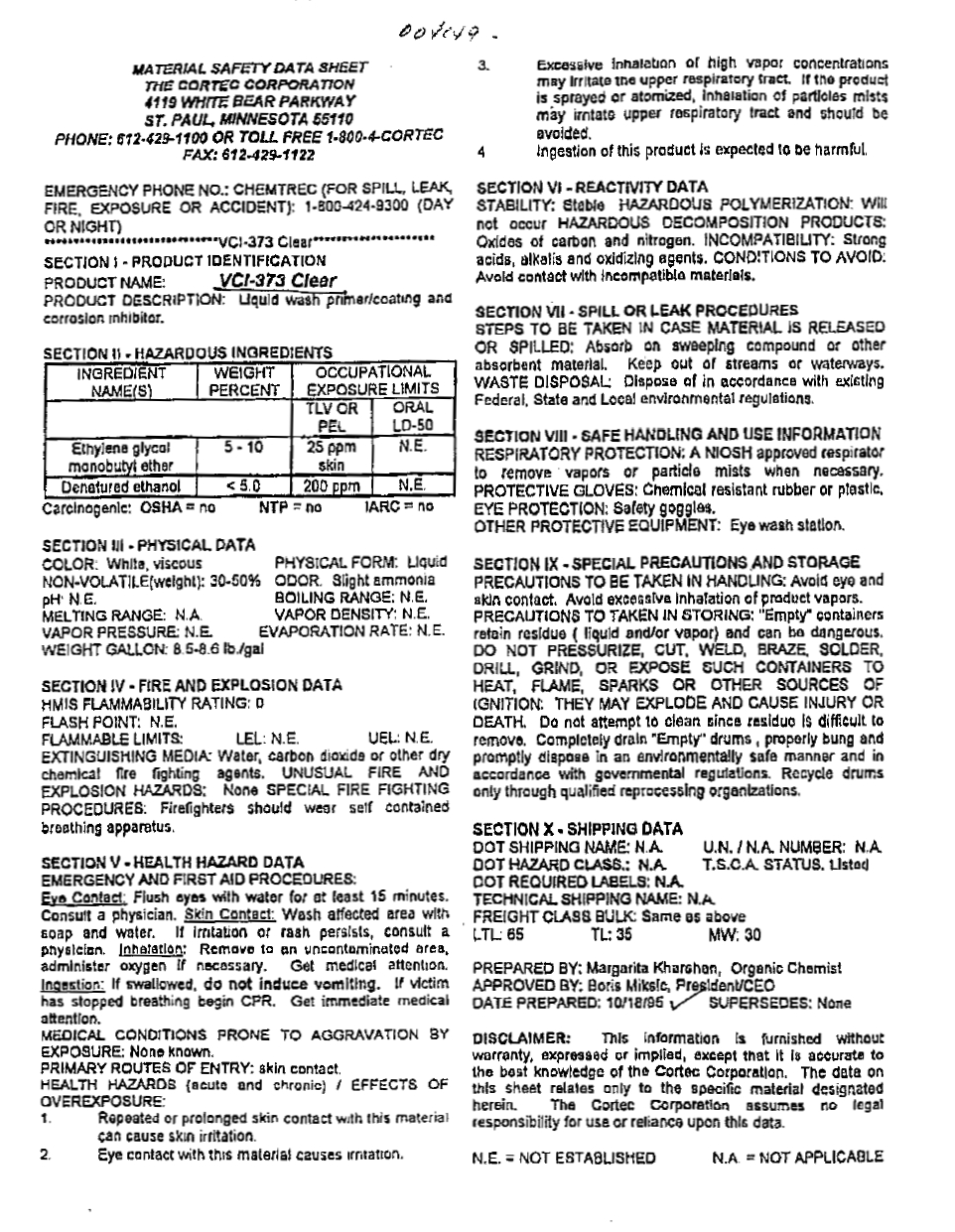

PostPosted: Mon Mar 19, 2007 11:48 am    Post subject: Cortec Safety Concerns Reply with quote
 Filesize:  648.58 KB
 Viewed:  525 Time(s)

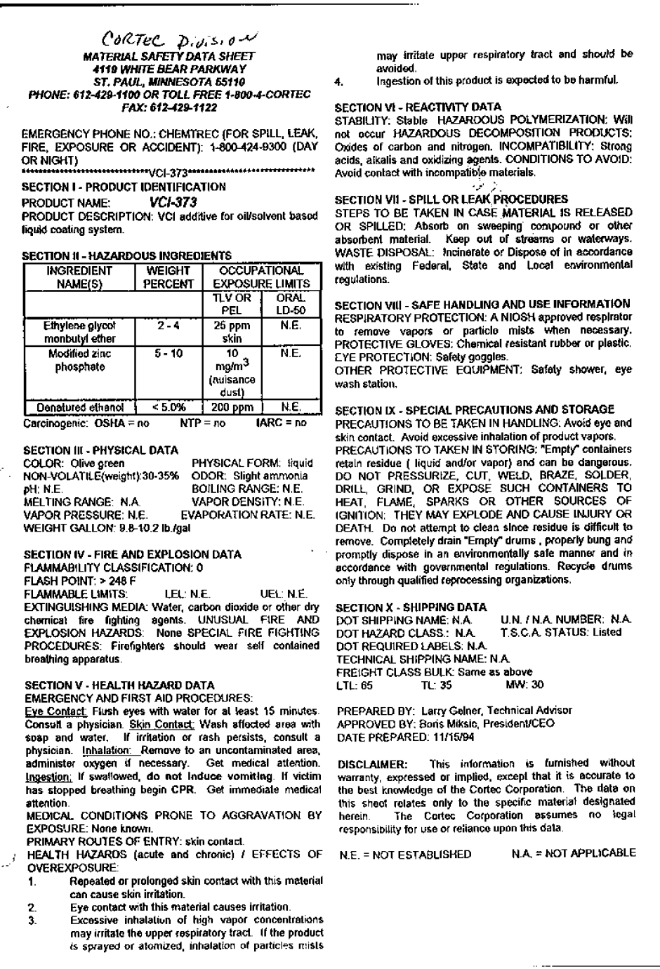

planecrazydld(at)yahoo.co

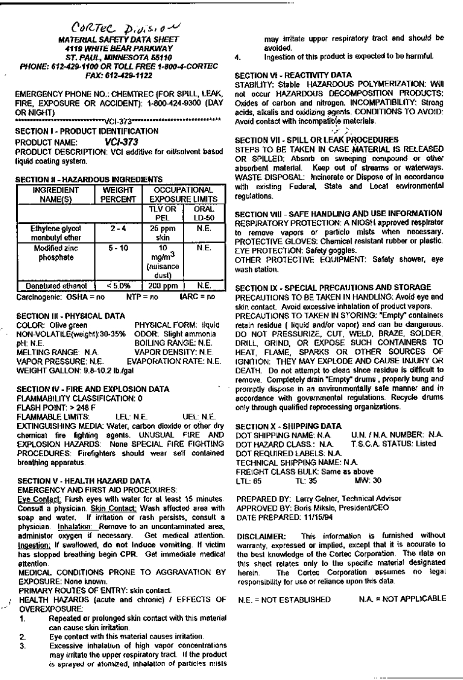

[url=http://us.f362.mail.yahoo.com/ym/ShowLetter?box=Sent&MsgId=3224_7178189_421313_715_1450582_0_41582_1890235_1871791607&bodyPart &tnef=&YY=98913&y5beta=yes&y5beta=yes&order=down&sort=date&pos=0&view=a&head=b&VScan=1&Idx=0][/url]This is what I found in our system. I do not know if it is the same VCI-373 that they shipped me... I also am awaiting approval for access to the MSDS's at the Cortec site.

 Filesize:  710.11 KB
 Viewed:  465 Time(s)
