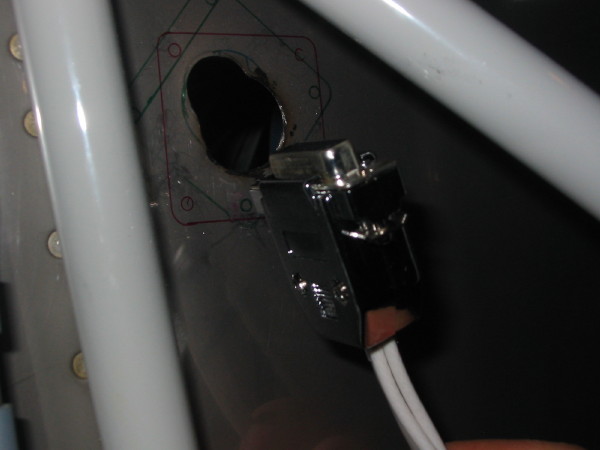

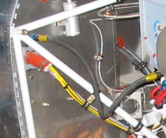

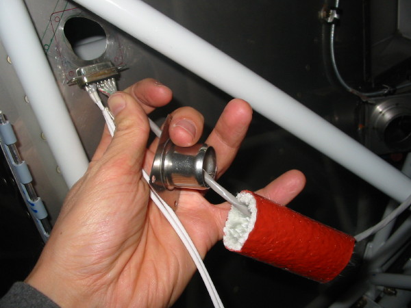

I used 1" stainless steel firewall penetration seals. I only had to file the hole slightly larger than I was originally planning to allow the connector to pass through. Pictures attached.
-Jim

Tim Olson
Joined: 25 Jan 2007
Posts: 2882
PostPosted: Sun Mar 25, 2007 7:01 am    Post subject: Lightspeed Ignition Reply with quote
Very nice Jim, you should name your supplier.

PostPosted: Sun Mar 25, 2007 11:11 am    Post subject: Lightspeed Ignition Reply with quote
I purchased the SS penetration seals and SS heater control valves from:
http://www.epm-avcorp.com/tubeseal.html
