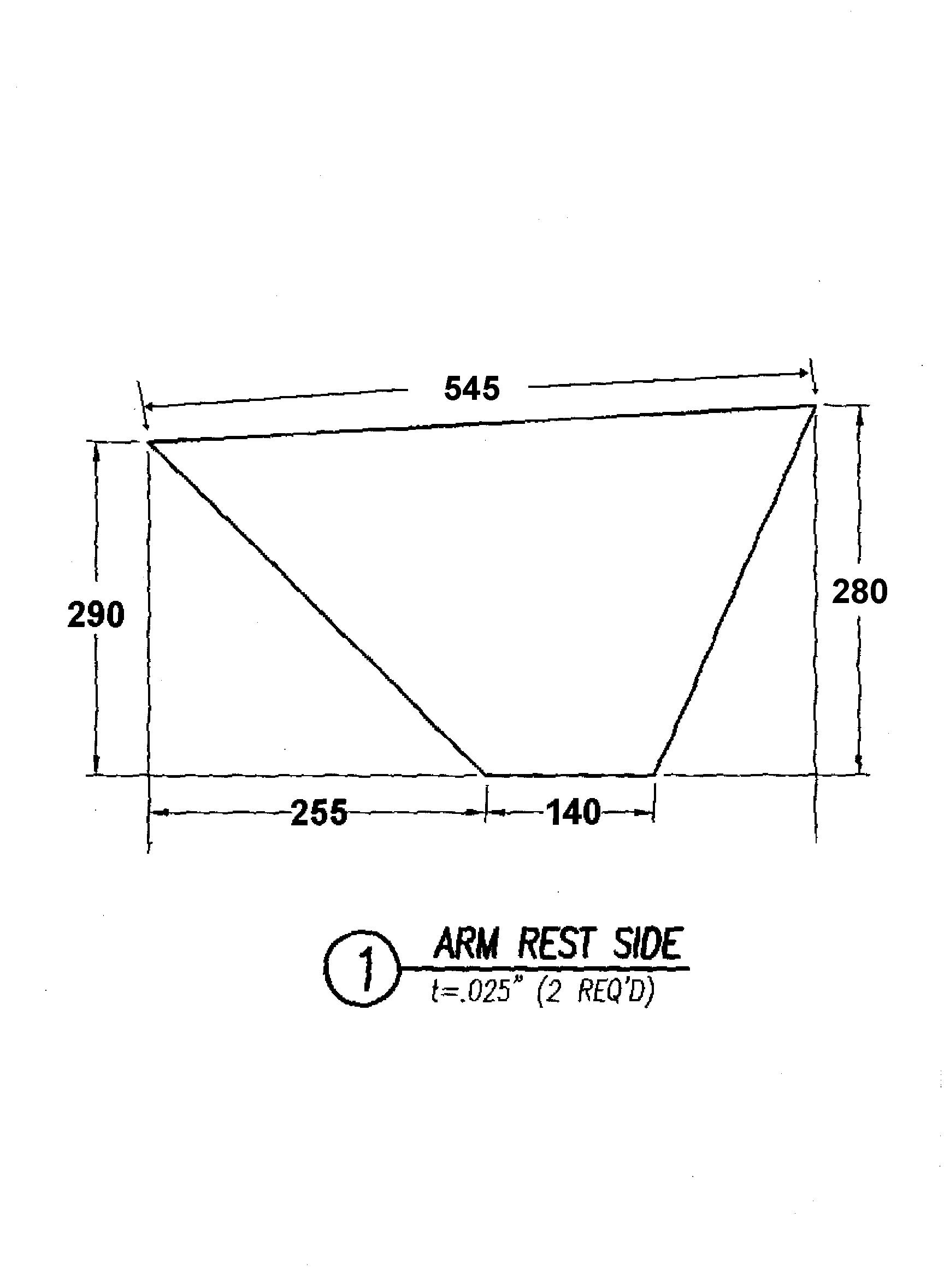

All-
Workable sketch attached. You probably won't wind up with numbers rounded off to 5mm if you lay it out in CAD, but this is close enough to get a good fit with a little touch up with a sander.
With 20/20 hindsight, I should have taken a "Before" picture of the fit. The difference is dramatic. I don't think moving the rear member forward 10mm would have helped.
