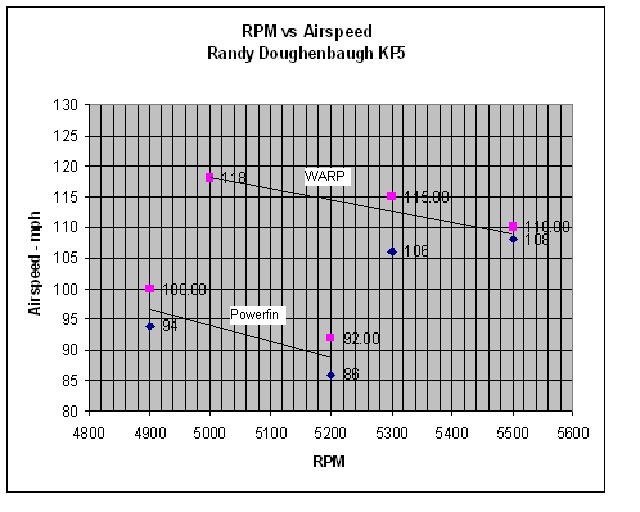

Hi Randy -
I'm building an early 5 and it looks like you've done what I'm trying to get to. Great job on keeping the weight down! Being an engineer, I really appreciate the data and hope that you don't mind my plotting it. That really IS a huge difference between props!
Bob
