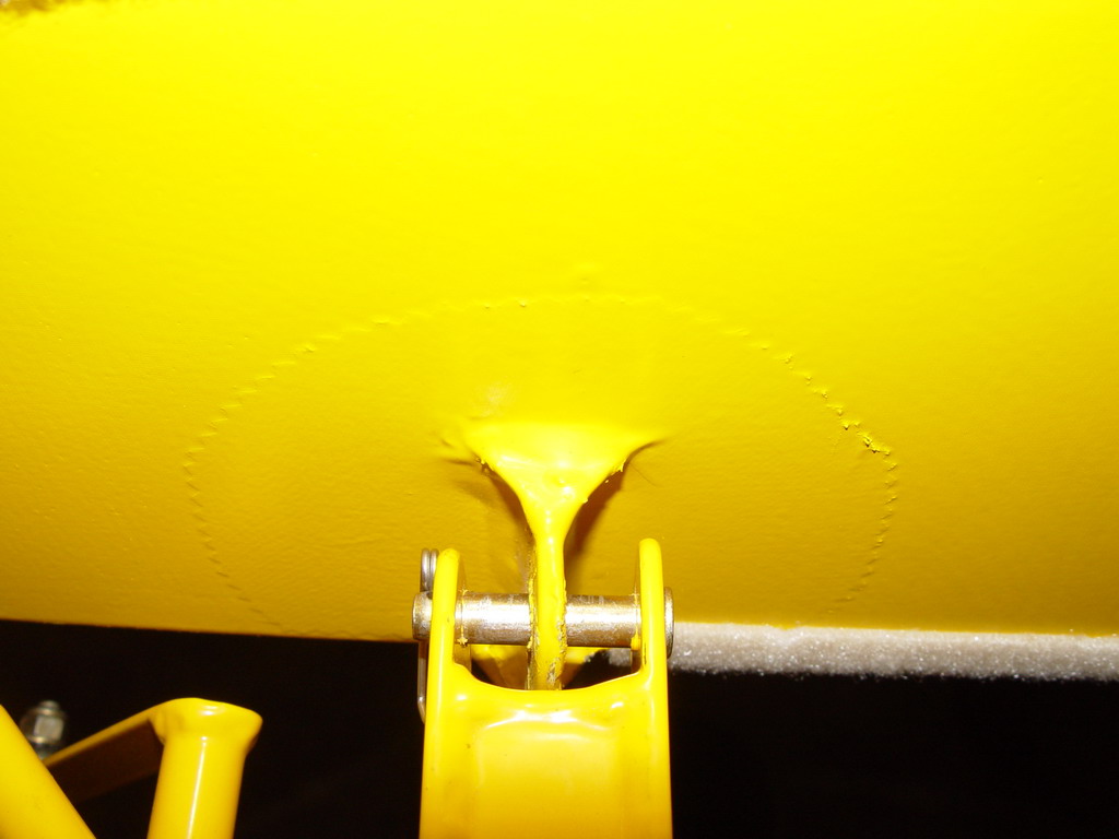

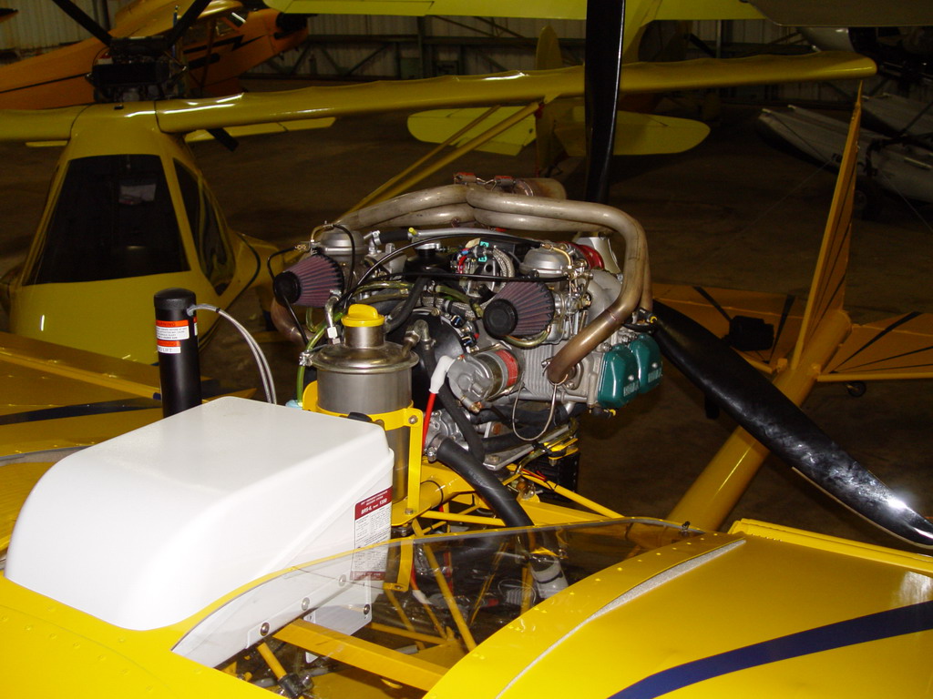

My BRS is in the center between the wings, as you can see in the attached picture. It does make me wonder if it would deploy after a wing fialure. The structure looks very strong overall, but the pin that attaches the wing to the center section has always made me wonder. I have calculated the forces and they are well below the shear level of the pin, but shear forces listed for AN hardware do not take into account this large 1 inch spread with the wing load in the center of the pin which creates more of a bending force, not a shear force on the pin... I have been tempted to drill the holes out, and go with one size larger pin, but removing material from the tongues could create its own weakness in negative G loads....
Mike

I had exactly the same thought and concern, so made spacers out of scrap tubing to hold the strut against one side of that 1" spread. Prob'ly makes no difference, but I feel better. Lar.
