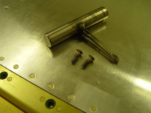

Here is what I learned:
A custom made T-handle screw driver made removal a breeze (photo
attached). With this driver, leverage can easily be applied as needed.
I now have no worries about assembly or disassembly or slightly bunged
up screw heads. This driver makes all conditions easy to handle. Much
better than a brand new Craftsman phillips head driver with a standard
handle.
A little smear of valve lapping compound on the tip increases the grip
significantly
There are various types of screw removal tools that can be applied to
damage screw heads. After trying several types, I had the best
experience with a Sears Craftsman "Drill-out " Micro Power Extractor
Kit - Model 52157. It is a set 7 double ended power driver tips. One
end has a cutter to drill a hole in the head, the other an extractor to
insert into the hole and drive the screw out. Good directions were
included and it worked exactly as described. Smaller sets are available.
Patience is key but the right tools make it very easy to manage.
Thanks all for the help.
