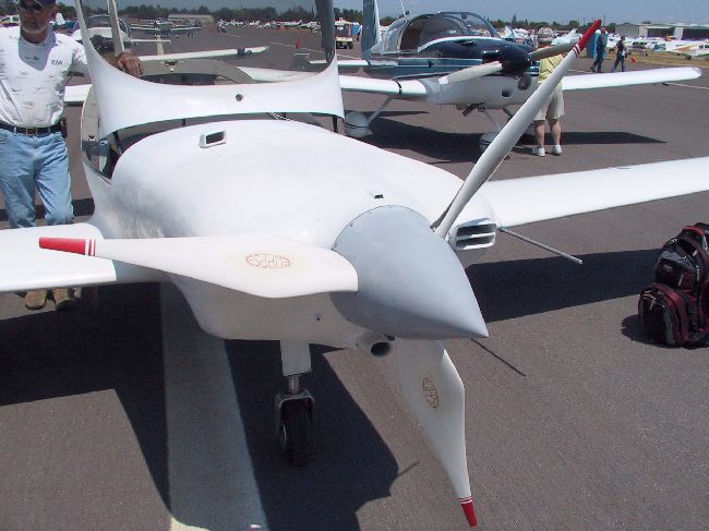

Hey Jeff - I am using a Catto fixed pitch 3 blade, 64 x 62 on my 125 hp EA81 powered
mono. Here is an 8 page Vans Air Force forum thread that is discussing the Catto vs other
fixed pitch AND constant speed units. The general consensus is that the Catto fixed
pitch is just as good on the RV as a Hartzell C/S unit and 20 lbs lighter for thousands less.
I'm sure Craig would build a 912 or 914 optimized prop if a few people got interested.
http://www.vansairforce.com/community/showthread.php?t=12964&page=1&pp=10
There is a new design by Paul Lipps that Catto is also producing, pic below. This
should be the direction of future prop design. An article by Paul Lipps on his prop
design is here:
http://www.batterson.net/EAA499/Issue77_8-13.pdf
This ones pricey for a fixed pitch because of the laminar flow prop airfoil is much
harder to carve at $3200 US. Plan on a long wait - up to a year.
I am ordering a Lipps design prop. I hope to use the exact same profile as Lipps
uses on his 0-235 powered Lancair as hp and prop rpm are the same.

Regarding Craig Catto's props, in my email exchanges with him, Craig
has been very leery of the Rotax hub due to the forces his 3 bladed
wood props generate; he much prefers, at a minimum, a SAE 1 hub/bolt
circle for adequate bearing.

Now isn't that a coincidence! Craig also makes one of the favourite EZ
propellers, (3 blade). The other EZ favourite is Gary Hertzler's 2
blade "Silver Bullet" AFAIK both these guys use computer optimisation.
BTW waiting list for either is quite long. Market opportunity for
someone. Wish I was a bit younger!
Graham
